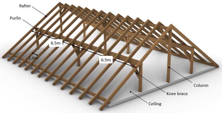

The biggest 2x6 span in my flat is around 4m but the area I'm planning on boarding out is around the unused cold water tank for the building (500-800L at a guess). I assume the joists around there are going to be the strongest. The majority of the span's in that area are around 2m as there is a wall in the centre but I would need to double check.
My roof is similar to the picture, with a collar tie between the purlins and minus the centre column (water tank is left of centre and the joists are parallel to the purlins). I would be planning to board ~50% of the area between the purlins only.

Assuming you joists are about 400 centers you should be fine with a span of 2-3m but I would avoid the 4m span.
Also I'm not a fan of the legs I would rather counter batten with something like 38mm x 195mm but this will add quite a bit of weight and I know this command is something nobody likes on a forum but you should consult a structural engineer.

There's been many a portly builder up there and there doesn't seem to be any cracks forming, apart from the usual age related cornicing ones. The 4m spans don't feel bouncy either when I walk on them, so the 2-3m spans should be good enough for storage. Heavy stuff can go inside the old cold water tank, light stuff can go on the boarded out area.
If I was attempting to make the space habitable, then I'd be getting a structural engineer but I'm unlikely to get planning permission for that.
