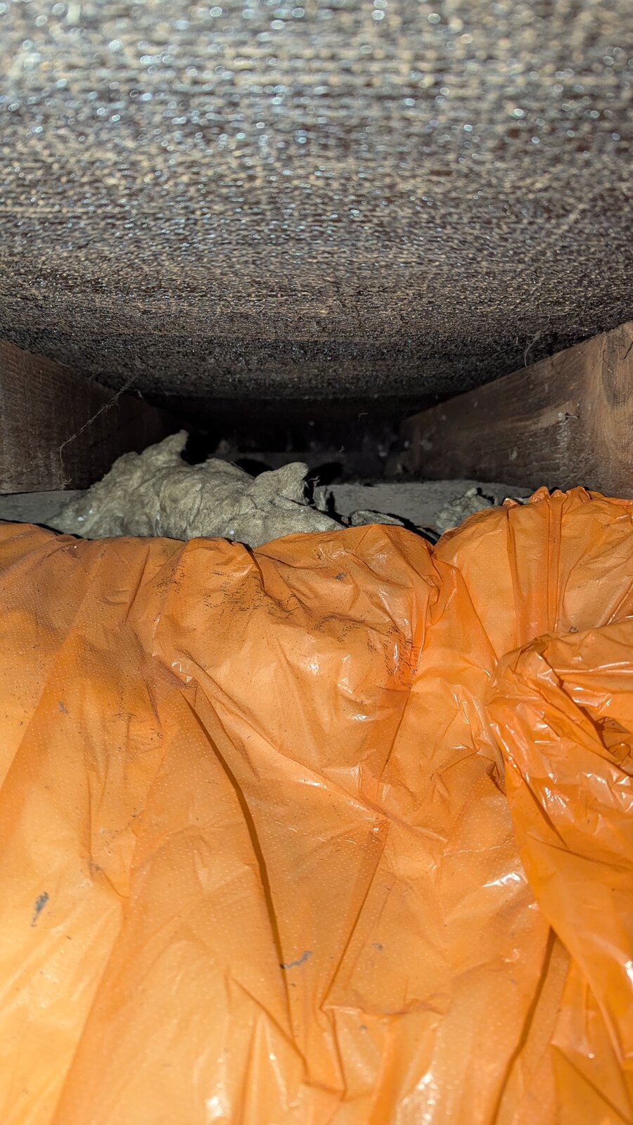

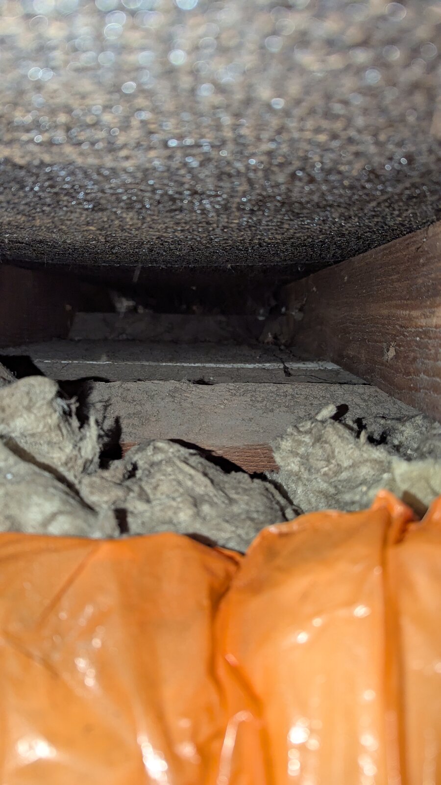

Should there be insulation "under the sloping section at the end". I don't know how to describe this properly but here are couple of pictures if it helps explain what I am trying to explain. Orange plastic on the picture shows current insulation in the floor of loft.
Normally board on inside 500mm up to stop insulation blocking off air flow.
You need vents in soffit to get the air blowing through
I can't make head nor tail of those pictures - but the insulation lies on top of your ceiling, the void above that should be well ventilated so no point insulating it
Could you add some labels to say what the surfaces are?
Is the dark grey board with a light grey top the soffit?

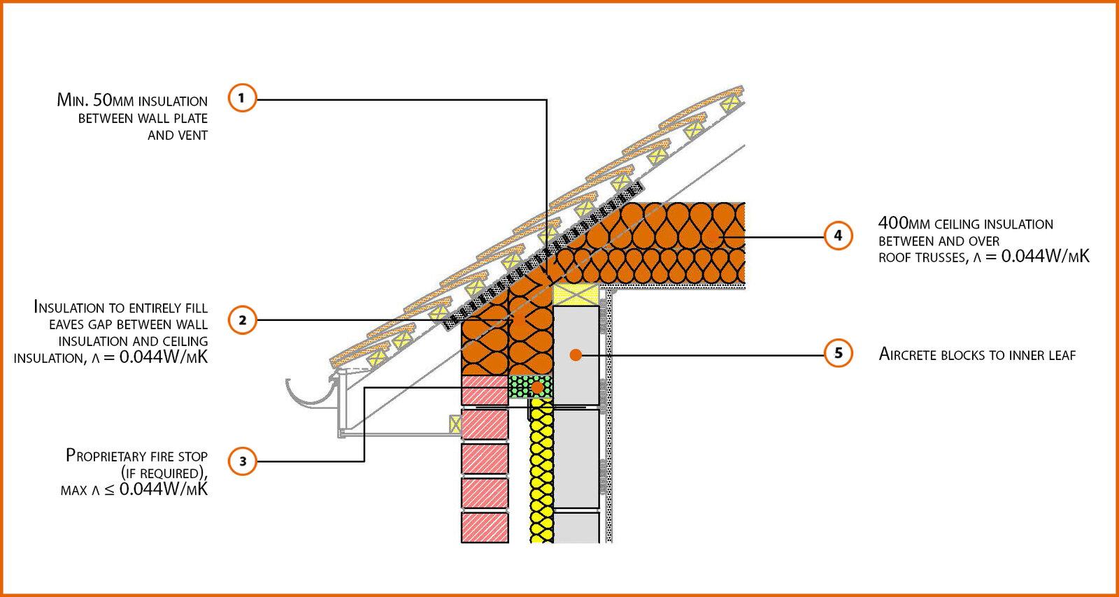

The loft insulation should meet the cavity wall insulation, to form a complete wrap around the house. It shouldn't overlap the outer wall, and there should be space to allow the air to circulate under the roof.
The insulation on the floor of your loft should be contiguous with the insulation in your cavity wall, otherwise you end up with a cold spot in the top edges of rooms where external walls meet ceiling boards, and that's where condensation and mold starts
Here is an explanation of the concept; it doesn't have to be implemented exactly like this, but this is a reasonable detail. See how the wall insulation and the ceiling insulation are continuous. You have to arrange it so that the ventilation to the loft space is not blocked by stuffing wool into the corner where it changes direction. There is no rafter drawn here because that would obscure the point being made; this is what you see if you slice your house in half between two adjacent rafters. The black thing is a device to ensure ventilation to the loft space is maintained
Not saying they do. I'm saying that ventilation must be maintained i.e. create something that achieves it
Thanks for your replies. I know photos were not adeaquate but it was the best I could do. The sketch shown by Robinbanks has helped me understand the ideal situation.
House doesn't have eves vent tray so I need to be careful as mentioned above. I can't see how or if the loft nsulation is upto cavity wall insulation so may just leave it as is and accept cold rooms especially in corner. Thanks.

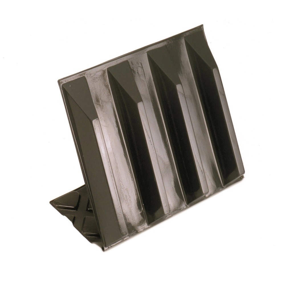

You could however, push refurbishment trays into the eaves, and fill behind with insulation, without blocking ventilation.
Example here...
