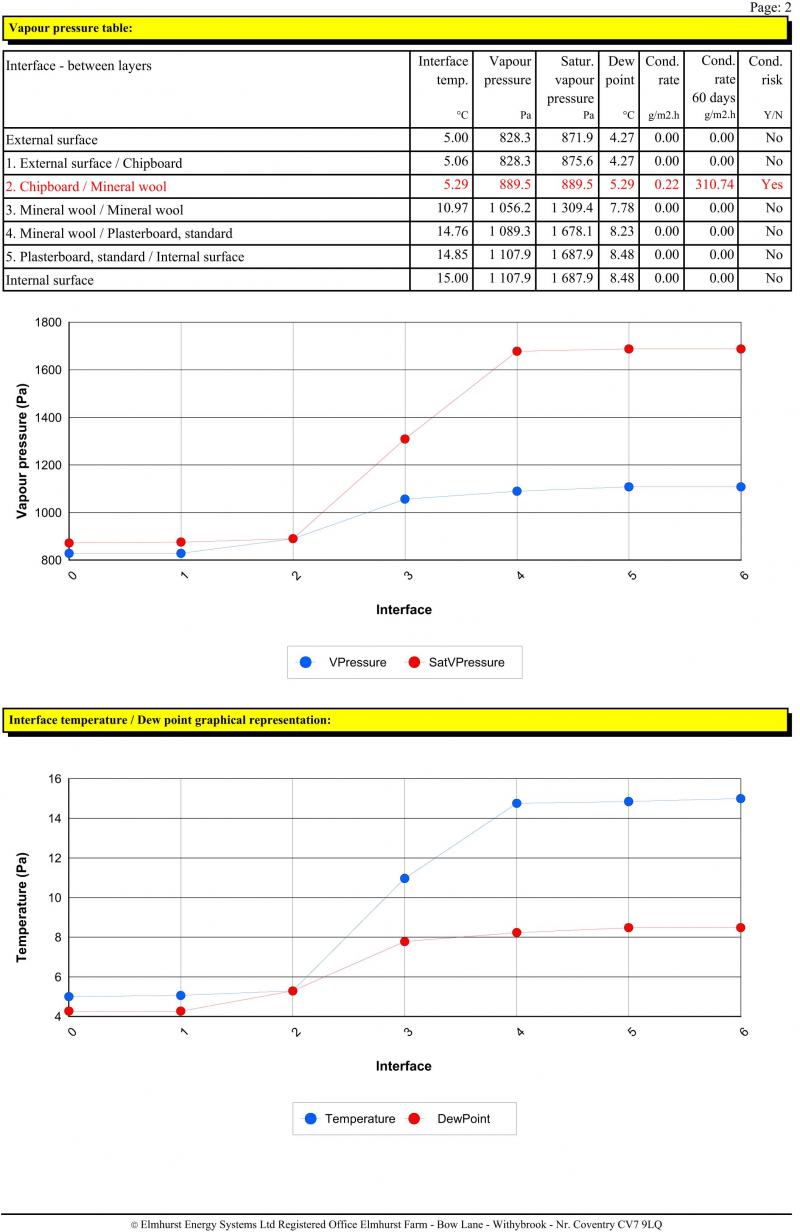

What I do know for sure is that if you run a condensation risk analysis on a boarded loft with enclosed insulation it will definitely fail.
A fairly sweeping statement, but i can not disagree none the less. How is the risk analysis carried out?

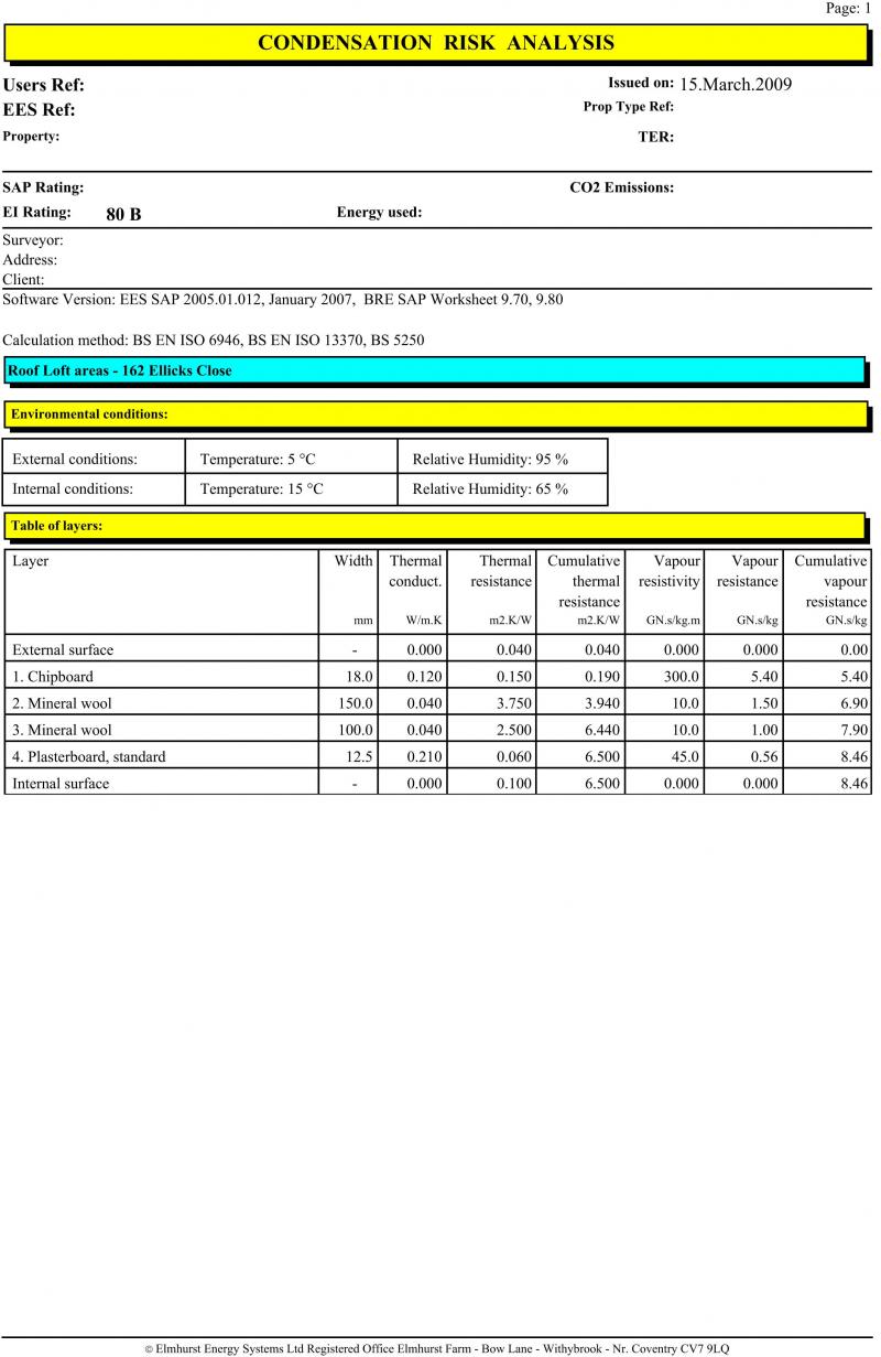

Condensation risk analysis is a part of any SAP calculation - required for all new build projects. There are several software progs available - I use Elmhurst myself.
I opened a previous loft calc and added a ceiling board to see what happens. It failed.
Very impressive stuff, so are you saying that if I use 100mm incapsulated fiber insulation in my 100mm depth joists and cover it with boarding I will get Condensation.
...on paper.
Is there no physical/practical test then? Does the test take into consideration vapour barriers or lifestyle or amount of occupants?
As previously mentioned, there are other factors involved and condensation will sometimes occur and other times not. My advice is leave some boards unfixed and lift them occasionally to see if a problem develops. It's not ideal but preferable to having just a 50mm layer of insulation
Noseall, the calculation is based on standard parameters, which is why you are right in saying some people will get condensation and others not. In reality few of us actually fit those standard round holes. A vapour barrier would also make a difference but that's obviously only practical for new build.
Remember, I didn't say the calculation was gospel. I originally said that the situation of enclosed mineral wool insulation against an unvented cold surface (the underside of the chipboard) is likely to cause condensation. That's not a guess or a sweeping statement out of the blue - it's an opinion based on some knowledge of construction technology and environmental science. I then said that a standard risk analysis would definitely show that condensation will occur - which it does.
