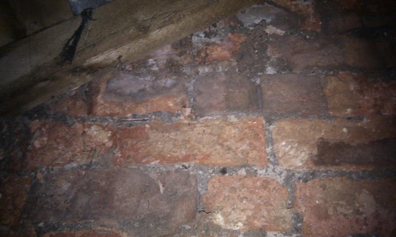

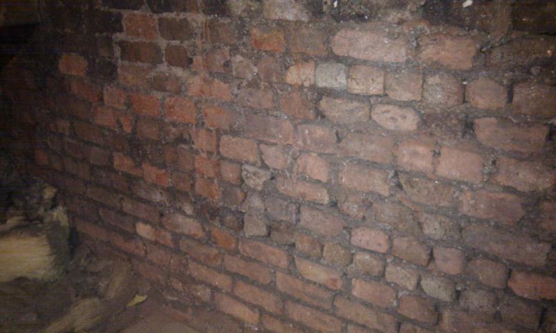

Now that I can access the loft, I was shocked to find a slight leak at eaither end of the roof (mid terrace) where it meets the wall to the next property.

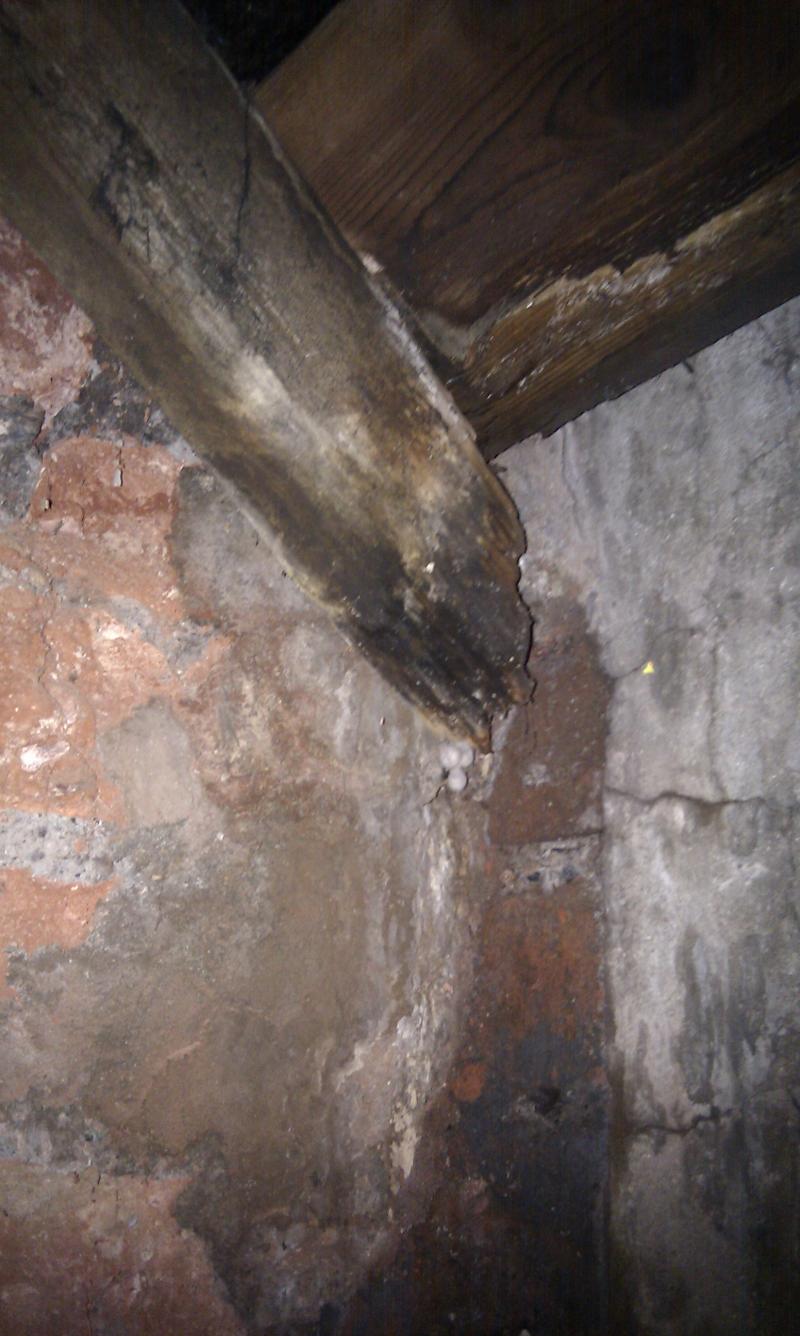

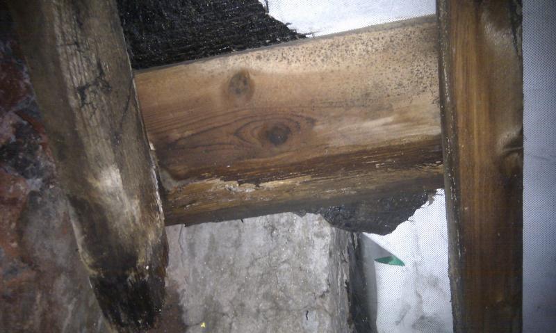

Even more worrying is that one of the short beams is now very rotten, having obviously beene exposed to this small leak for at least 1 year (probably more).

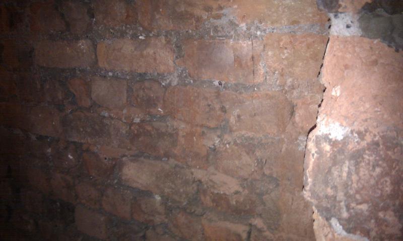

The brickwork at either side is not in a good state. The stuff nearest to the floor of the loft is fine, but as you get closer to the roof, the bricks are crumbling on touch. It seems to go about 1/2 inch into each brick, as once this crumbling is removed, the rest of the brick is solid to touch.

The roof appears to have moved maybe 2cm in the area where the beam has rotted.
Good news (I think) is that all the other beams away from the walls are solid and no leaks.

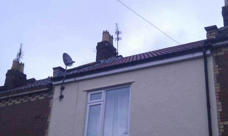

It looks to me like the broken beam may be part of the problem, but maybe that the seal around the edge of the tiles (flashing?) is not done correctly?
thick heavy concrete very thick heavy wavy concrete or relatively light slate :D
One of the last 2, will have to have a look tonight and let you know. Pretty sure its the wavy tiles kind
Uploaded some pics.
First is the roof from outside so you can see type of tiles and the lead thingy (flshing?)
Then are a series of pics to show the brickwork in the attic and the damaged beam.
Any advice on repairing the brickwork etc much appreciated.
The leak is miimal and seems to have only affected the wood with tiny drips onto the insulation below.
