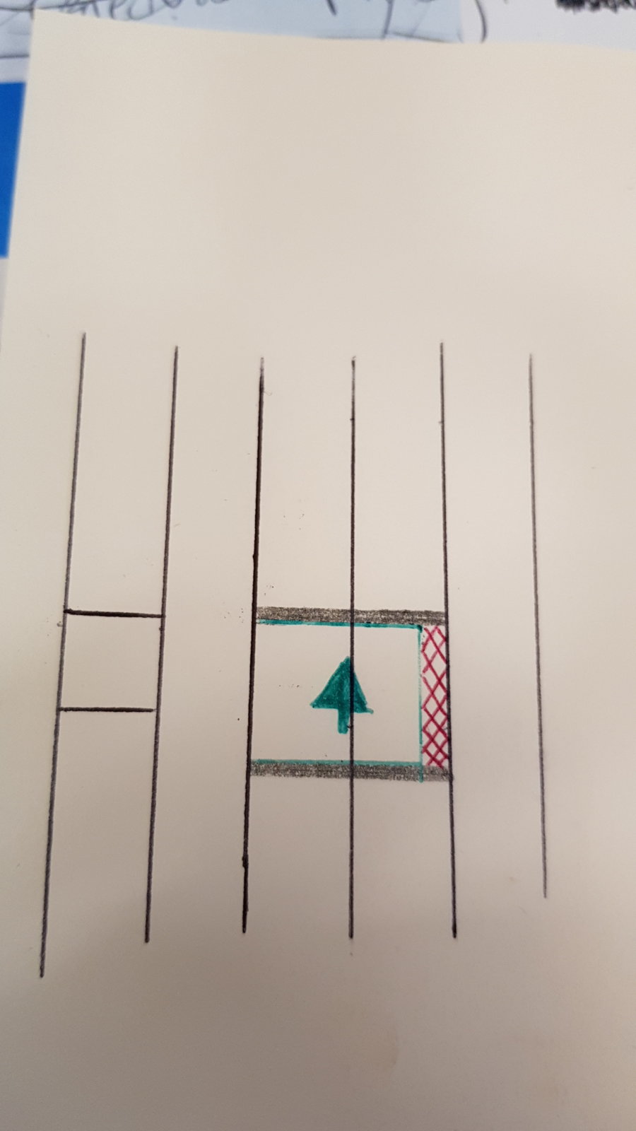

I've recently moved in to a new (old) house. The loft entry is too small, not well placed and there are no drop-down ladders. I want to make a new opening in a bedroom and install a kit - such as this one:
http://www.diy.com/departments/3-se...ft-ladder/1454517_BQ.prd?icamp=recs&rrec=true
the current entry only spans between two joists, however the new kit will be wider, spanning between 3 joists. The universe rarely aligns for me and having checked, the kit will not be wide enough to fit between the outside joists and will leave a gap. I know I'll be able to affix one side of the kit to the left joist, and the noggins will handle the top and bottom, but what do I do about the other long side? I'm assuming more noggins or braces of some design - can anyone provide me with instructions or a diagram on how I can effectively shore this up?
Here's a quick sketch I've made of my loft situation, obviously not to scale -
Should I just install another noggin, the length of the hole and install this parallel to the right hand joist, but screw this into the original noggins?
briefly, the method I plan to use is:
first brace across the 3 joists with a couple of (temporary) lengths of wood - screwed down
then installing a noggin at each end of the proposed new hole - screwed in horizontally to make fast.
Cut the middle joist.
Cut the hole in the plasterboard.
Attach the surround of the box to the remaining joist.
Any help appreciated,
cheers,
Grim.
