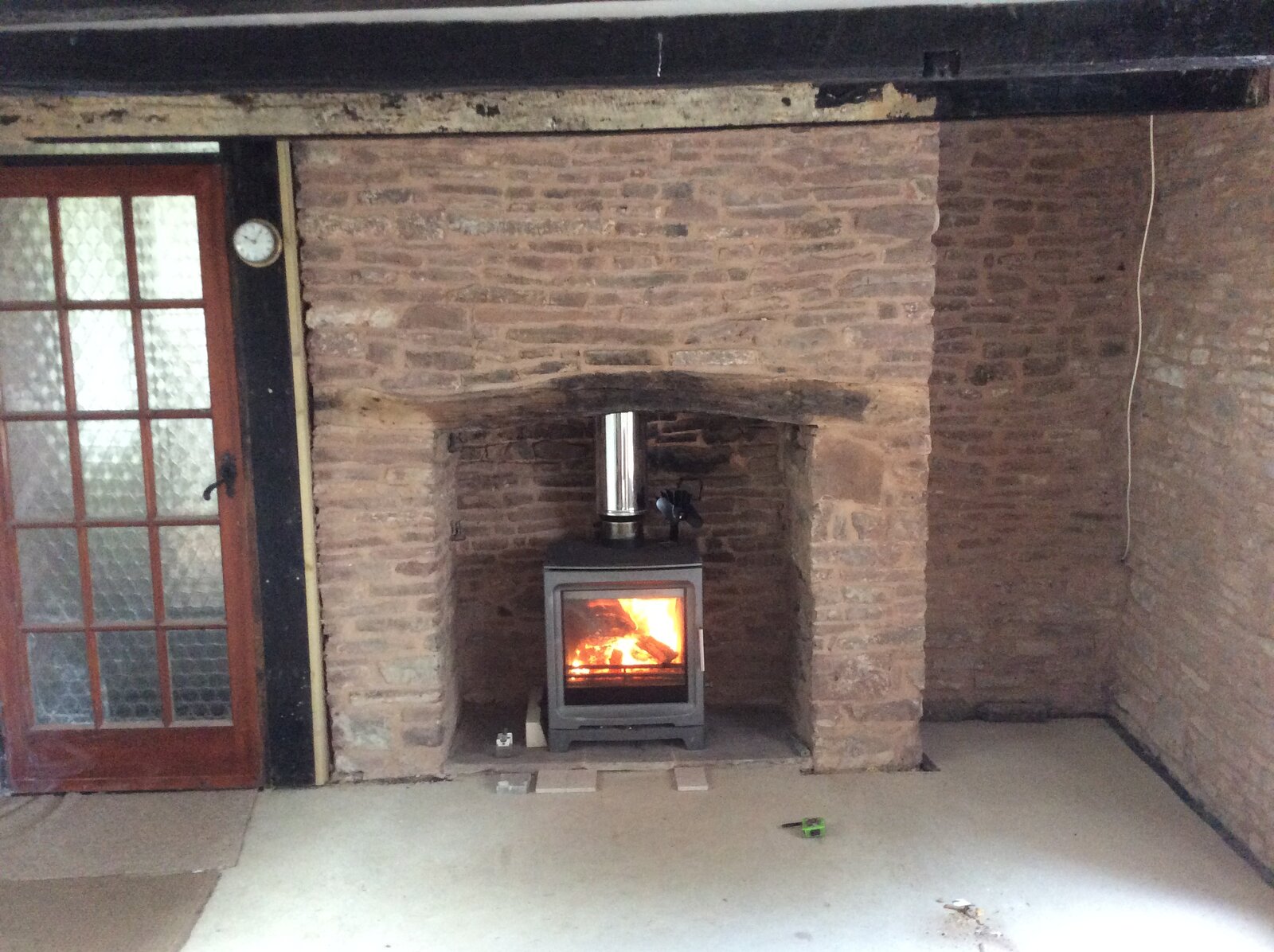

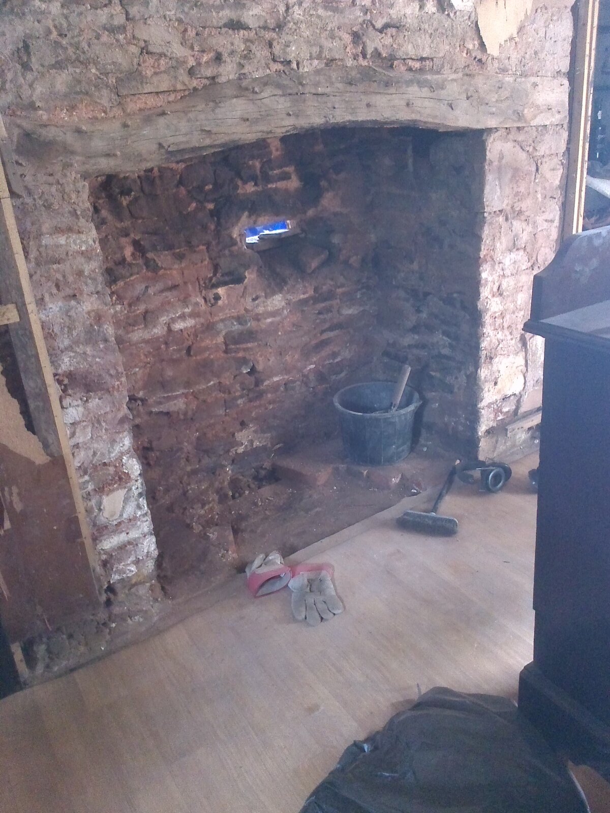

The appature is stone it's just the wall to the front that is battened and boarded. I plan to strip the board and batten back and then step it in giving a good margin around the fireplace. I am hoping to clean up the stone work underneath the plaster board, otherwise I will have to tidy it up possibly with the cement boards.
My wall was pretty rough but pointed up ok if you like it in keeping with rest of the room
