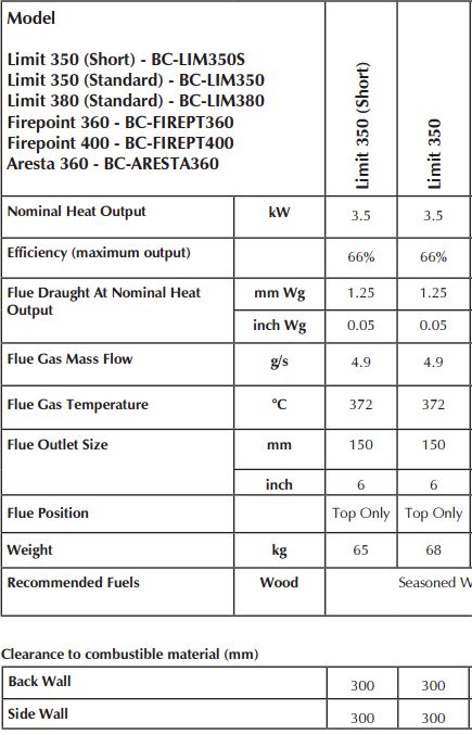

Just need to pick the brains of the masses.
I have a Bosca Limit 350 log burner which I am installing in a garden office I am building at the moment.
The construction is mainly timber with a rosemary tiled roof.
I have sourced locally some 12mm slate tiles (approx 30 x 60cm) and plan making both the hearth and two wall covering with them (the burner will sit in the corner) .
The specs (see below) state that there should be a 300mm gap to combustible surfaces. With the hearth and surrounds being 12mm slate, would I still need to stick to 300mm or could I go to 150mm (or less) without issues?
Cheers
Jonathan
