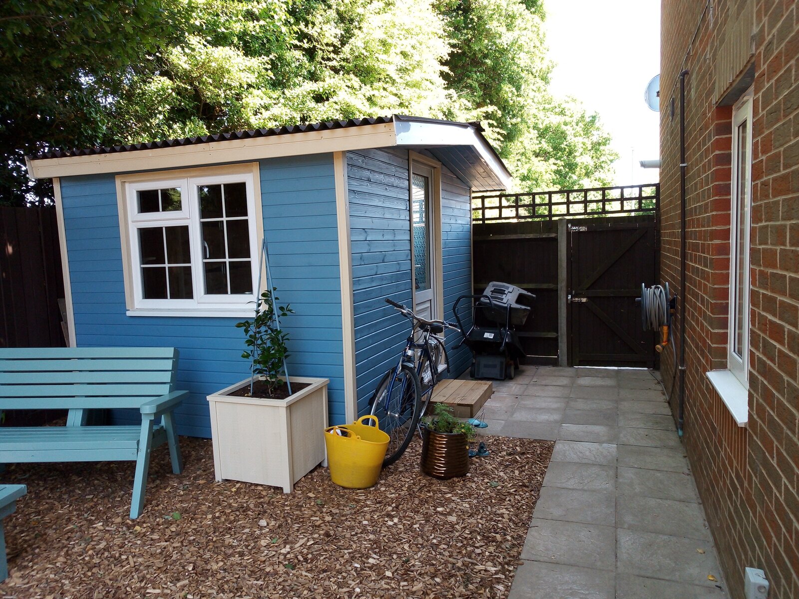

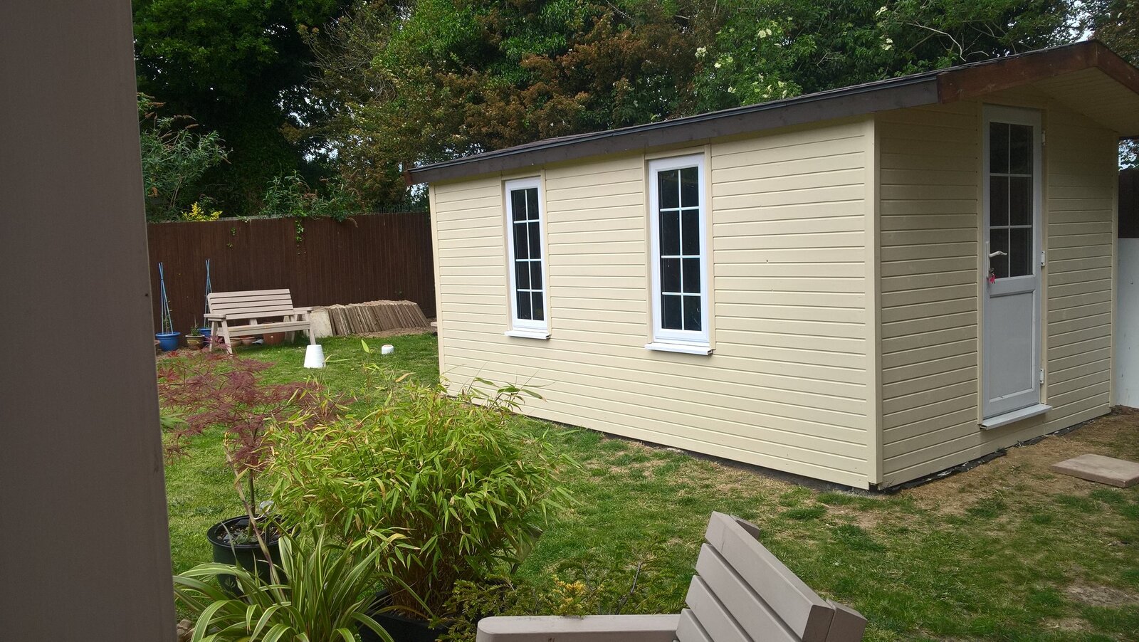

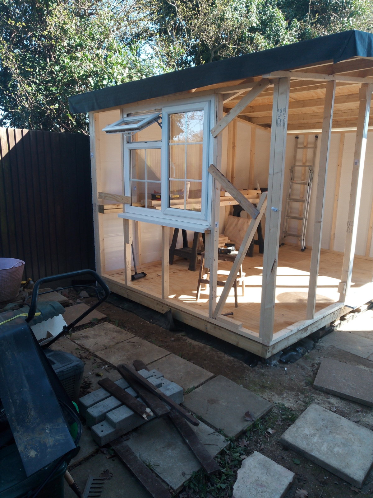

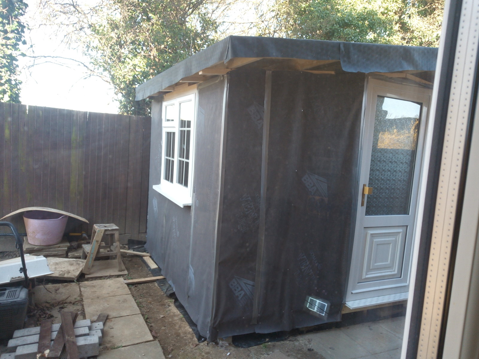

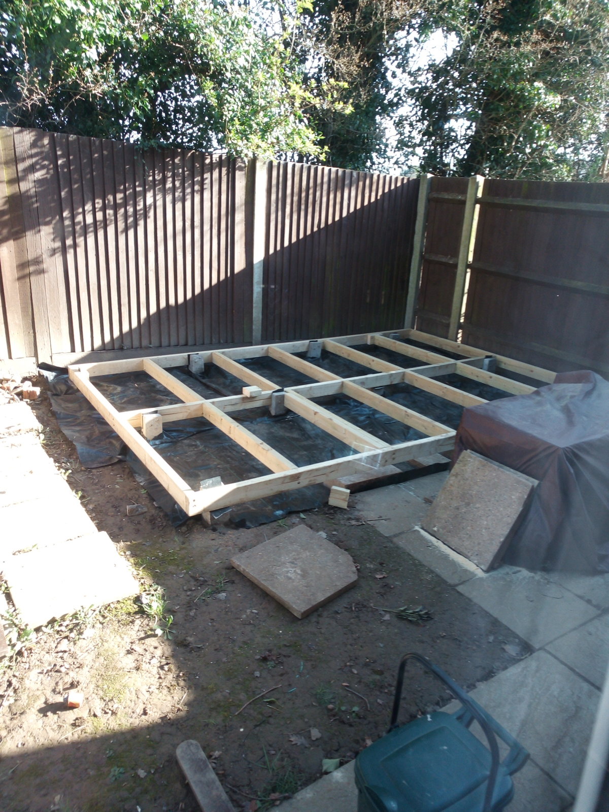

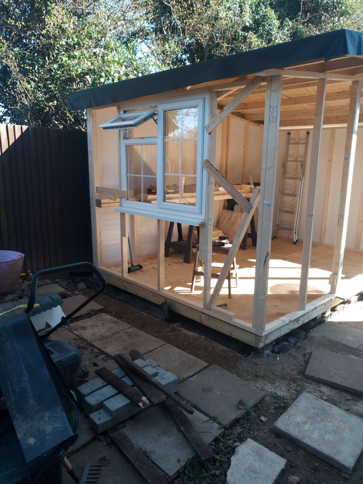

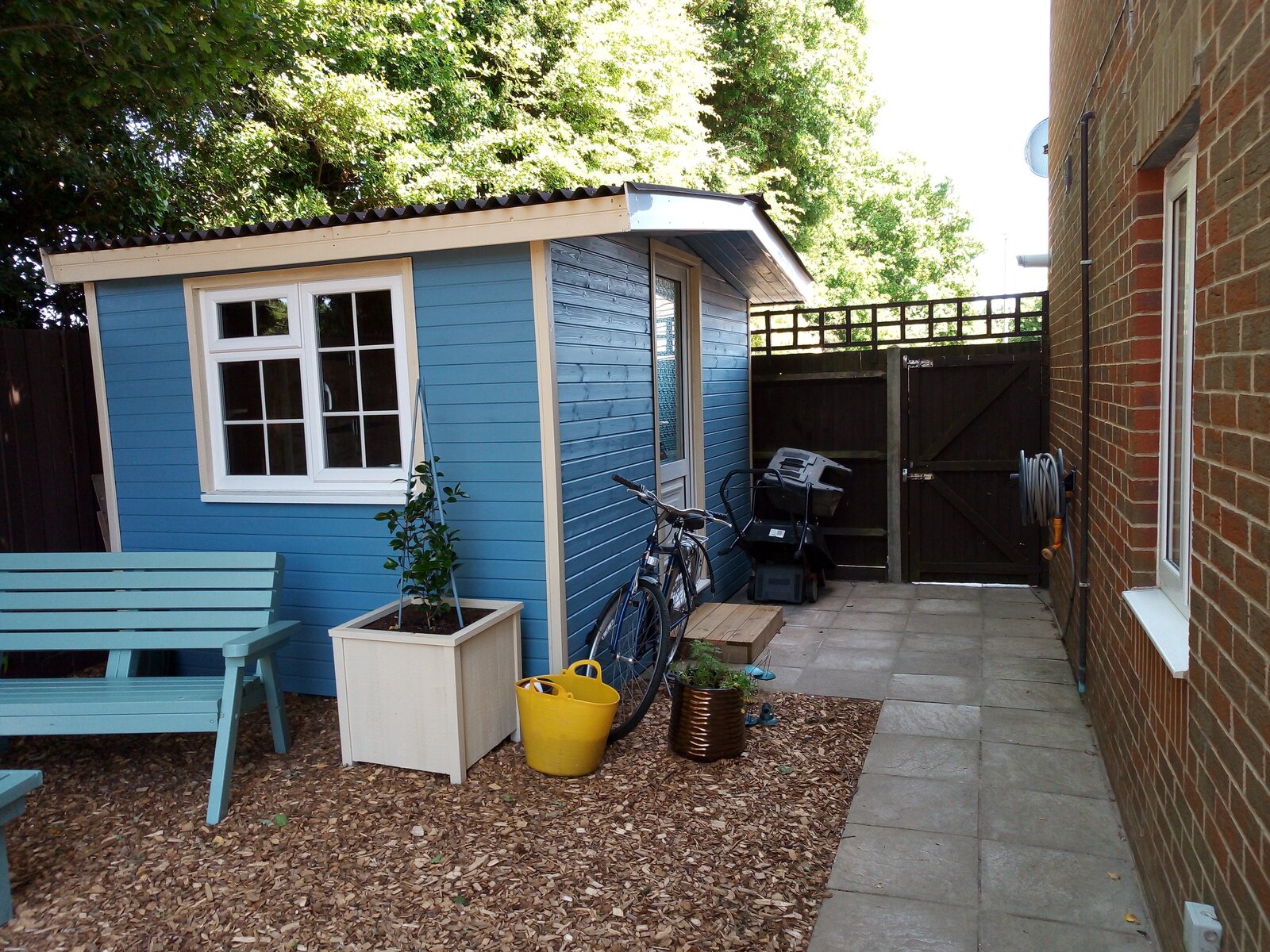

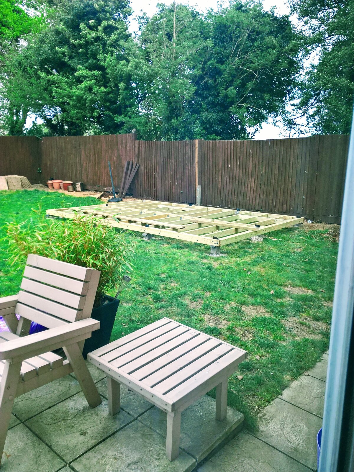

Hiya I'm in the process of building a small workshop, 3.6m x 2.5m I've used the concrete dek posts the a 4x2 timber frame separated from the concrete posts by dpm, I've then built the frame on top so it's as you would need a floating base, the concrete dek posts come in different lengths I've used 600mm, although I doubt that you will get any at the moment, if you need any more info and I'm glad to help, cheers Paul
Because it's a log cabin you need the raised type of base that I've built, this supports the ring beams then the floor fits inside,
Hiya I'm in the process of building a small workshop, 3.6m x 2.5m I've used the concrete dek posts the a 4x2 timber frame separated from the concrete posts by dpm, I've then built the frame on top so it's as you would need a floating base, the concrete dek posts come in different lengths I've used 600mm, although I doubt that you will get any at the moment, if you need any more info and I'm glad to help, cheers PaulView attachment 187448 View attachment 187449

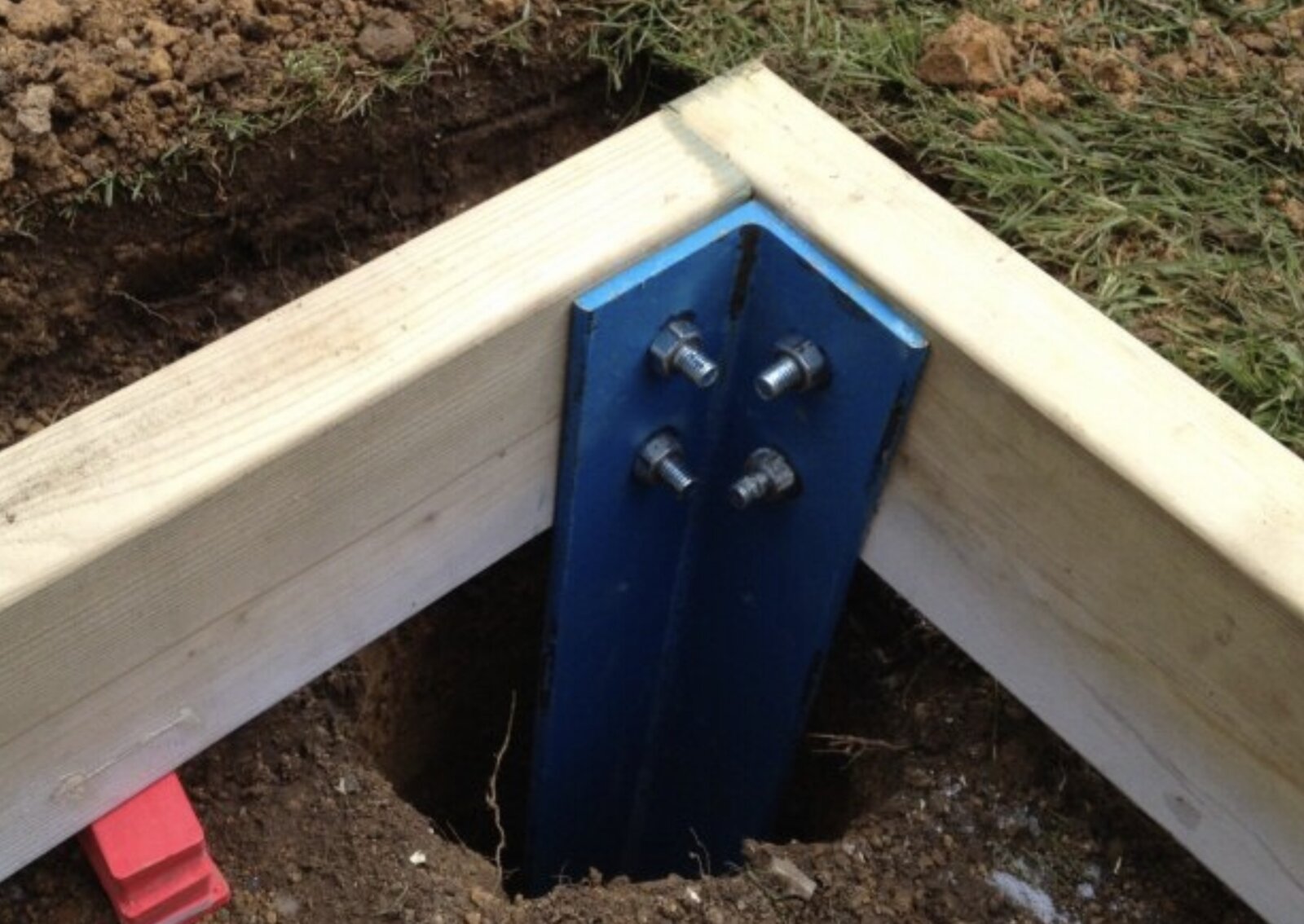

I’m on with finishing my plans for a shed/workshop so was interested to see the dekposts you’ve used. I’d contacted a garden room builder and got details of the 75mm x 8mm x 500mm metal right angled post they use as in the photo but these dekposts look sturdier so will see if I can get a local supplier.
My current plans are 6m x 3.2m and had worked out I needed 12 On 2m spans (120x45 joists)but looking at yours, you seem to have gone for shorter spans?

Hiya I think the bolts that I used were 10mm stainless steel, some of the holes where slightly smaller so I just run a 10mm drill bit through, I chose the concrete posts mainly because they are a good price from my supplier in Godstone Surrey and they won't rust, they also have reinforced steel inside, the shed is all up and running for the past two months and is great. Good luck with what ever method you choose, Paul

Forgot to say that the spacing was about one every 1m because it's a workshop and heavy, plus the joists are 2x4 treated, the base took a day to build including digging the holes, although it was late February and ground was more manageable.
I think the angle iron that you have in your post is from baker's garden buildings, I was against that idea myself because unless there is some concrete pad underneath the angle iron, it is a point load, the concrete dek posts are 10cm square so less luckily to move. Hope this has all been some help.

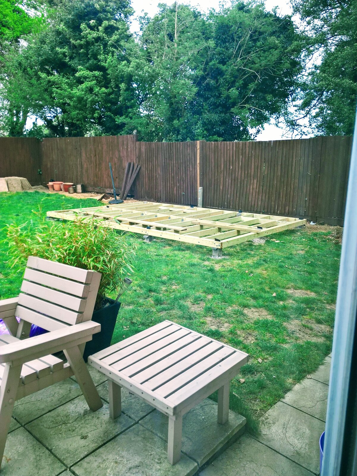

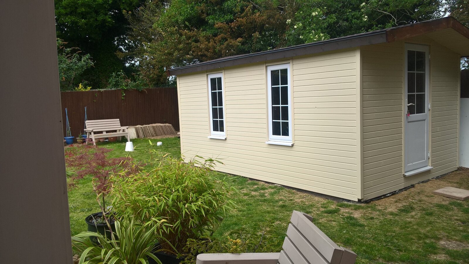

Hiya I built the basic frame without the extra support or noggins, the laid it on the ground and marked for the 12 post holes, didn't take as long as it sounds, I used the Screwfix speed coach screws, and joist hangers as well, hope this helps, I used the same system on our 3m X 5.4m summerhouse, I used the damp proof course between the timber frame and concrete post, again from Screwfix, not expensive at all, u can see on the summerhouse base frame.
Photo of summerhouse base.
Summerhouse photo
