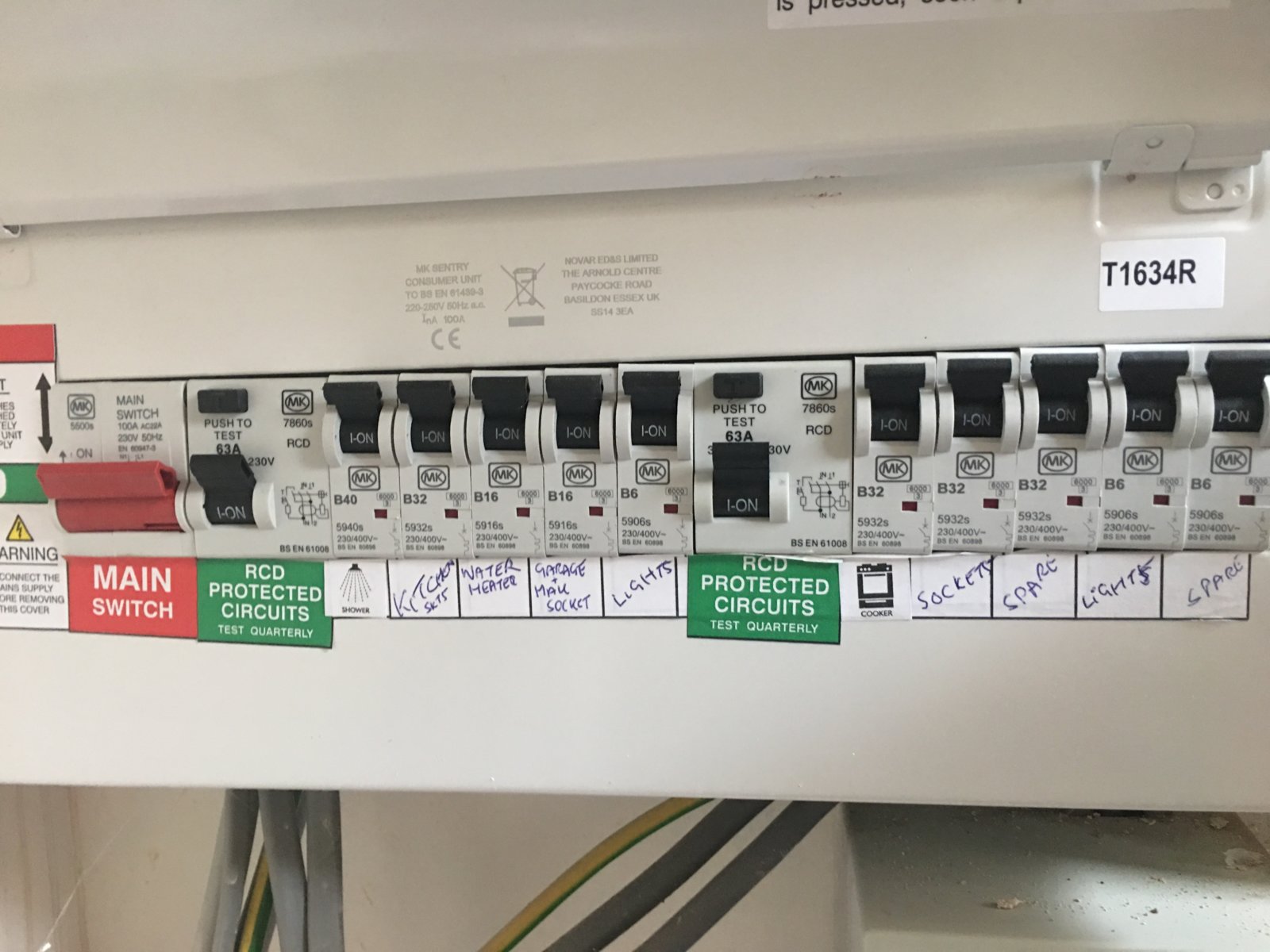

Ok so I have attached an image of my CU in my house.
The B32 MCB labelled kitchen sockets is the ring that feeds the sockets in the kitchen. We had an extension which is the kitchen and the electrician ran the sockets in the extension on this B32 MCB.
He ran a spur off one of the double sockets(not fused just joined in an outside junction box) and ran a feed to my then shed. That feed is the SWA 2.5mm mentioned here.
That shed is gone and now sits a small 3M x 4M cabin. The cabin is 3M from the junction box.
So what has been suggest to me is connect that 2.5mm SWA to a garage CU. That garage CU would have 1 x B20 MCB and a 40A RCD. The 40A RCD is an assumption based on me looking at garage CUs online.
No light circuit a radial circuit connecting 6 sockets.
Hope that helps.
Permitted, but it's a mediocre design.
The RCD isn't required - you already have one in the house.
Cabin on the same circuit as the kitchen may not be desirable either, depending on what loads you intend to use in there.
Far better to have a new cable from the house to this cabin, which can then be sized appropriately for the load and not be dependant on some other unrelated circuit.
Not ideal but it all seems acceptable to me - obviously as long as all the tested measurements are within the limits and not made unacceptable by the distance.
The 20A MCB will protect the cable from overload.
The relevant figure on RCDs is the 30mA. The 40A is just the current it can handle, so as long as it is more than the 20A is irrelevant.
The second RCD is not required but will do no harm.
