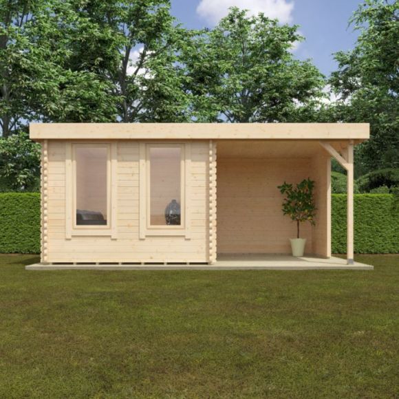

Remember, it's the internal floor you measure so your 18m2 over gutters may be a bit smaller
Ah I assumed the measurement was taken on the outside, ok so if I were to build one in the style of this attached photo are the dimensions of the outside section taken into account?
