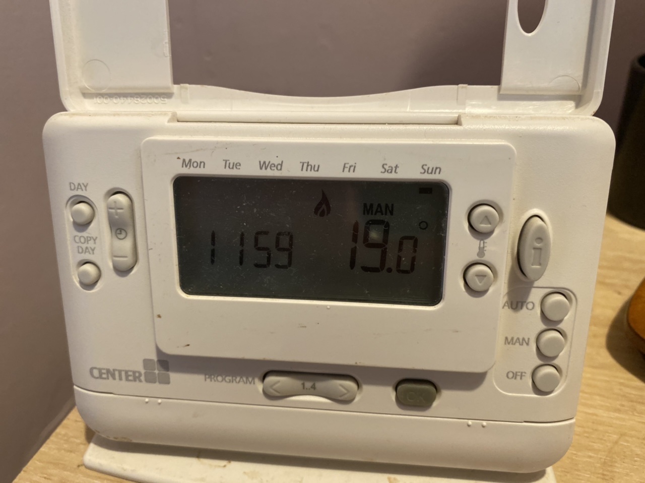

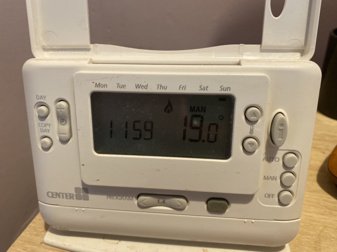

Hi I have a logic 30 Combi boiler which is 3 pin plug electric supplied directly to the boiler. Could some one help with the wiring setup as there are so many variances with power supply/ thermostat etc
the current setup is this wireless controller , no separate room thermostat

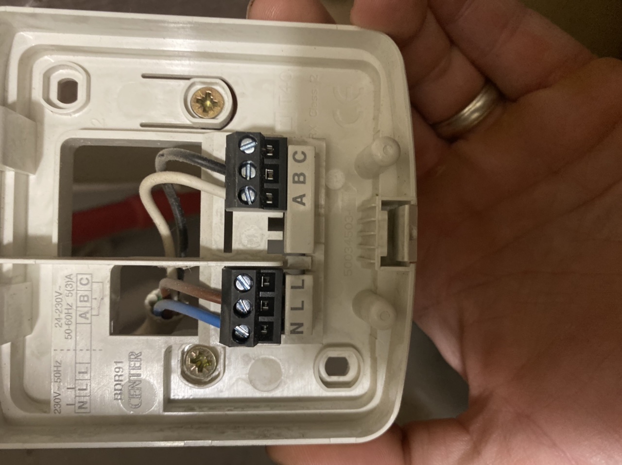

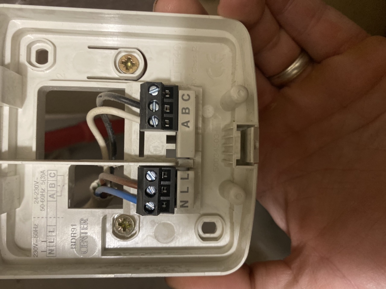

Also is the current wiring in the already installed receiver

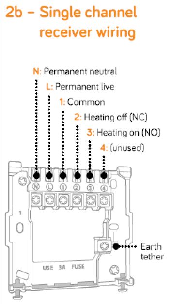

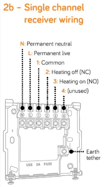

I have a hive receiver and thermostat the diagram is the hive receiver

You have posted the information that you have asked for in your photographs. The terminal connections for the BDR91 are printed on it showing A & B are the switch, and you have the Hive wiring instructions.
The current wires in the BDR91 go to the Single Channel Hive that have exactly the same function. So from that the wires transfer over as follows:
BDR91 N = Hive N
BDR91 L = Hive L
BDR91 A = 1 Hive Common
BDR91 B = 3 Hive Heating on
