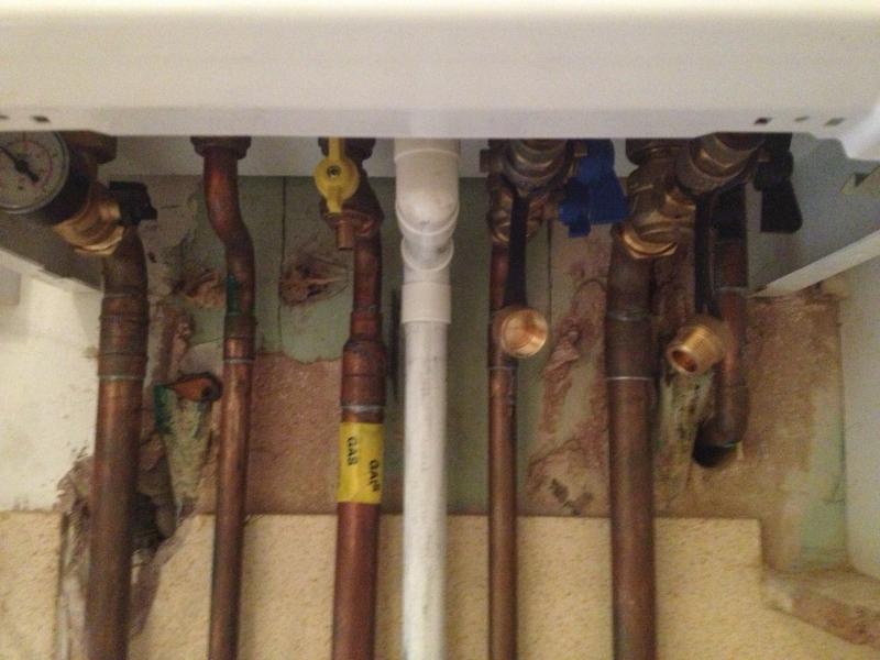

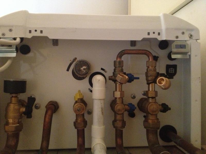

here are some picture of my boiler (first one is facing to it the second one is under)

Oh yes ok, so I think this is what he was talking about (the manual says)
"CH Circuit Drain"
(i have circle in red), it is indeed in plastic and seems to be something I can turn with the correct tool.

And also the black valve on the flow needs opening (the one on the far left with the pressure gauge on it)
yes, that worked. the pressure went back to 1 when cold and 1.5 -1.8 when hot
