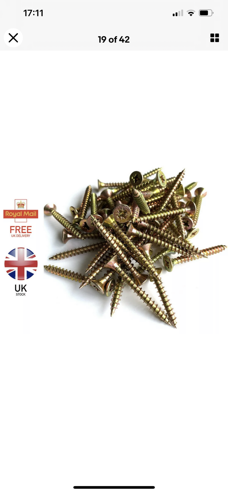

It is a pozi head. I think it should be fine. Should I go for 13mm instead? So: 4mm x 13mm
Does that sound good? Also do you measure screws from the head to the end?
I have attached a picture of the screws

Should be the length from where the screw would normally come to rest, and the tip. So countersunk woodscrews, from the flat of the head. Raised countersunk, from where the countersinking ends. Cheese/button/pan/round/etc, from the underside of the head.
Countersunk are not the right sort for this application.
No way are the screws in that photo 4x16.

This is the name of the screws: MULTI PURPOSE WOOD SCREWS POZI
Remember I am getting screws with 13mm in length. I am sure these would be fine for the shelves. I have discussed it with the seller.

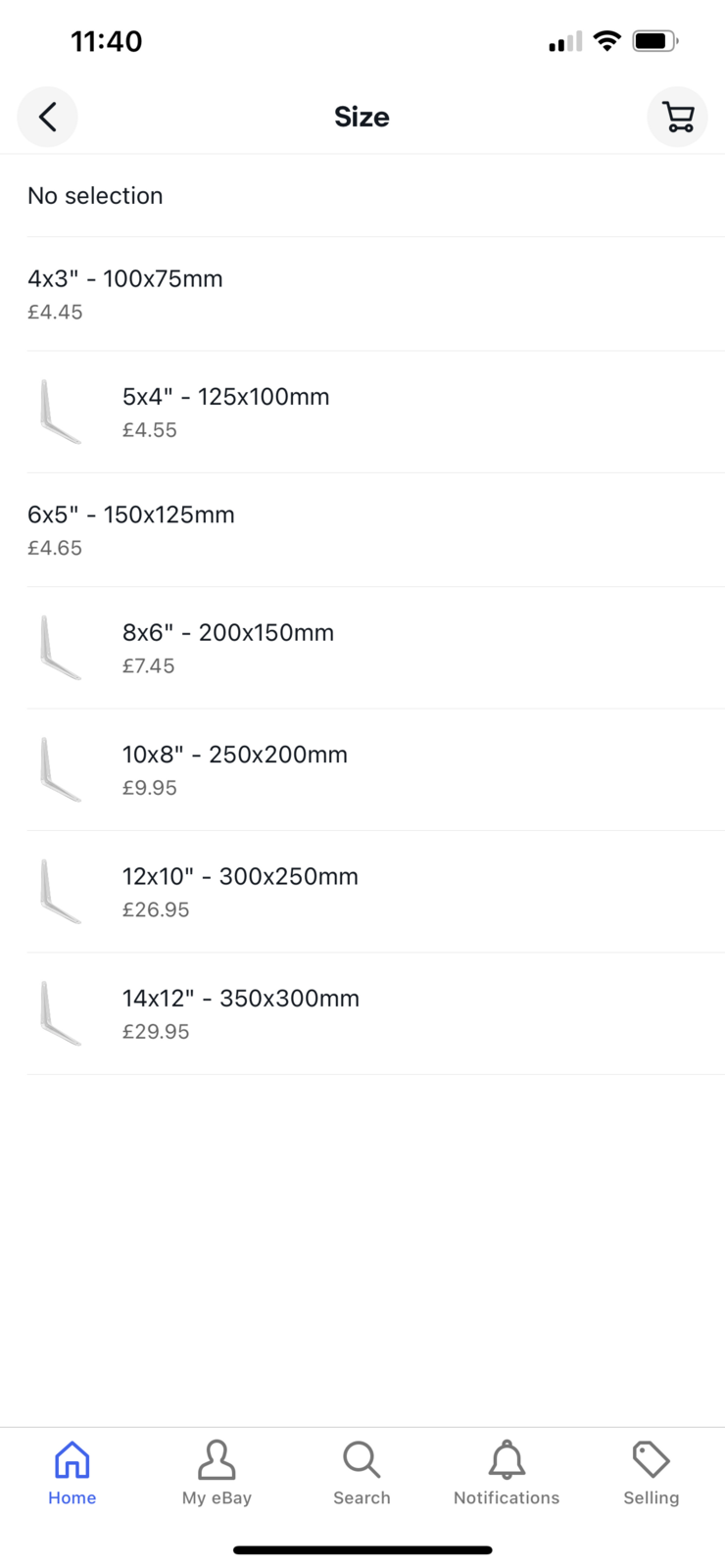

I am going to use London Brackets. What size would be recommended? I have attached a picture of the sizes.
I was thinking of: 150mm x 125mm
