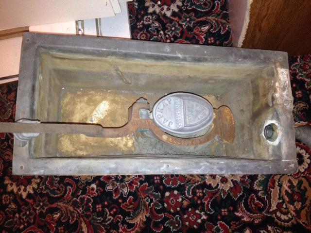

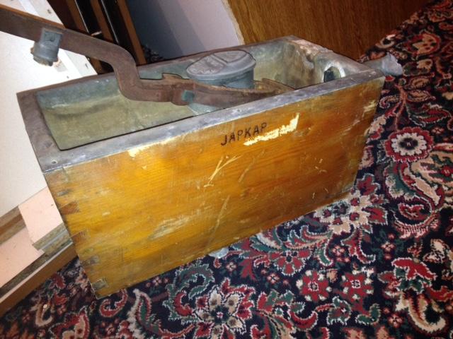

I'm restoring a 1906 Japkap high-level toilet cistern (pine, lead-lined) and have run into a slight snag.
The original ballcock was brass (no problem - easy to replace you say…), however there were two unique factors.
1) the arm of the ballcock would need to be around 340mm long (most modern replacements from Screwfix, etc are only 210mm) - see the one shown on the right here:
Is it possible to get a long armed float valve or an extension? If I thread a piece of brass bar to make my own extension will this damage the float valve?
2) the ballcock was mounted on the rim of the cistern - could I just rest the threaded portion of the valve on the rim and use a copper pipe clip to screw it down?

Back to screwfix for a Fluidmaster brass shank side entry valve :idea: - on the premise that one won`t see the mechanism from below , and the pipework will hold the valve - yes clip it to the rim with a 3/4 inch copper saddle clip ( and short black jap screws - not c/s pozidrive ). I collected over a 4 year period , everything for an authentic WC - as you are ? .From a "Speedwell" iron cistern with silent syphon ( not the bell type ) through a lead flush pipe to victorian flower patterned pan which would have sat in a wooden box with an original wood seat . Got all the stuff ready to replace the nondescript WC in the cloakroom - though I had already fitted a modified Victorian drinking fountain with a tap ,as a hand basin . Then we moved and the buyers didn`t want the old look :!: So I sold it all - but the basin stayed because I had to bury the waste in the wall :LOL:
if you use option2 instead of using copper saddle you could use one of these 15mm straight wall plate adapter which would give a more ridged fix available from screw fix in gas fitting section or any plumbers merchants

Buy a fluidmaster brass shank side entry valve
And either a) fit it over the rim, held by the pipework and a saddle clip. b) drill a hole and mount it as designed. C) use the gas fitting as proposed by HOWEDPLB - that fitting looks great but I can't work out how it would work...
Pros: Quiet, fast filling, less adjustment, less work for me, cheaper, more reliable
Cons: it wouldn't look right.

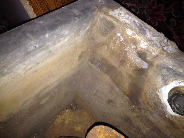

I think that Option 2b is the way forward folks. There is an existing hole in the cistern that would originally have been the overflow but would be ideal for the side entry valve due to the position of my existing services.
I'll be adding an overflow to connect to the existing 22mm plastic outlet and thought that this one from Screwfix would do the job well. I'll drill an appropriate hole for it.
The only final question will be what sort of washer/seal to fit between the syphon and the lead box. The original one was rubber and when fully compressed was around 2mm thick, 74mm OD, 43mm ID.
