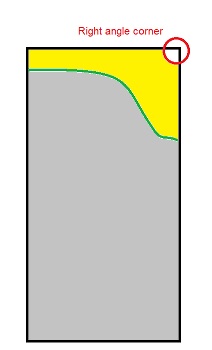

Cutting a the corner from a new sheet ply wood will create a accurate "square"
