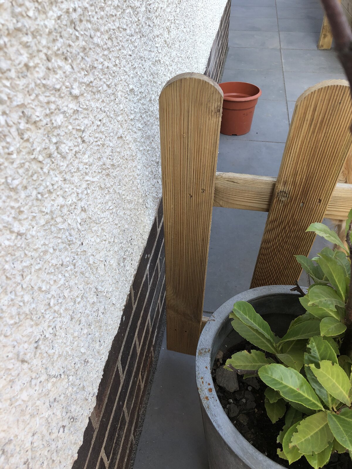

Looking for a gate latch that I can secure to house wall and not a post
26 Apr 2017
185
2
I have this gate that’s perpendicular to the house wall. We keep it closed with a heavy plant! (Stop the dog pushing it open)
I’d like to put a gate latch on it. Something like this XFORT® Gate Latch, Garden Gate Catch, Auto Gate Latch Ideal for Front Garden Gates (Black) https://www.amazon.co.uk/dp/B07CQ2LMZX/
but this implies there’s a post. Those latches are secured 90 degrees to the gate.
I can’t find something similar that I can secure direct to the wall of the house. I don’t really want to secure a post to the house just for a latch.
Does anyone know of anything? Just needs to keep the keep the gate from being pushed open and be easy for a human to open close it.
thanks

Actually I have found something now soon as I posted this. On Amazon it’s a Right Angled Latch. Works a bit different to the one above, no thumb opener thing, but looks like it may do the job I want. Although my dog intelligence is growing it does look easy to push up and open. She already figured out how to open my patio sliding doors

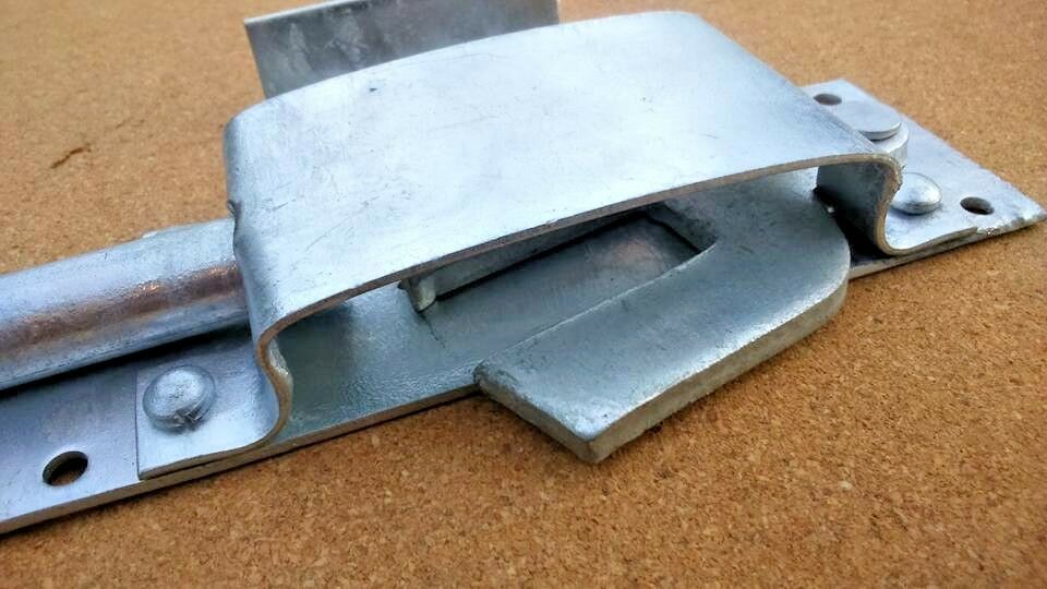

I think you need a fastening designed for an animal enclosure.
there are various designs used for horses and pigs, which are particularly intelligent animals.
this is one example (I couldn't find a pic of the one I am most familiar with). which has a pivoting plate, dropping under gravity, to block movement of the bolt)
listed as "pig bolt" "stable bolt" "animal bolt"

Just fix a piece of 2”x2” to the wall. That will act as the gate stop then you can drill a hole in it and fix a simple slide bolt to the gate.
That's what I'd do, that's what you'd do but the OP doesn't want a bit of wood there, I think it would actually look better.
Occurred to me I just put the latch the other side of the gate, not inside the patio area where we'd let the dog out! She wont be intelligent enough to actually reach over and pull it open with a paw I don't think.
Ah yes that would do the job. I didn't see this, or if I did I thought it was a standard one not right angled.
I didnt see a reason to fix timber to the wall in order to fix the latch to that when I should be able to just fix the latch to the wall. The timber would be an extra object thats just visible when the gate is open and potential hazard.
