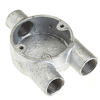

You'll need to use armoured cable, and there will probably be no way to get 2 glands into each light. Buy ones with a body which have room for a 20mm conduit Y box.

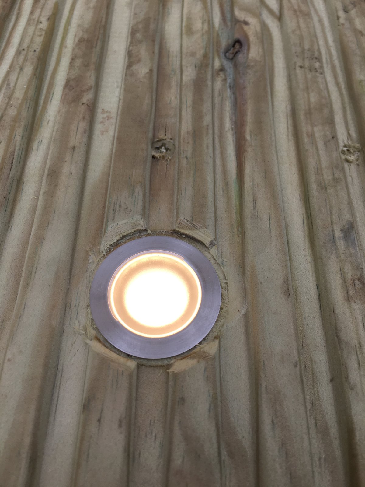

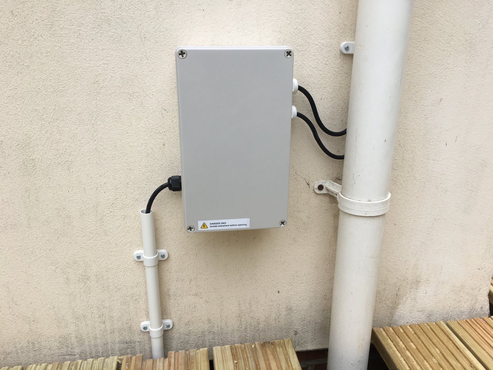

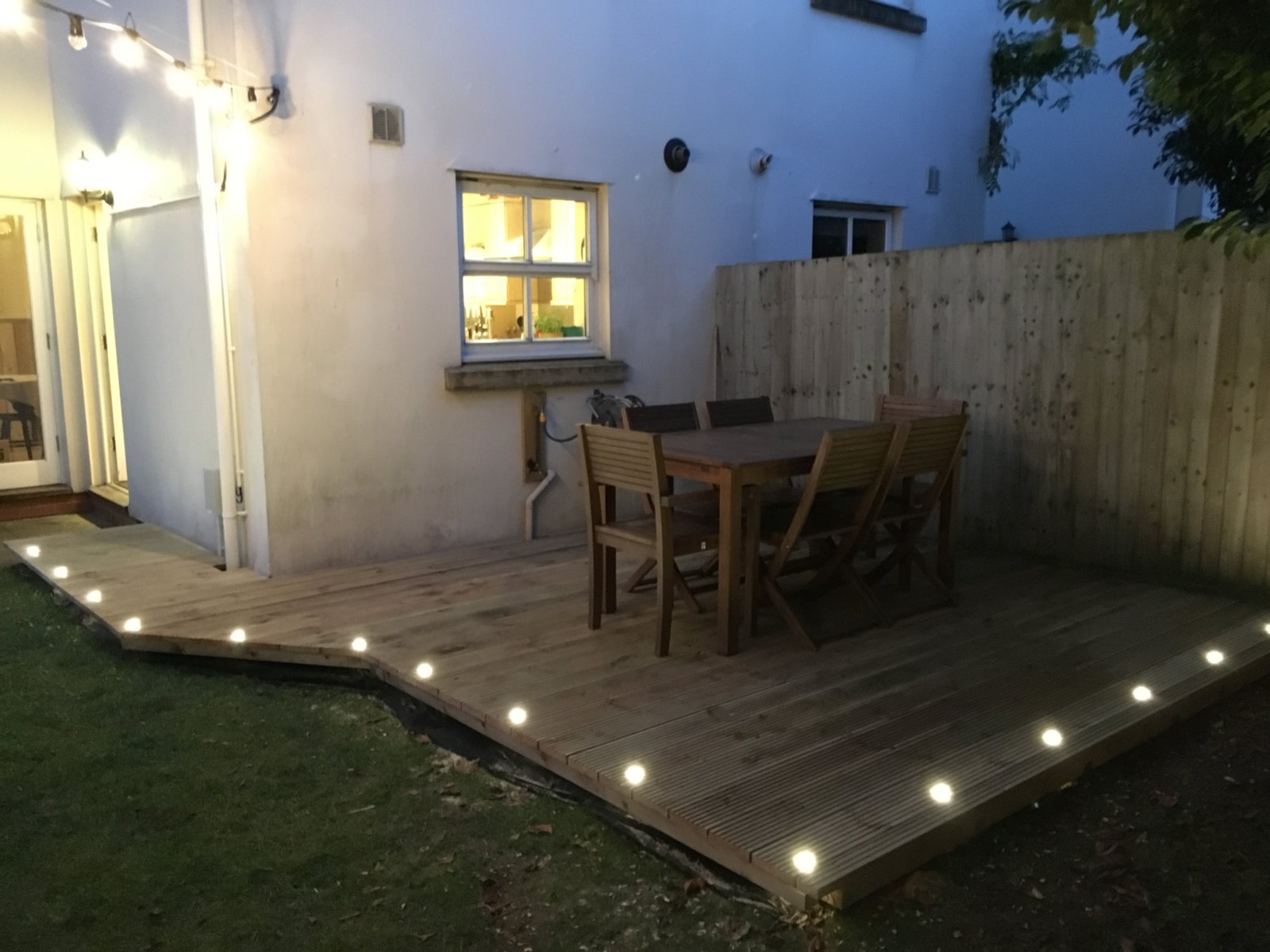

Low voltage is the way to go. I used these for my deck, not sure they are suited to your needs but they are cost-effective and come pre-wired and sealed. https://www.amazon.co.uk/gp/product/B071KKMHHZ
As noted above - you need to decide what the lights are for - if they are just edge-markers for cars then go for low wattage up-lights, if you want to actually flood-light the drive for pedestrians, then mount them so the shine horizontally onto the drive and go for slightly brighter ones.
Most kits will physically allow daisy-chaining (including the one linked above), however if you do this, you will likely have to source a custom transformer as the supplied ones are typically designed for the kit only.
Pretty simple calculation - take the wattage of your lamps (at 12VDC) multiply by the number of lamps, allow a bit of overhead. The ones I linked are 0.6W per lamp - so 1 per meter on each side of a 40 meter drive would be 80x0.6 = 48W. So something like this would be ideal: https://www.amazon.co.uk/Integral-LED-Constant-Voltage-100-240VAC-Non-Dimmable/dp/B01D36CDIY
