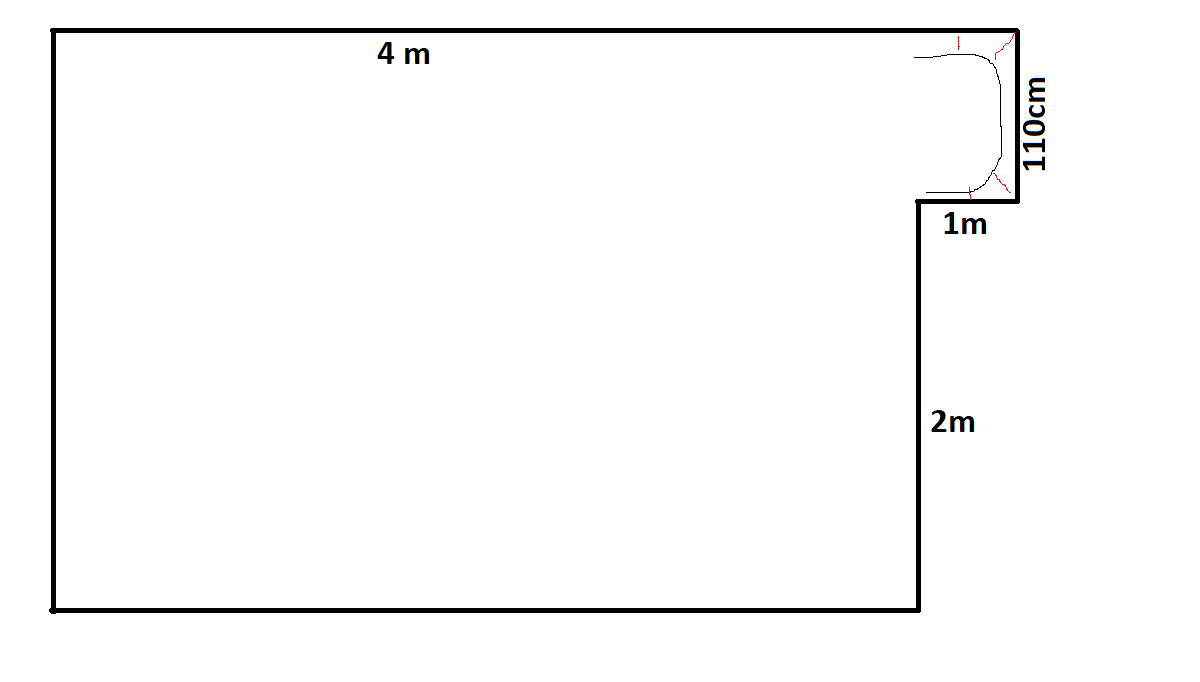

I am looking to create a custom wardrobe to make use of a deep section in a bedroom.
Is there such thing as a curved wardrobe rail? I have looked for ages but haven't been able to find anything. I have uploaded a drawing. I am looking to install a curved rail as pictured, with anchor points to the floor and wall as shown in red.
I will then cover with doors and such.
Please help!

the best you can hope for is to think off a say octogon with a strait between ever change off angle that will be a support bracket
if you think off it any thing away from the strait line between two supports is a lever greatly increasing the weight in a twisting motion
If you know a plumber, they can generally bend light to medium weight circular cross section tube on a pipe bender to a variety of radii in a variety of diameters (15, 22 and 28mm being the most common sizes). Problem with bending plated tube, however, is that it damages the plating, although stainless steel, on the other hand, could easily be refinished or repolished afterwards. With mild steel tube you'd need to get it lapped then plated after bending.
I have no doubt that there are engineering firms out there who can do the job, but non standard cross sections (such as oval tube) or non-standard bend radii would require a metal die to be made up which won't be cheap.
What sort of radius of bend were you thinking about?

I thought I uploaded a photo. I have uploaded it now, thank you. Please see the photo. What do you think? If there is no "off the shelf" solution then I may have to just get a few straights.

I think you may have underestimated how much space a coat hanger takes up.
A coat hanger is 9" (48cm). That means the rail needs to be more than 25cm away from the wall.
Have a look at the following image
The two red lines are rails that run from the front to the back. The green lines are the coat hangers. Those two rails give you 2m of hanging rail but it wont work because your clothes will be pretty much touching each other- you wont be able to get to them unless you use rails that slide forward.
The blue line is a rail running from left to right. It only gives you 1.1m but you could put another rail in front of it. Providing that you don't fill the first rail, you can slide the front clothes to the side to get to the back rail. You will them have about 2m of total hanging.
Your curved rail won't be practical. The area is too small.
not enough room for a curved rail you need about 250-300m from the edge for a garment to sit properly on a hanger so a curved rail will be very inefficient space and practical wise
best use off that space several shelves about 150-200mm deep side to side with a rail in front side to side

If the rail was a circle, 2πr implies 2*3.14*0.25=1.57m of rail but far less would be usable because of the clothes bunching in the centre of the circle
BTW do the rails need to be for full length coats and dresses. If not you could have two rails at the top and two at the bottom.
