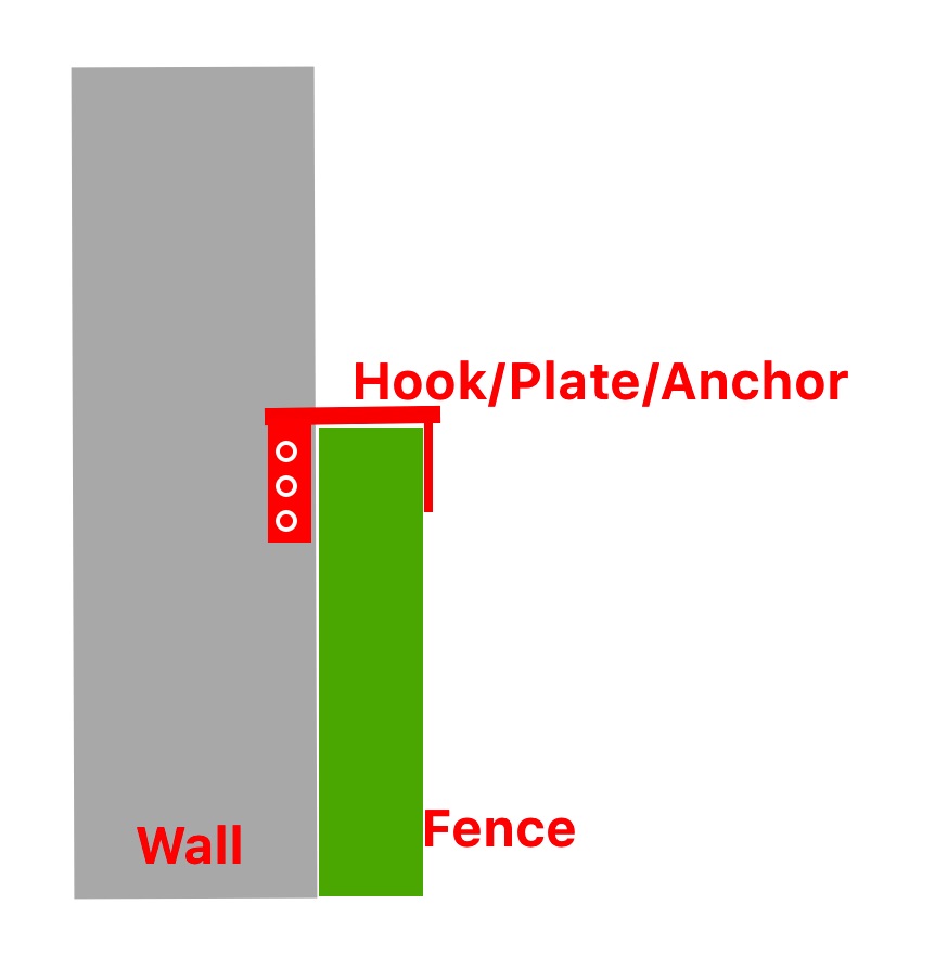

Hello,
I'm looking to fix my garden fence with my wall. I want to have sort of L/U shape anchor, to hold the fence from the top, with plate on left side which I can screw with wall. Here is the diagram.
I'm aware that I can achieve with an L shape hook but I don't want to drill the fence. I think it would be an elegant solution if I can anchor it with wall.
Can anyone suggest where can I find this kind of hook.
Alternatively suggest me what sort of hook to use to fix it.
Cheers!

Never seen exactly what you want but take a look in the joist hanger section of a builders merchant.
You could make one pretty easily even in a home garage with some steel plate, a hammer and vice. Using an angle grinder or jigsaw for cutting and the vice as a folder. Allow for springback when folding and a bit on measurements for the curve, or shave the post top to fit.
This fence is on the side of the wall and placed on the top of a brick fence. It has become loose and leaning away from the wall. Fence just starts from where wall ends so I can't drill screw bolt from the side of fence into the side wall which would have been easiest option. The only option is to have a hook kind of thing which will hold the fence without any drilling into the fence and then a plate to fix hook into the back of wall. It is tricky situation, if I can find that kind of hook then it would easiest to fix. Joist hanger is not appropriate as there is no wall behind fence.

A top view plan would help
Thanks for reply & help. I think I found something similar it's called restraint twisted straps with bend which will help.

fixing a fence to a wall will tend to pull the wall over or loosen bricks if the fixing is near the top or end of the wall.
there is a steel fence clip in a U shape made for nailing onto wooden fence posts, and sliding the panel down, but you can put a screw through the side rather than the back if you want.
you will have to drill a large enough hole in the side facing you, to fit your screwdriver through.
