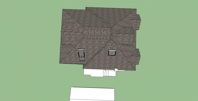

Hi Guys,

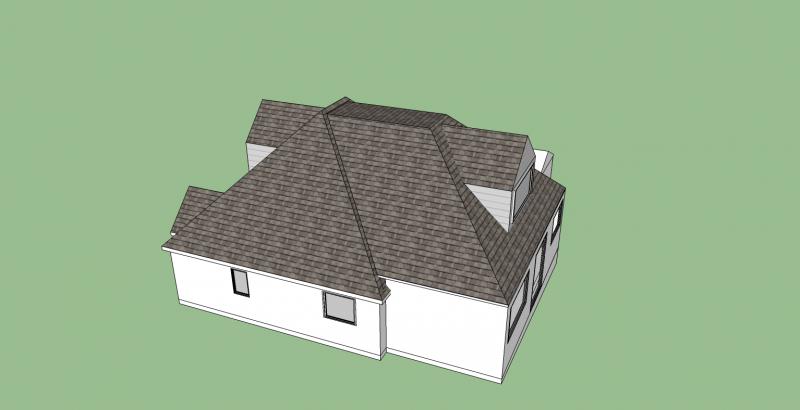

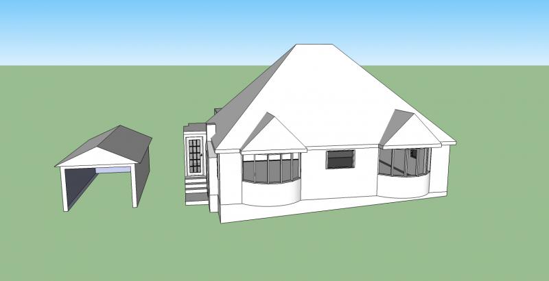

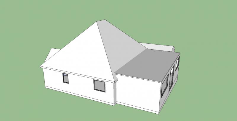

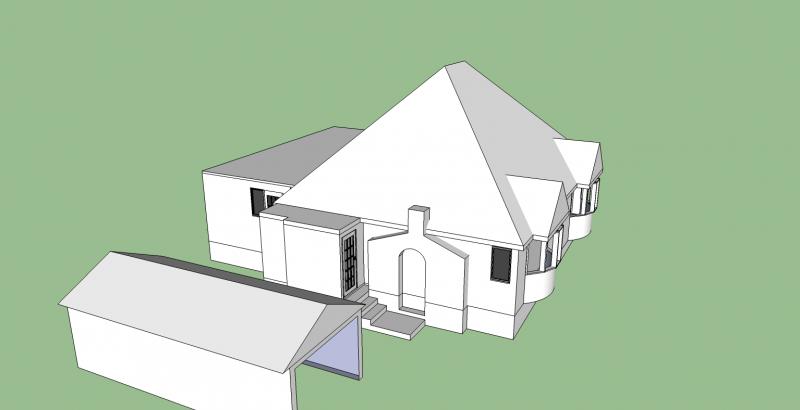

I'm planning to extend and convert my bungalows loft and roof space (above flat roof extension). I'm trying to design it myself but i have no design/architectural experience, so i'm attempting to learn. I would like to put 3 bedrooms upstairs, a family bathroom and maybe 1 en-suite so need a fair bit of space. I'm not currently sure if the best idea is to replace the whole roof (currently its a cut hip roof) or to get someone to build some dormers and extend out the back but until i understand what is possible i can't really make a decision - i'm looking to do it relatively cheaply.
So firstly, I've been trying to think of how to extend the current roof (see pics). I was hoping experienced people can tell me what sort of thing they might consider? The ideal situation to maximise space is to extend out to create a gable end over the rear extension, but if i do this the new ridge would have to be higher than the old ridge (as the existing ridge is at 90 degrees to it). It seems like this is the wrong thing to me, it will look strange and may not be allowed by planning.
I also thought about a M shape ridge (double ridge?) making it slightly lower and still match the current angles.
Are there any other options? Given my situation, would extending the roof like or getting a new roof be cheaper?
Any ideas much appreciated.

All i want to know really is what people have seen on similar types of roofs/extensions, there must be plenty out there right? What have they done to the roof on those?
You can just extend the lot and have a section of flat roof at the top instead of an apex/ridge
Or extend one side of the roof, and have a normal ridge and then have a small bit of flat roof one side of the existing extension

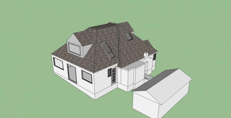

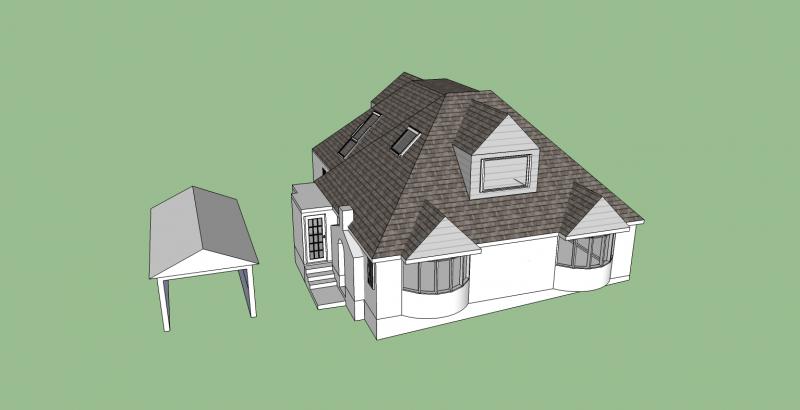

Thanks all for your replies. I think i like the smallish flat roof option, I've tried to model it a bit and i've added some dormers and made it hip shape because a gable end looked bad with ridge or not, and even though i lose space it's probably nicer to have a better looking building.
Does this look like a good plan?
Also, when i said relatively cheap i meant it, not doing it on the cheap if you know what i mean.
personaly i like your idea. Lead coming on to the tiles with the top cut (meaning no ridge) would look nice
