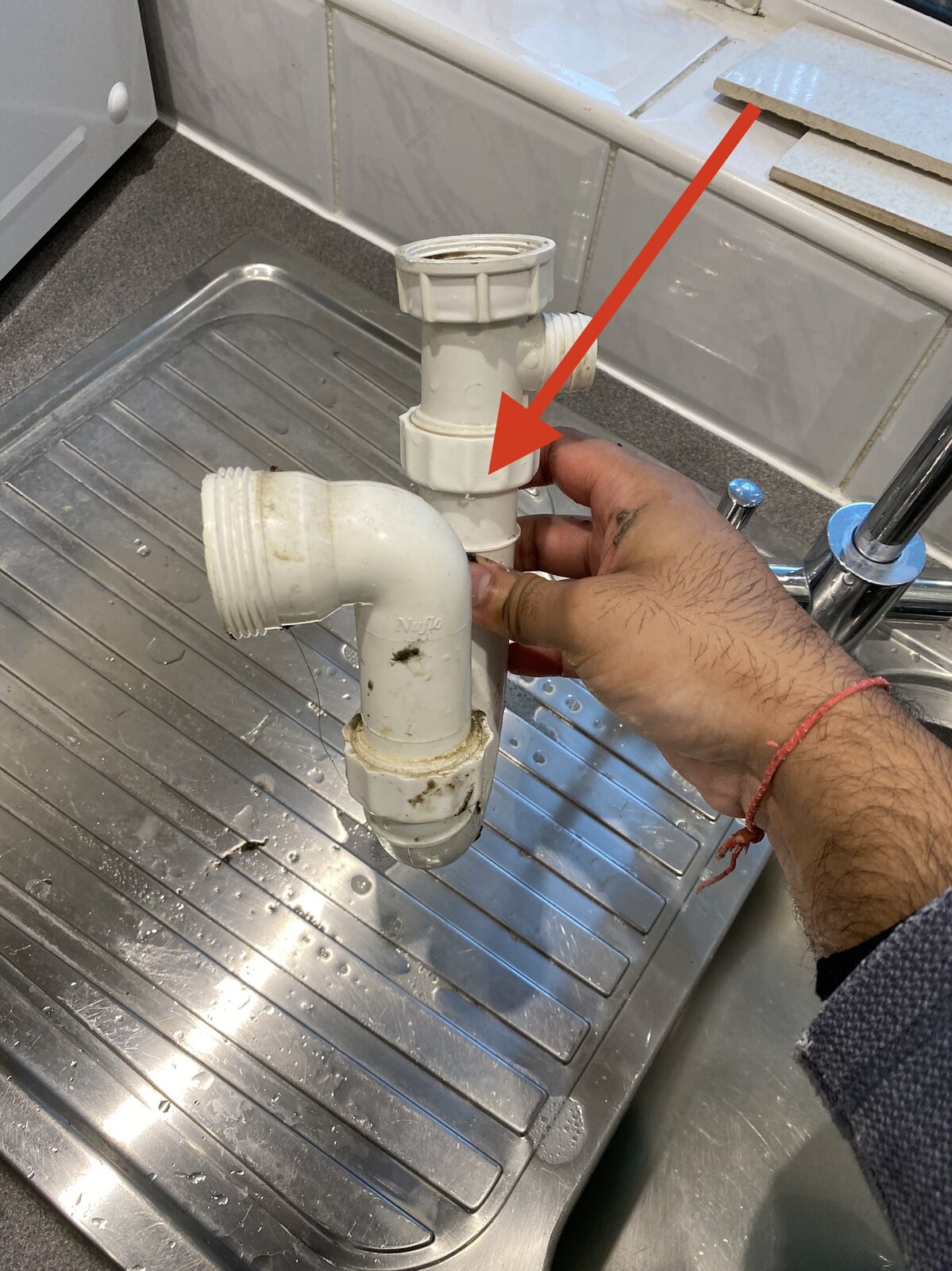

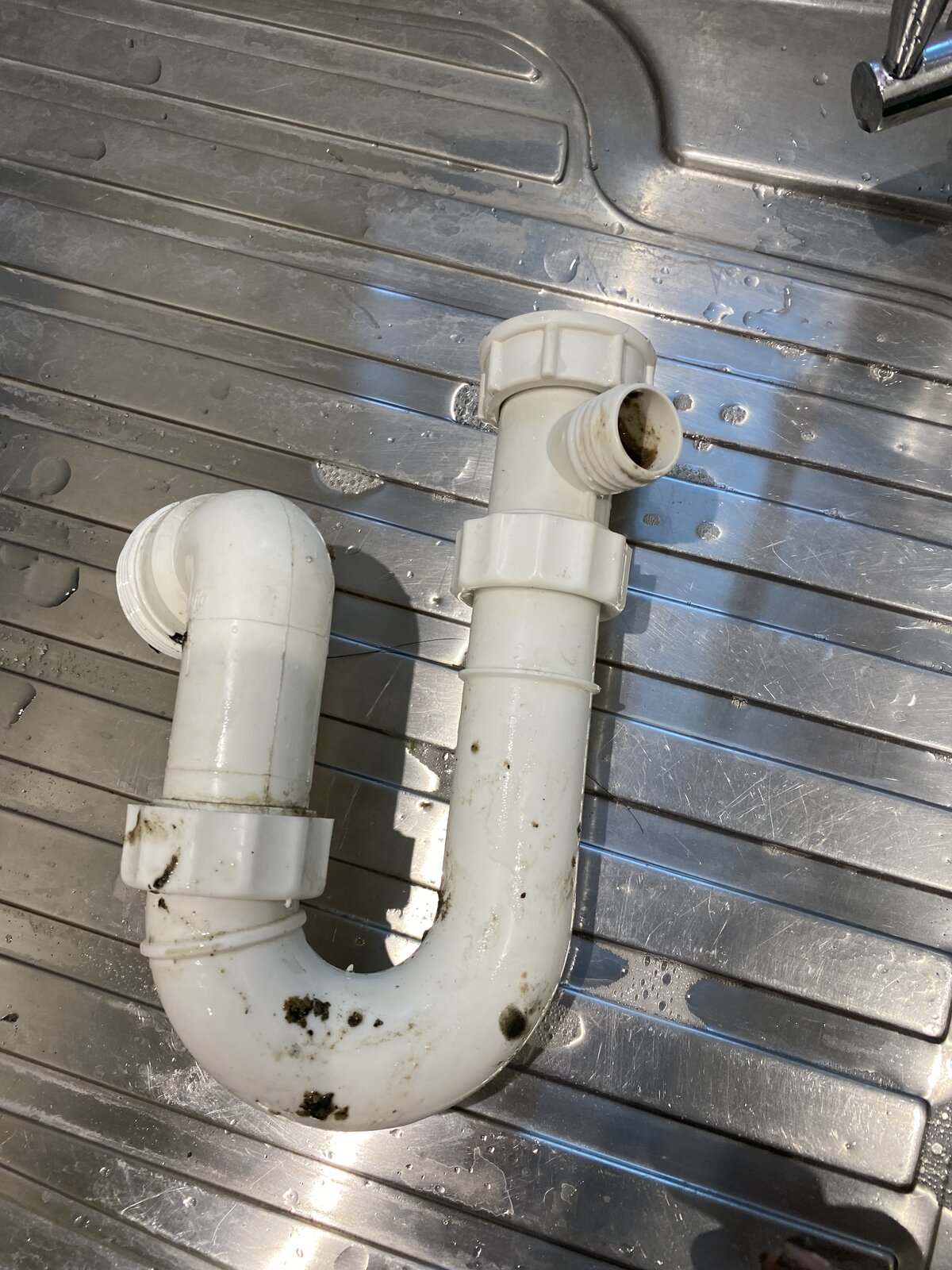

Hi everyone I’m looking to change the p trap u bend under the sink because it’s leaking but I can’t find a p trap with an inlet for the sink overflow pipe to go in? Which part do I need any advice would be helpful thank you, the pipe is 32mm I can find p traps but non have the inlet ?
Yes but it leaks from the join that’s why I need a new one
Your sink should have a 40mm waste and trap. 32mm is normally for basins which don't generally need an overflow connection.
This joint leaking it doesn’t seem to tighten all the way the plastic doesn’t seem the right fit ? It’s defo a 32mm probably old type
You might find that it will fit the new trap ok and the new trap will have a new seal. If the trap is for a sink then it will be 1 1/2" (40mm).
That isn't a usual fitting and may have been bespoke or it's one of these.
th
It's called an appliance trap adapter. It would be a suck it and see.
