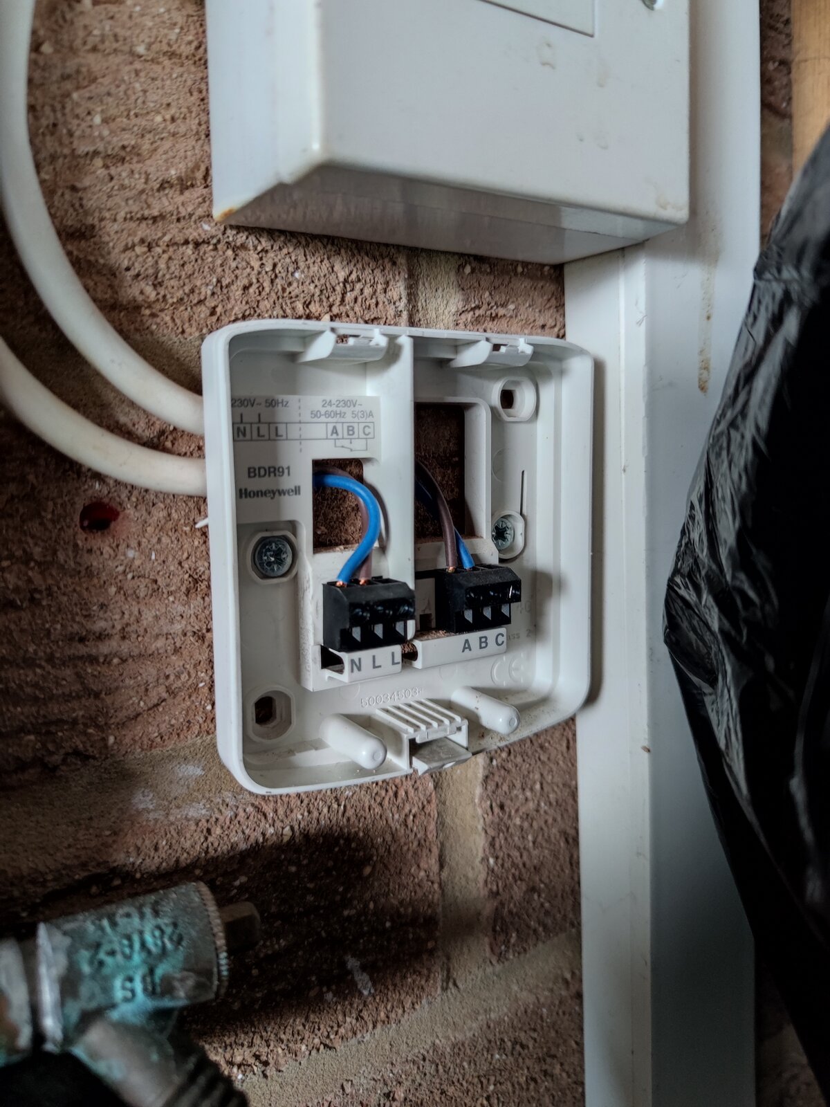

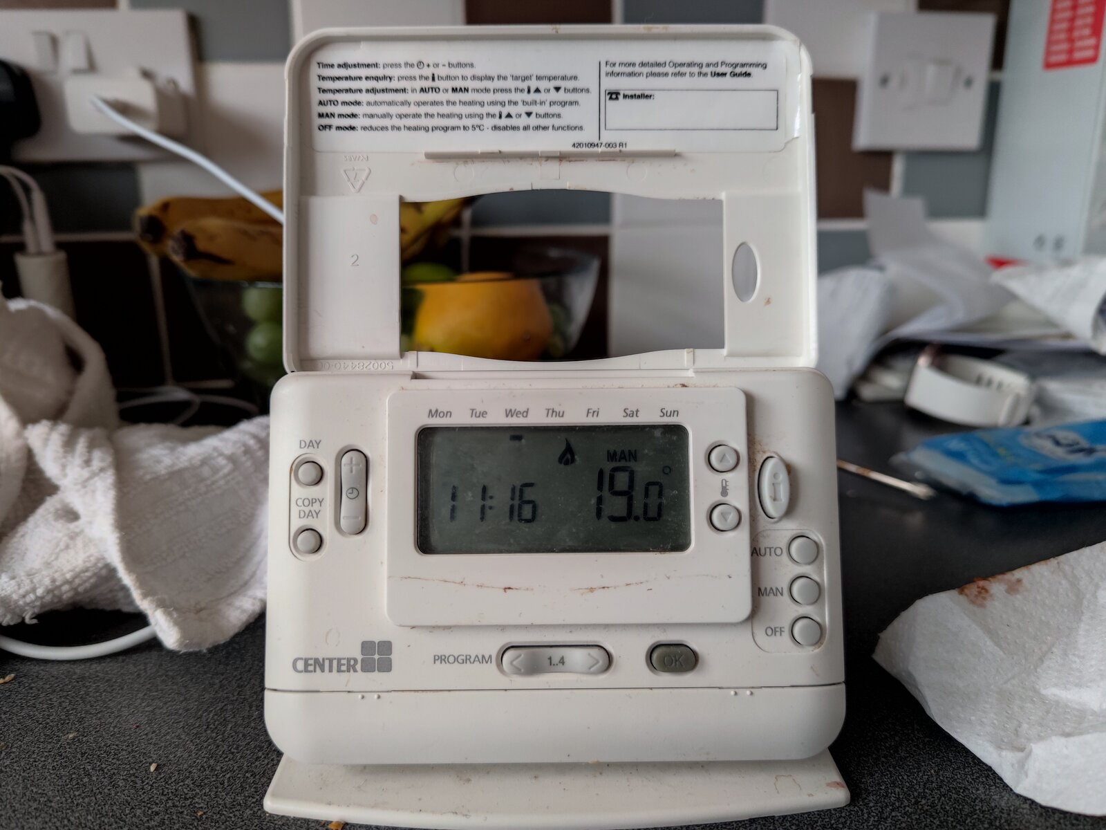

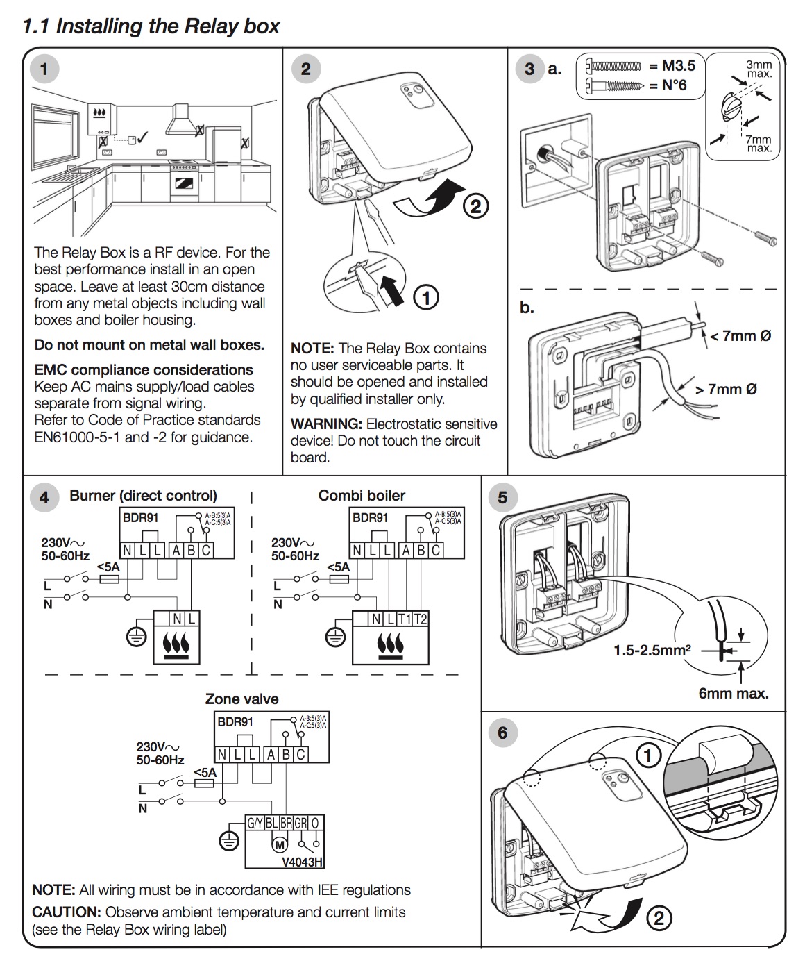

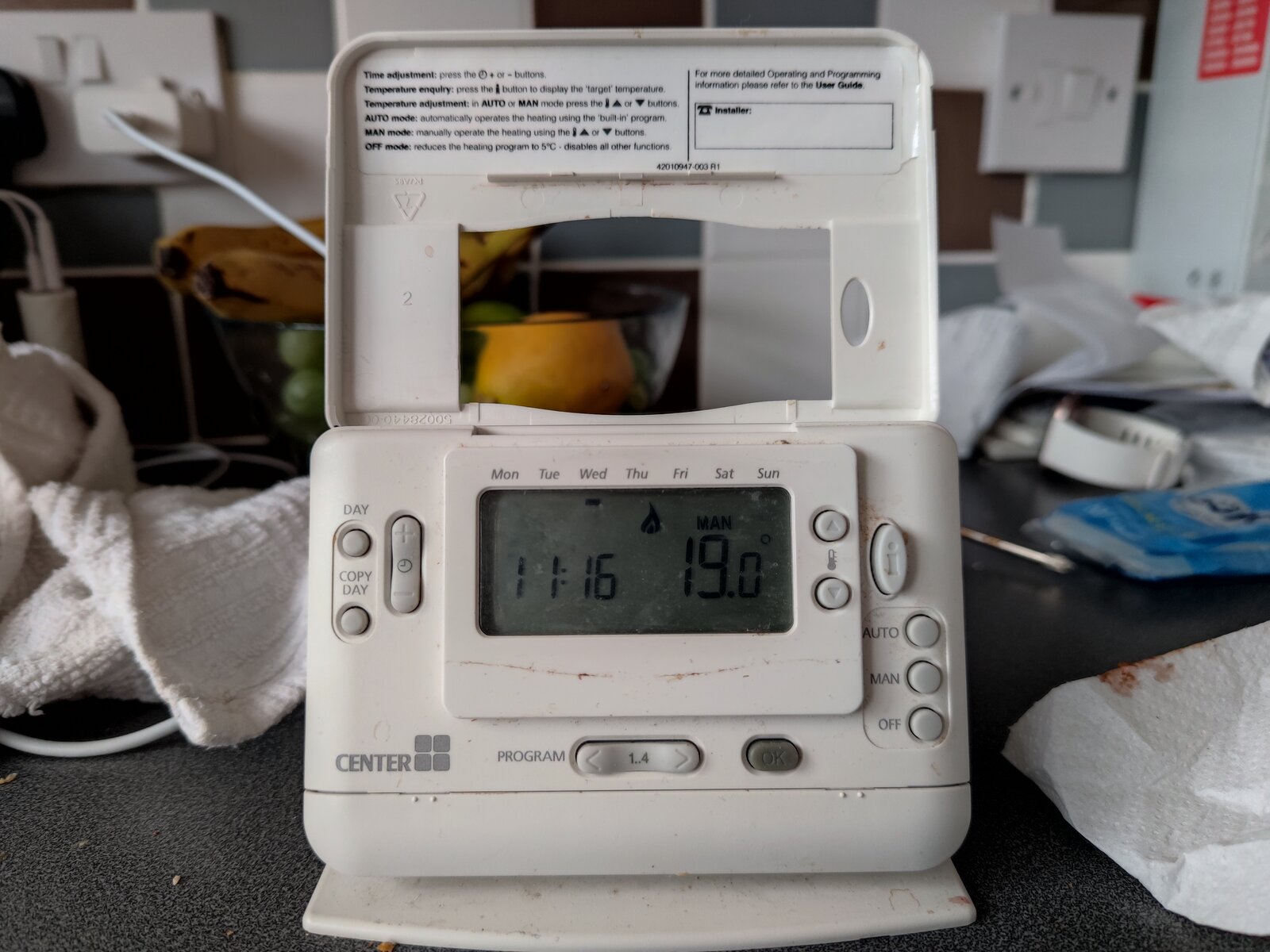

Been thinking about changing my Centre wireless thermostat with one that can be controlled via smartphone for the times when we want to put the heating up or down when we are out and about.
Not sure if we are bothered with any of the smart features like Geo fencing or even multizone heating so cheaper the better really.

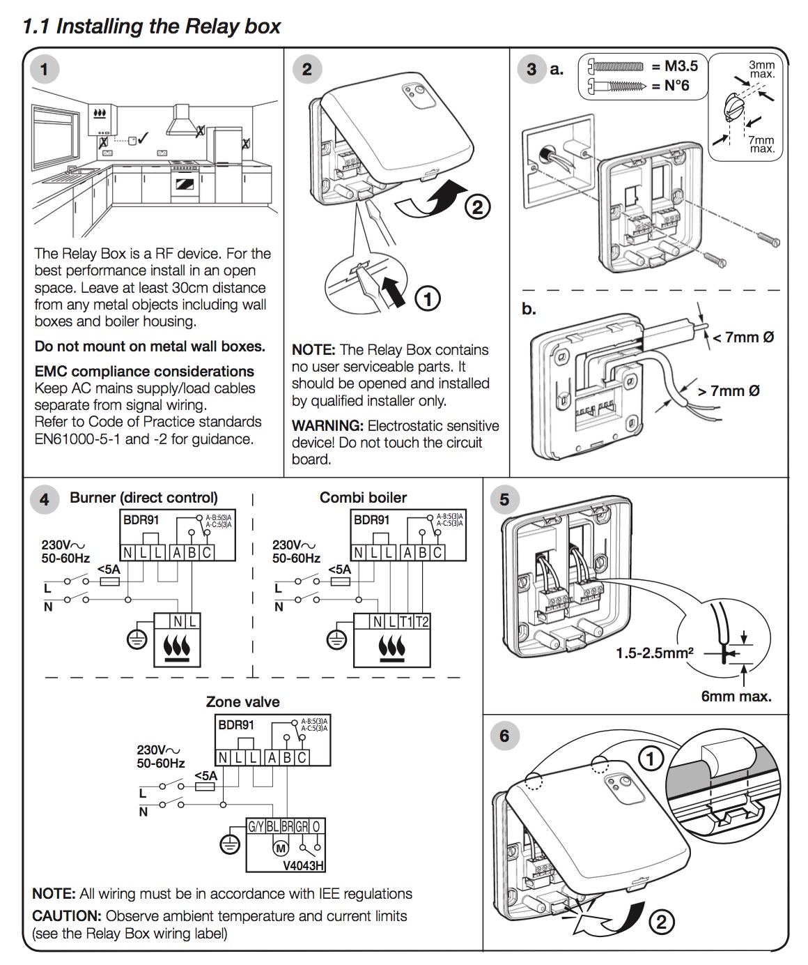

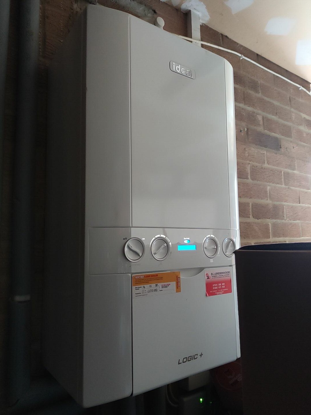

The boiler is Ideal Logic+ combi boiler and I have attached some images of the boiler & wireless receiver which is located in the garage showing the current wiring from the boiler to the receiver and the wiring diagram.
I would say that I'm OK at DIY so familiar with basics like switching off the power at fuse box when working with mains etc.. and wondering if it's simple task to change to a smart thermostat e.g. Nest, Hive, Tado etc.. myself. I assume I will need one that has a separate wireless receiver that replaces the current one rather than the ones which replace wired thermostats on the wall.
Any recommendations for smart thermostats (preferably cheaper the better) and one which would be a simple swap with the 4 wires which are currently on place or would it be advisable to get a professional in as it may be more complcated that just screwing in the correct wires from and to the new unit?
Thanks in advance

The ideal halo controller would be excellent for what you want.
I believe it's opentherm aswell and connects via the low voltage side of the boiler so should save you money.
Just get a single channel Hive the receiver wiring is simple
L&N remain the same and the wires in A&B go to 1&3 on the hive single channel receiver, if you prefer the Ideal halo make sure you order the Wifi version if you want to control with your phone
My method is copy and past the boiler details into google and add installation instructions to end, looking at what I find I use the 'find on this page' function and look for key words like "opentherm" and on page 33 I got a hit.
So the boiler it seems is OpenTherm enabled so you would want the thermostat also to be OpenTherm seems no point changing for any other type. So the next question is which, Hive is not opentherm so that is out, looking at Nest, EvoHome with add on, EPH, Tado etc.

The current thermostat is I think on the way out... The LCD display at times goes blank and the time is always inaccurate even if we swapped the batteries out hence why not use this oppotunity to change and save some £ by DIY hopefully.

The opentherm on the ideal only works with ideals own halo controller.
To install the halo or the nest it's prety much the same amount of wires.
As Ian said if the halo make sure you get the WiFi version and NOT the "lite"

Just looked at video to install the Ideal Halo wireless and it seems very easy as it connects to the boiler internally via a single connector.
My only concern is what I need to do with the existing wires connected to the current wireless thermostat receiver if I decide to go this route?
Just remove them.
The boiler still needs a permanent 230v feed though I believe.
Just ordered The Hive as decided that this will give a little more flexibility if we change boiler make in future compared to the Ideal Halo.
Can I just confirm with you that wire A (brown) goes to 1 and wire B (blue) goes to 3 on the Hive receiver? Thanks
yes, but it doesnt matter which way round you do it, the hive is simply a switch, either way round it will work fine but yes the way you suggest is fine
