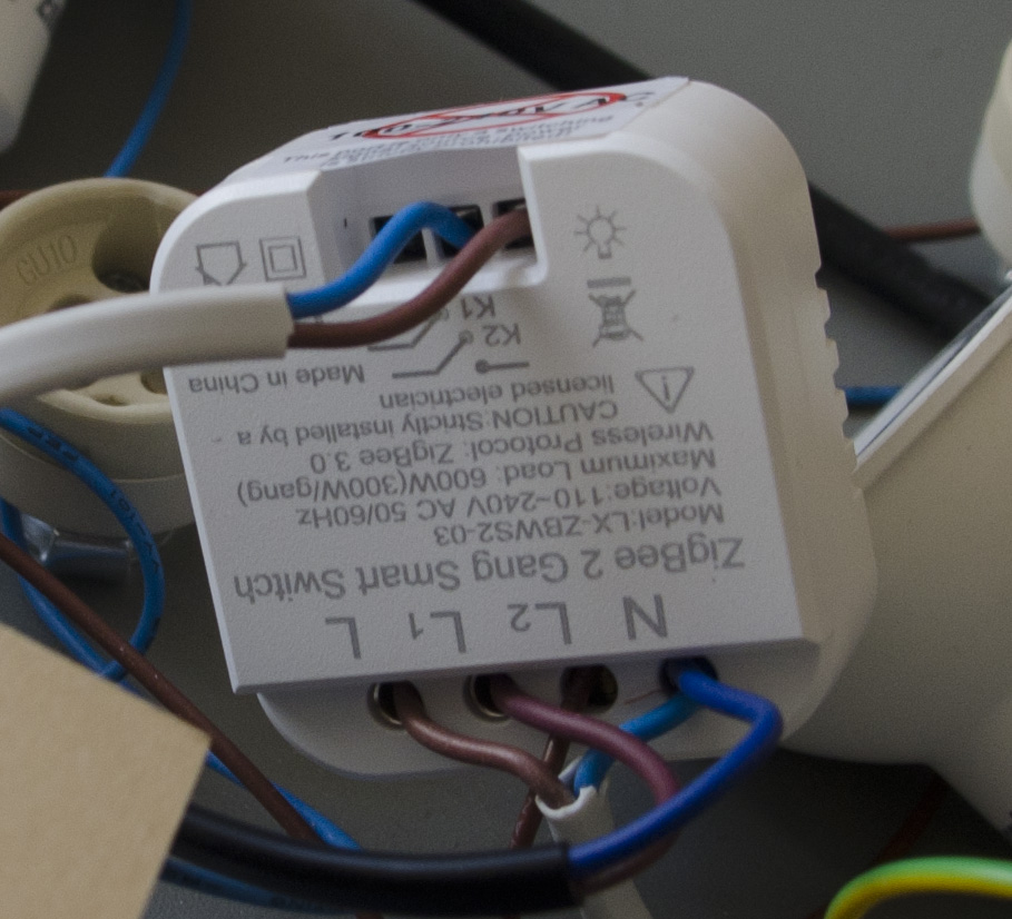

The use of the relay at the ceiling rose DSC_6061.jpg can give best of both meaning the drops to switch are extra low voltage and you can use smart switching in the same way as a two way switch, so both wall and phone can turn lights on/off when required, although small it is too big to fit inside a ceiling rose.
