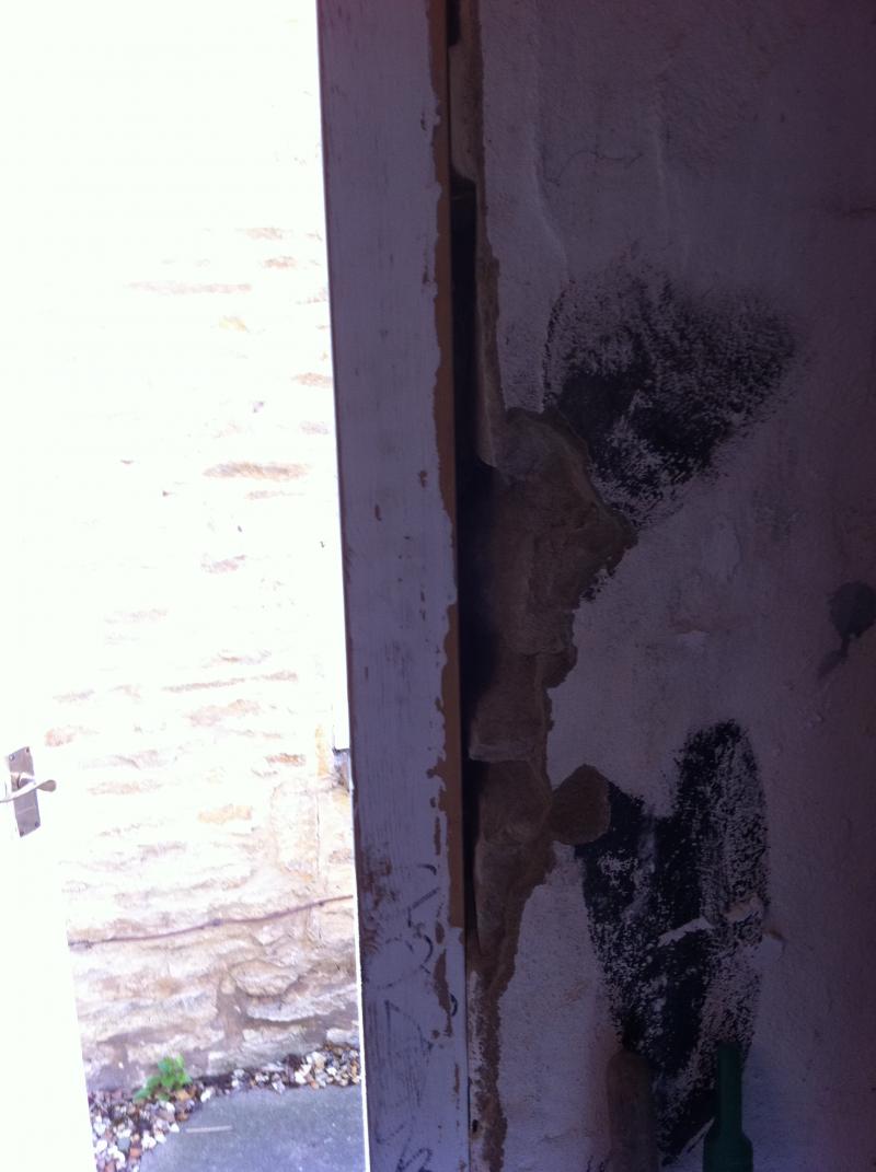

I have a loose door frame. On one side the mortar (?) is holding it on OK, on the other its all come away and the frame is very loose on that side. The other side of the frame is stone which is hard to drill into.
Any ideas on how to make it stay in place?
Pics attached
CHeers
Neil
Sds drill should sink holes easily, maybe time for a new drill.
Or you could rake out all the mortar and inject structural expanding foam.
SDS drill and some plug-less fixings like tapcons or spax, jobs a good un!
