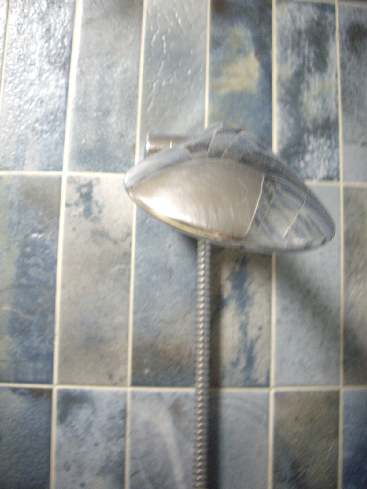

The bracket holding the shower head has come loose, although the screws fixed into the bracket are tight - how can i make the bracket secure so the shower head doesn't keep dropping down?
shower head

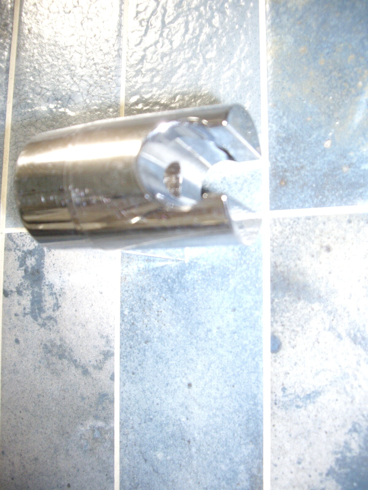

Bracket.
Do i have to unscrew the bracket and replace?
Bracket.
Undo the screw, holding the two parts of the bracket together, then add 'something' between the two friction surfaces, before reassembling. The something, could be as simple as a bit of card cut from a cornflake package.
would plastic be better in that place?
I think i have just the thing, thanks.
All i have to do is hunt through a box of assorted bits and bobs to find it.
