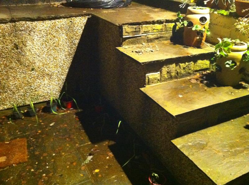

Hello, was wondering if anyone would be able to offer some advice... After the recent snow and ice the top stone paving slab (2.5foot by 1.5 foot) on my garden steps has come loose, there is a 4ft drop to one side to the patio, obviosly this is a bit of a risk!
My concerns are around ensuring it is not loose once fixed - does any one have any advice on what mix of cement to use and whether it will be possible to re-lay it in frosty conditions?

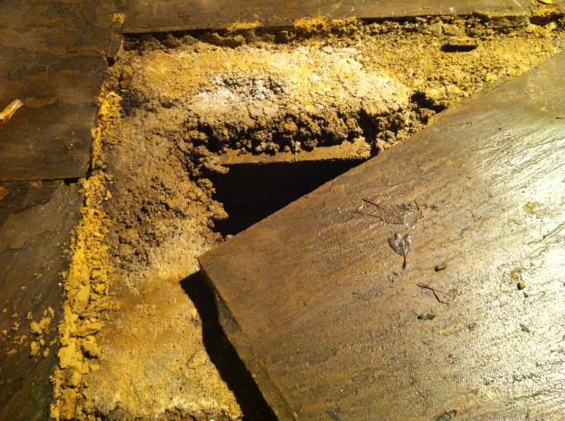

It looks like there is about an inch and a half of sandstone coloured mortor underneath it and its brick / breeze block under that with an 8" x 8" cavity in the middle.
Thanks in advance. Dave
You will need to replace that mortar. Knock it away with a bolster being careful not to disturb nearby slabs. Then make a mix of 3 parts sharp sand to 1 part cement and dont make it too wet. Lay the slab and level. Use a rubber mallet for levelling so not to crack the slab.
cant tell from the picture if there is pointing in between the slabs. If so make sure you clear that aswell before laying. replace that with 3 parts builder sand to 1 part cement. (you can use building sand for laying the slab too if its easier) Match it up depending whether it went in dry or wet. if it look smooth will have been wet, If more granulated was probably brushed and packed in dry.
I wouldnt lay in frosty conditions. 5 degc + is best
