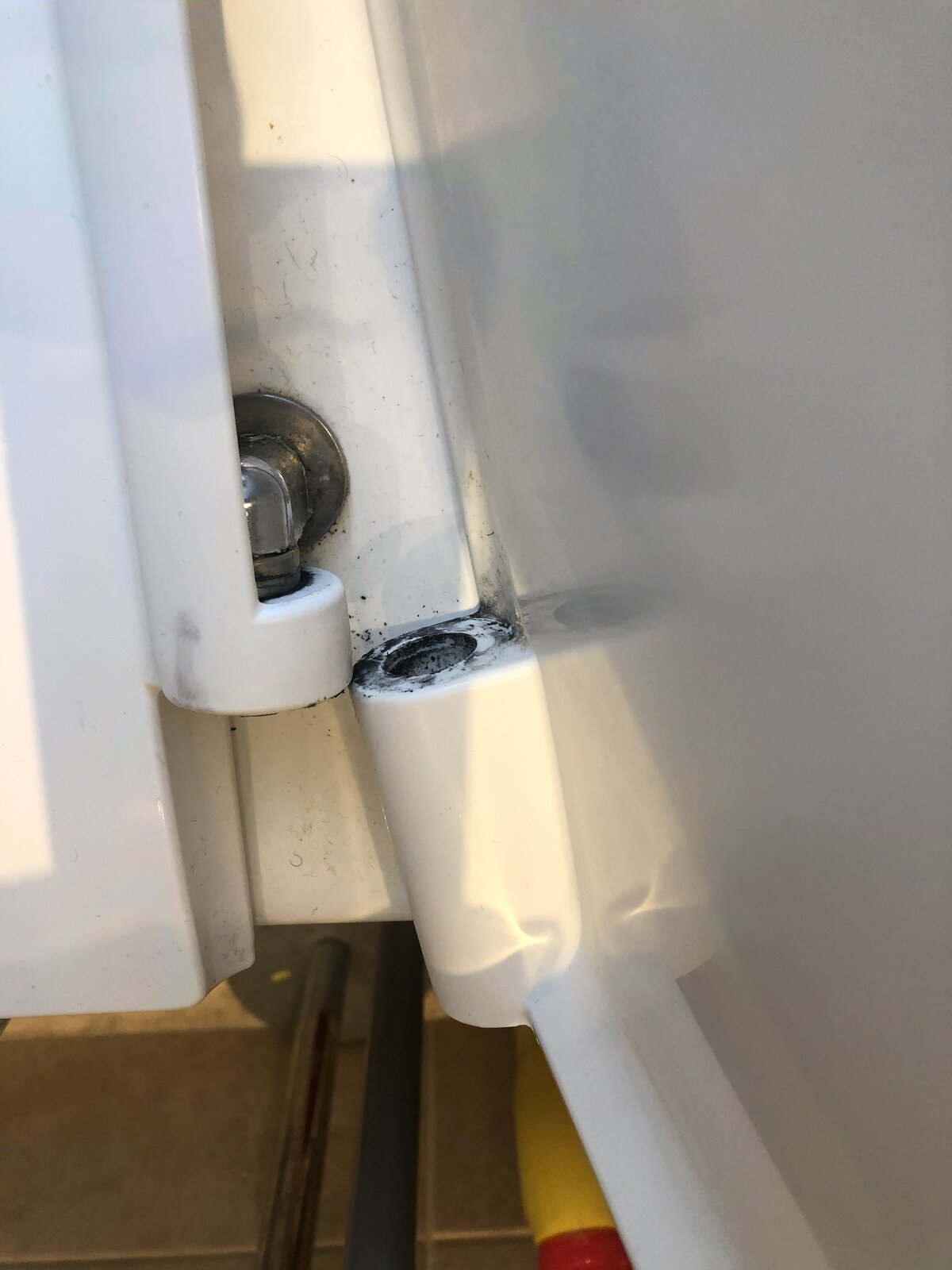

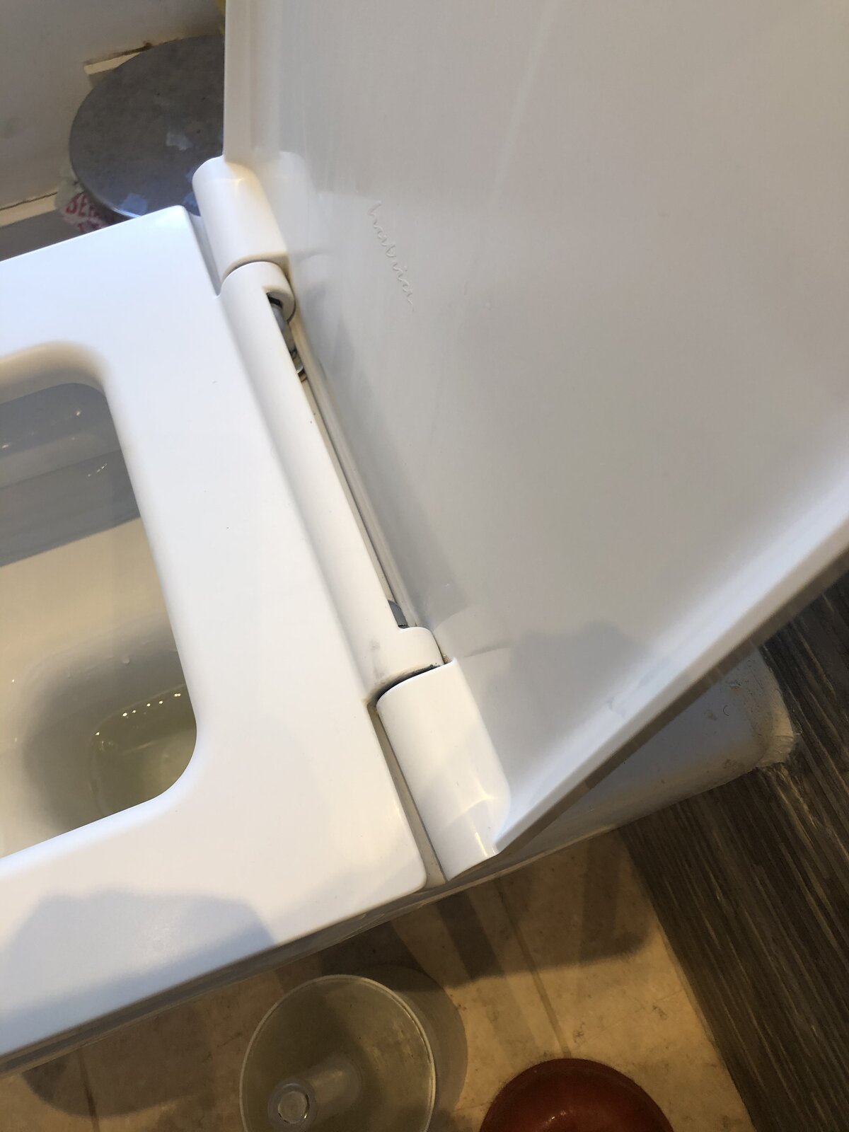

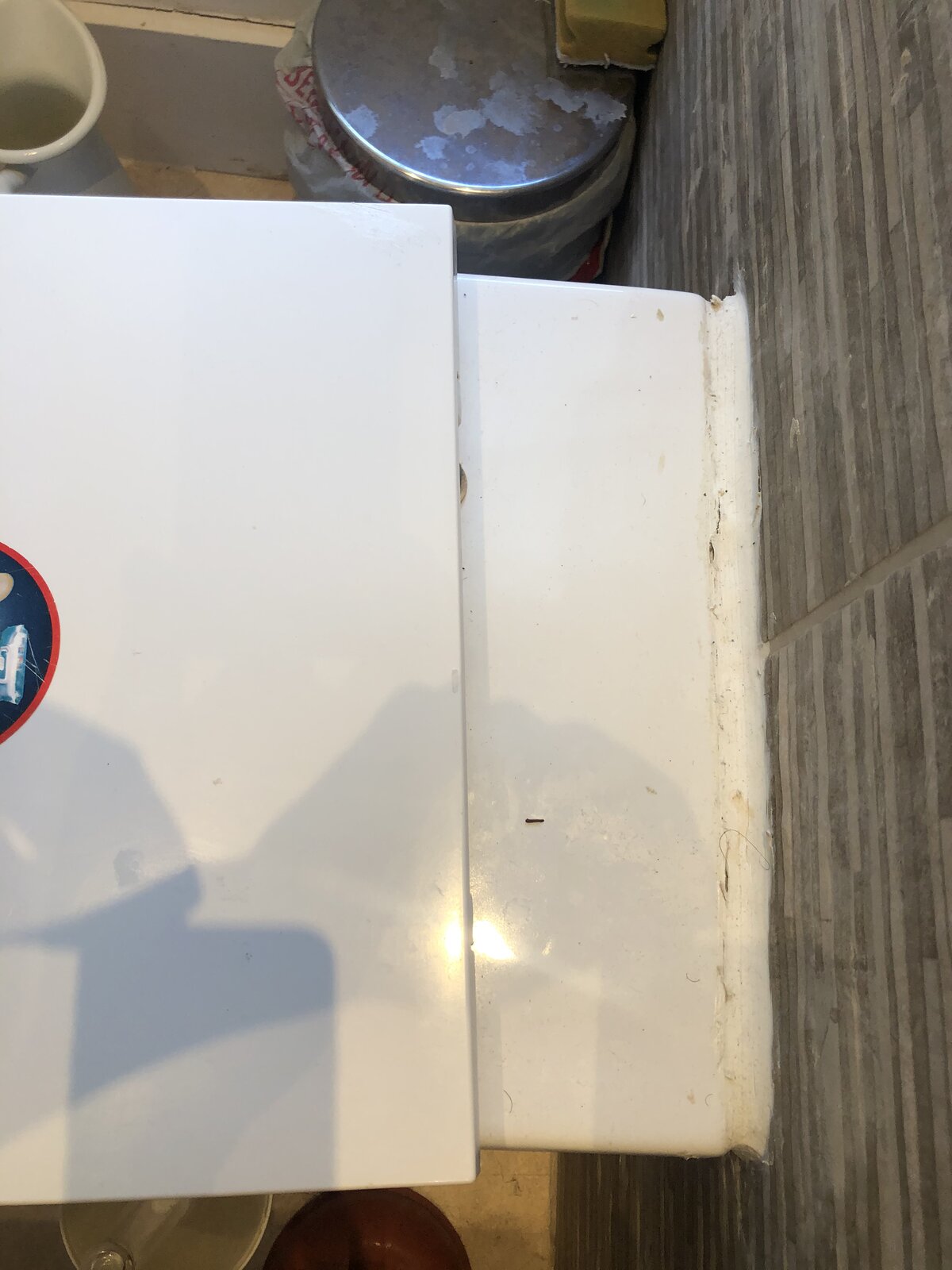

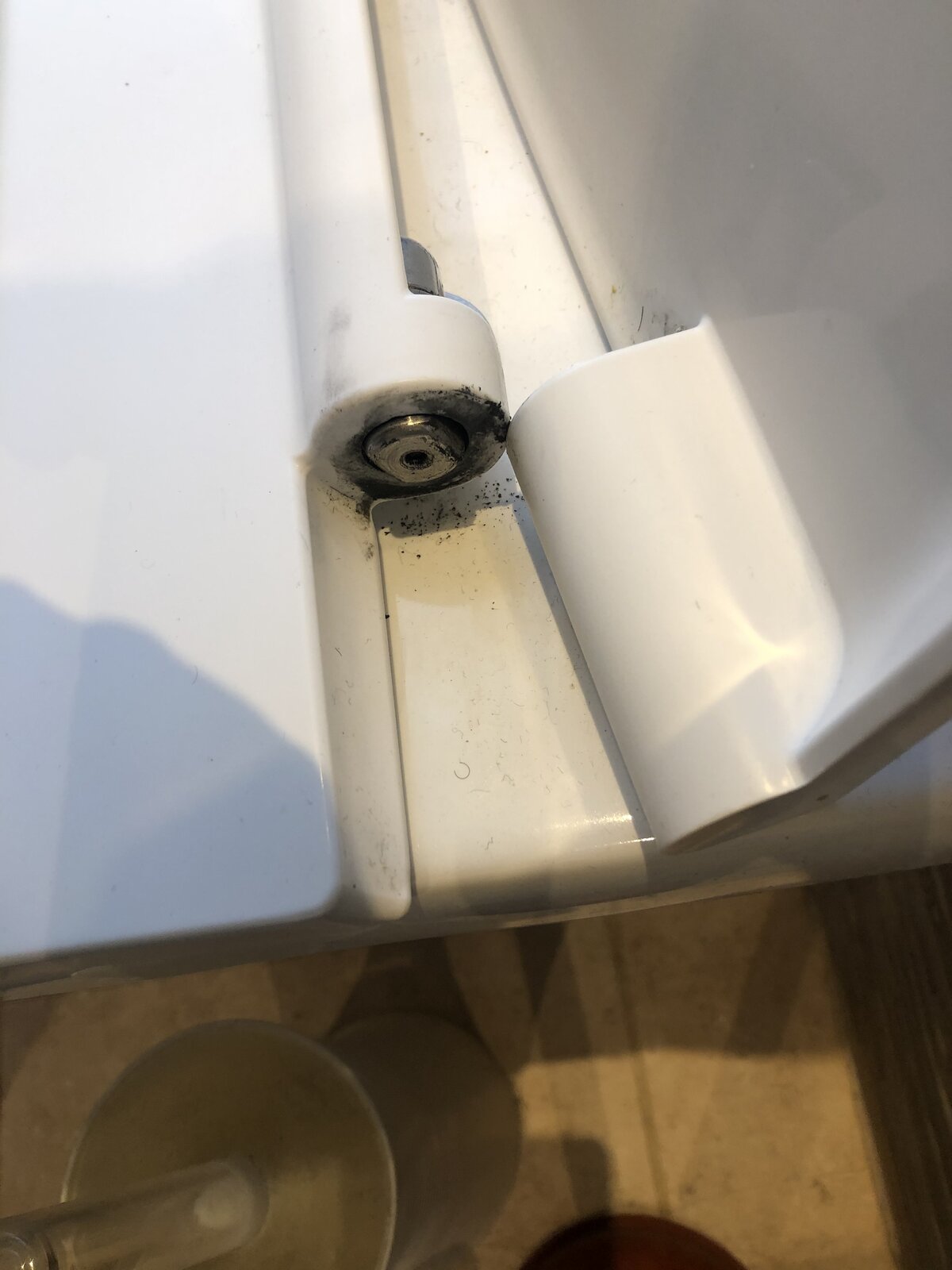

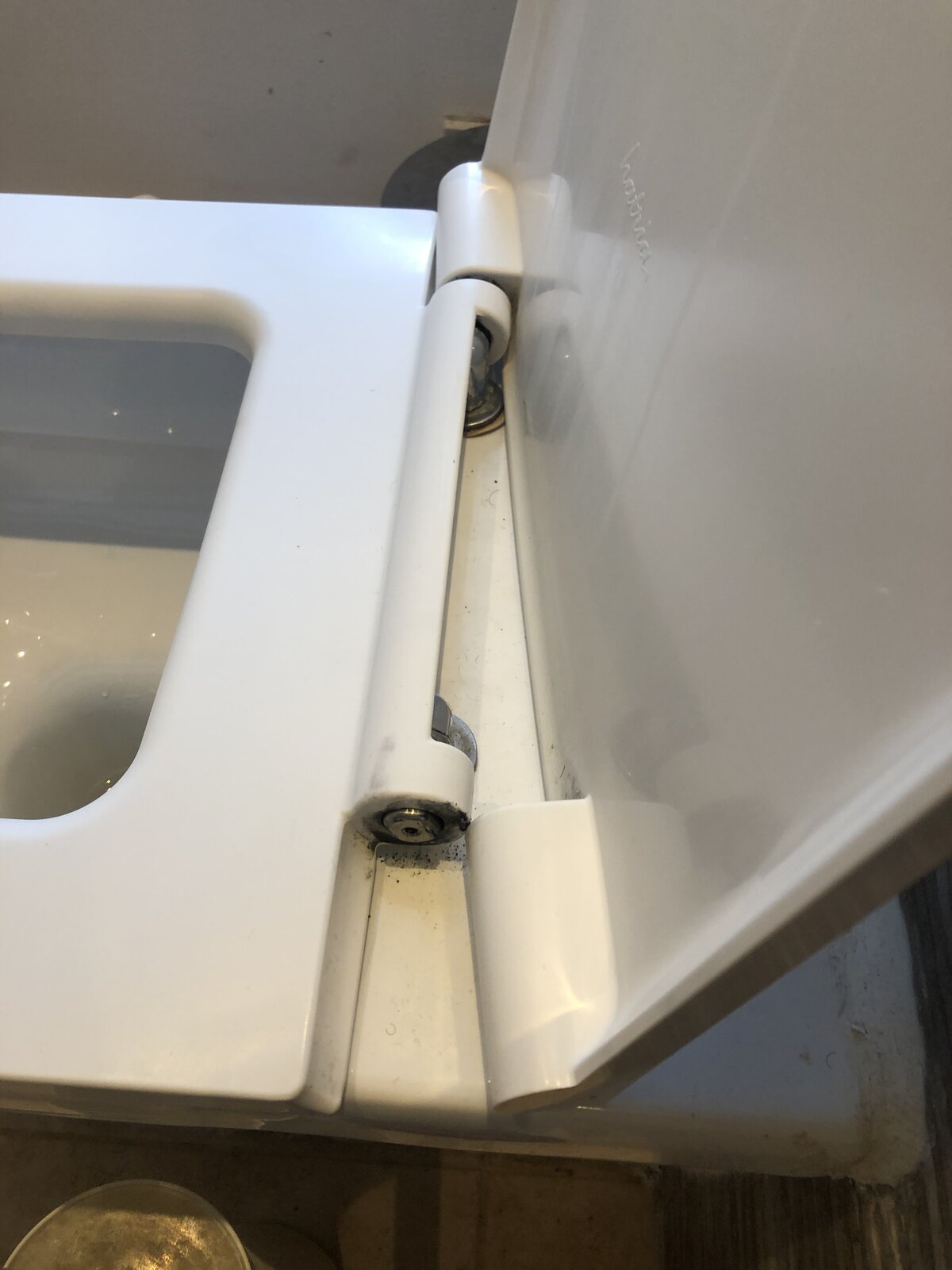

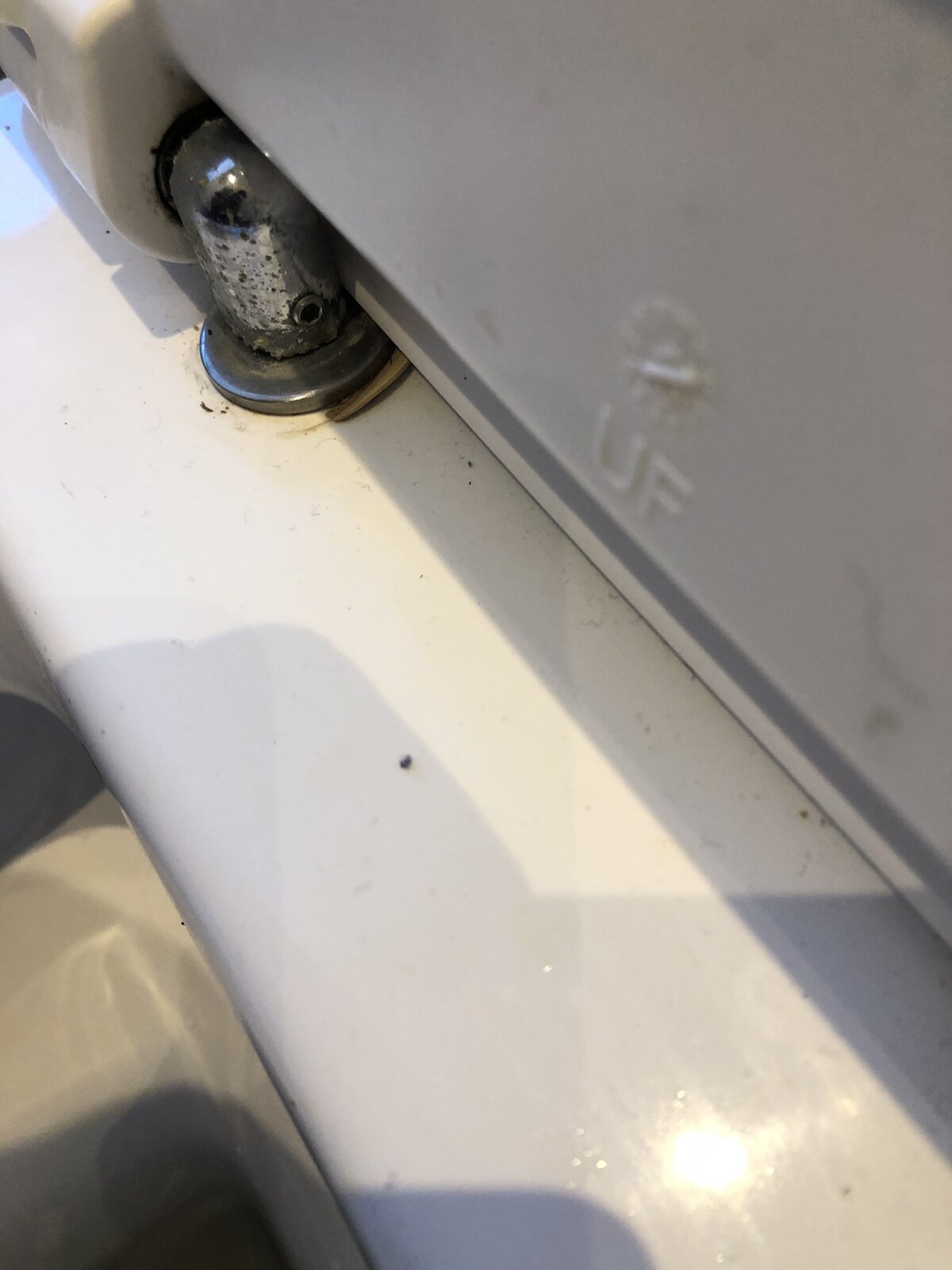

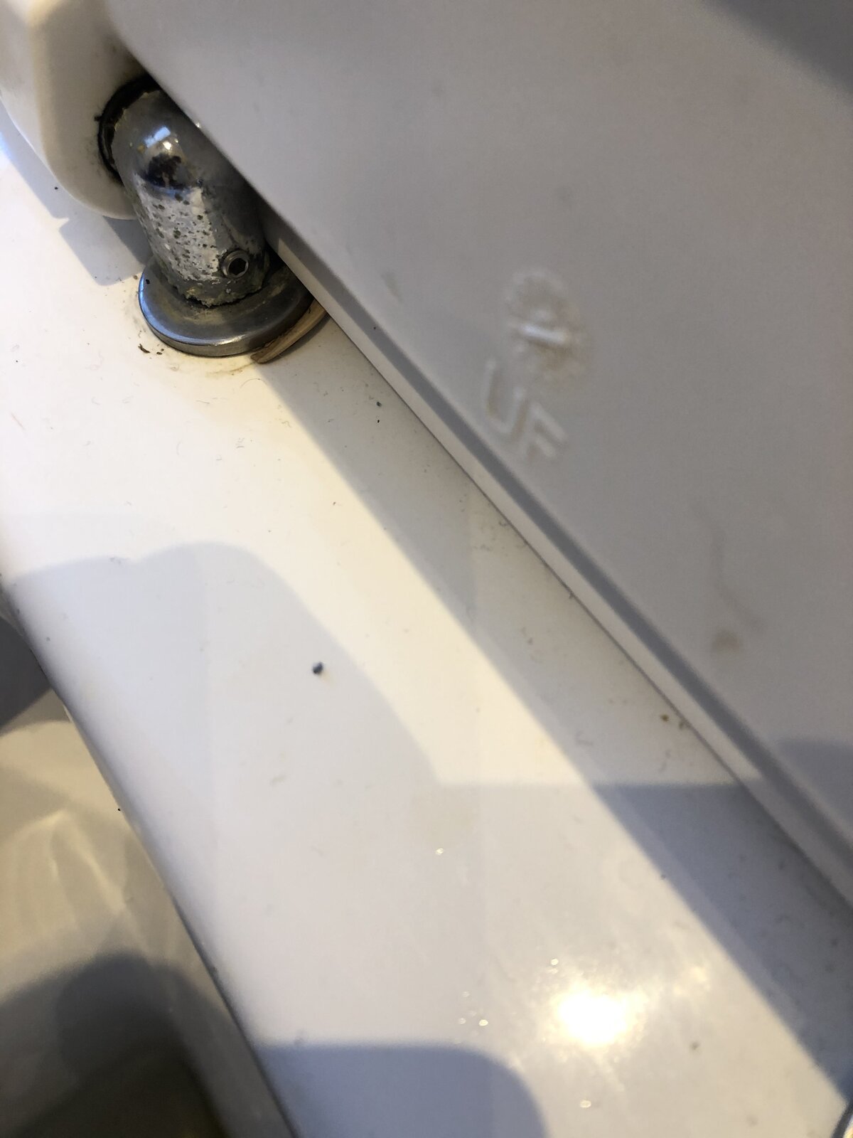

Hi, anyone know how I can fix a loose toilet seat, there's no cap to remove where fixings might be hidden. I’m stuck.
It’s not possible to look for nuts underneath as the toilet structure conceal anything underneath. If there’s any YouTube clips or other links you can advise me to explore, please do share.

You need to undo the little grub screws shown in pics 6&7, then the seat will come off, then you should be able to remove the chrome caps and underneath I think you'll then see a screw that you can undo which once undone will allow you to remove each side.
Ok, great will give that a try.. I’m hoping it will allow me to tighten the seat, as it is too loose currently. Thanks a lot!
