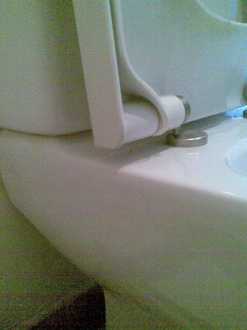

One of the hinges on my toilet seat has become loose.
This may sound simple, but I can't work out how to tighten it!
The picture below shows the design of the toilet. I can't get my hand far enough around the back to reach the underside of the hinge, and I can't see a way to tighten it from the top.
Any wise advice available?
some don't tighten underneath.
some sit in a blind hole and under the chrome cover is how you tighten them
Flip up the round chrome bit with a small screwdriver and you will see a screw to tighten it down.
Thanks for that. I can't manage to shift it at the moment; I think a bit more effort might be needed :)
be careful as it may be one that screw on the underneath can you not use a small mirror to double check.
