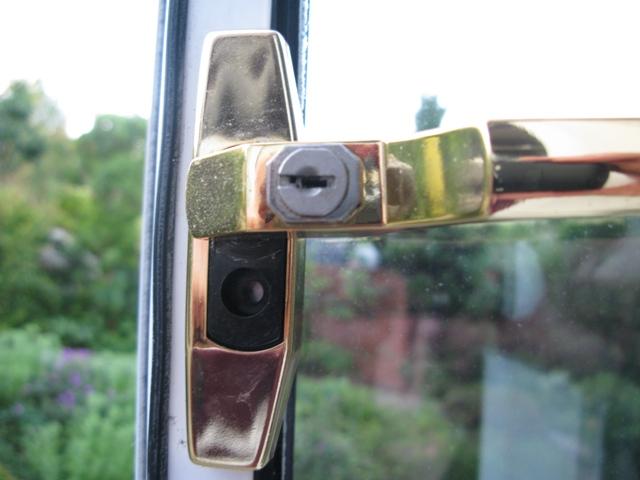

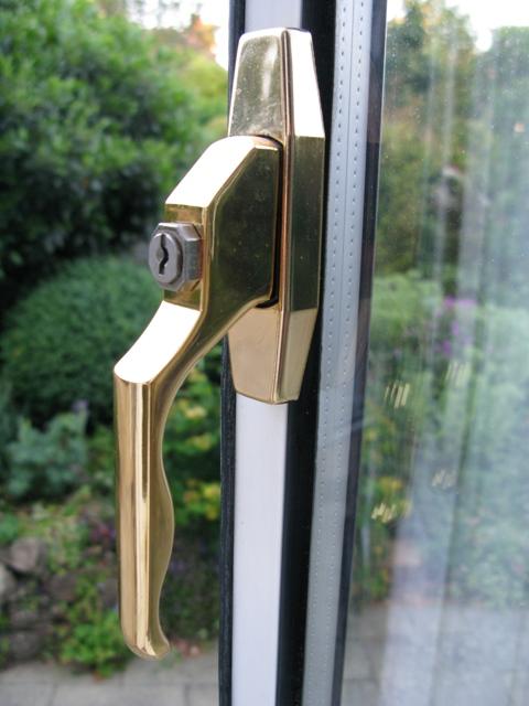

Hi experts,
Several of the handles on my double glazed PVC windows have become loose. At least two of the handles have become so loose they feel as though they may come right off.
For the life of me I can find no handle screws to tighten, and there are no cover plates that I can see. I believe the windows were installed by Everest about 10 to 15 years, before we bought the property.
I attach a couple of photos to give you a bit more info. All ideas welcome!
Wow, never seen handles like it :eek: but unless they're held on with double sided tape ;) then my guess is the back plate comes away (with the handle in the locked position) to reveal the screws
Excellent - you are right!
The back plate does come off to reveal 4 screws. All handles are secure now.
Cheers

Hi William in Surrey. On the off-chance you get an alert to this thread, even though these posts are years old... I have the same window handles as you (via Everest) but in white, supplied in 2001. Everest refer to the handles as "MK3 design x" where x has various values - but the handles all look identical to me! Apart from left and right handed versions ... and any key supplied fits any lock... I now have lots of loose handles and can't access the screws to tighten them up. Can anyone explain how to access the screws? Everest charge £70/hr to come out to look!
Get a knife or a sharp implement and with the handle pointing down (locked) pry the backplate towards you away from the window
