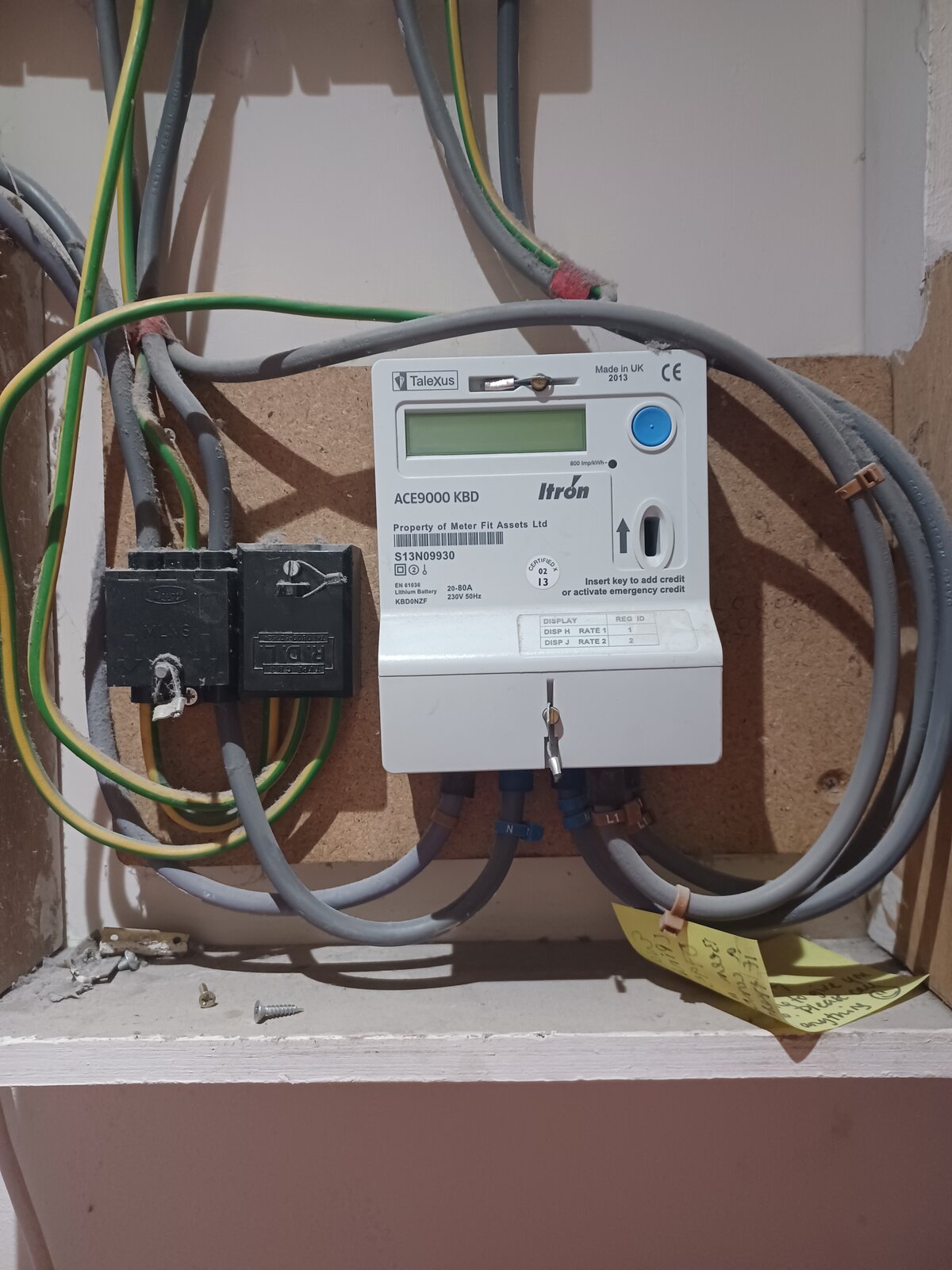

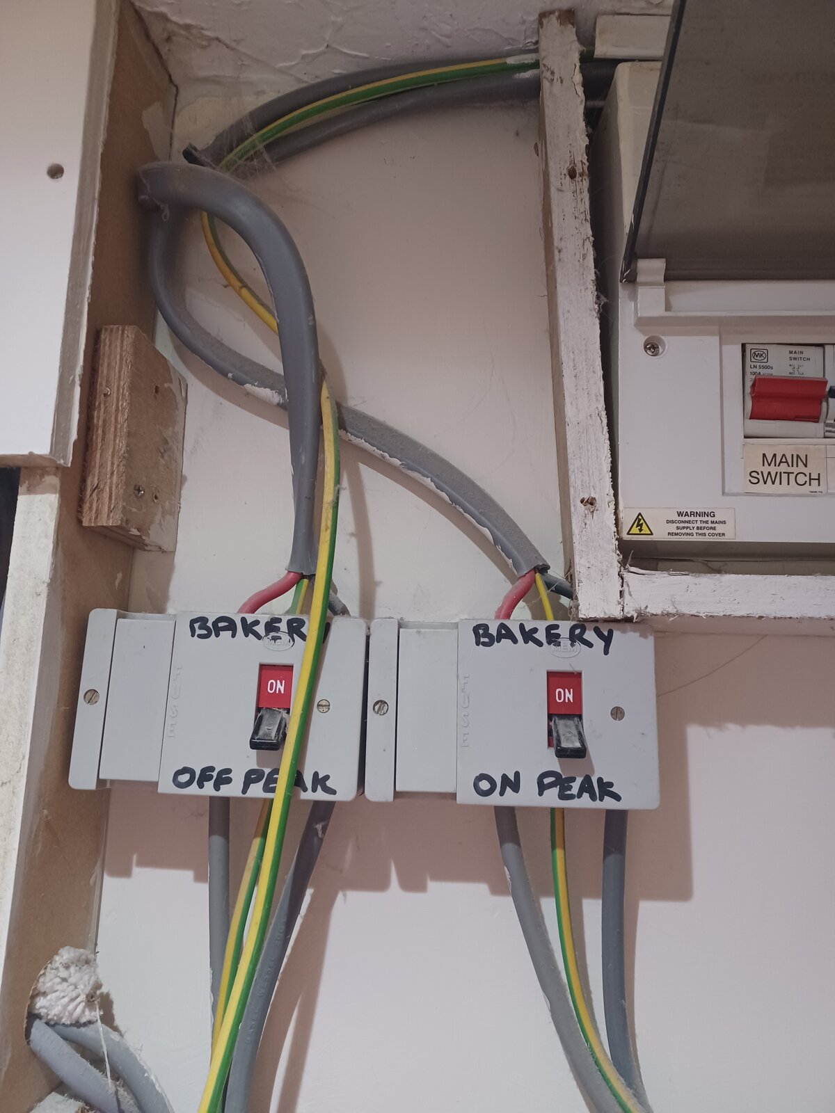

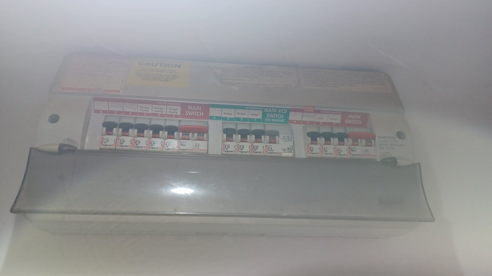

Hi All,
I have a problem no one can seem to answer fully. Recently we had the power line to the house replaced as they were old and deemed unsafe. When they switched the power back on our key meter just had a blank screen we also lost power to our storage heaters at night (they don't come on at all anytime). Has anyone come across this, if the meter is blank will this cause it, EDF say it can't be and won't send anyone out till end of November as we still have power just not heat. Any help would be grate.
Matt

Meter has failed. You have power to normal circuits as that's always on, but the heater supply is switched inside the meter, and therefore won't work unless the meter is also working.
If heating is required before a new meter is installed, an electrician could connect the heaters to the daytime supply.
Your meter has (somehow) forgotten that it should be switching on the off-peak power during the off-peak hours, which will charge the storage heaters. Sounds like a job for the meter-fitters, to put in a new off-peak meter.
Mention to them that you won't be paying them until they sort it out - I expect that will do the trick.
