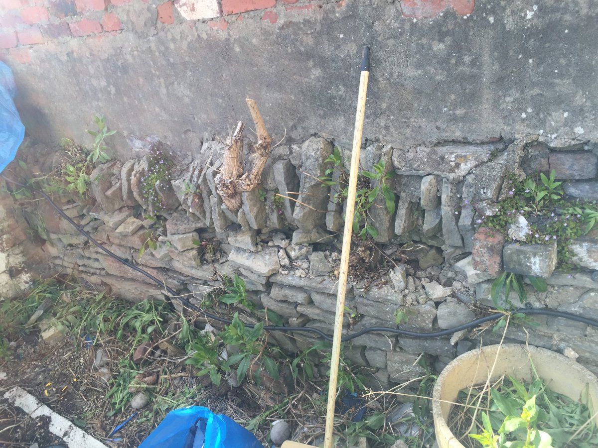

Hi guys looking for a cheap but lasting solution here?
I have a neighbouring wall and a lot of the "stone" in a stone wall is lose and I can move it by hand but my neighbour insists he does not want the wall to be knocked down, my side looks awful and I'd like to render the face of it to secure it, but it has gaps missing in lots of places.. Any recommendations on a solution?
I was kinda thinking
A: just fill the thing with a load of expanding foam, cut it into a wall shape when dry and render it?
B: shove a lod of cement on there and some lose stones I have got just to make it level for the render
I'm not looking for it to last 100 years but obv don't want it to fall apart a year from now either
Thanks in advance for any tips with this.

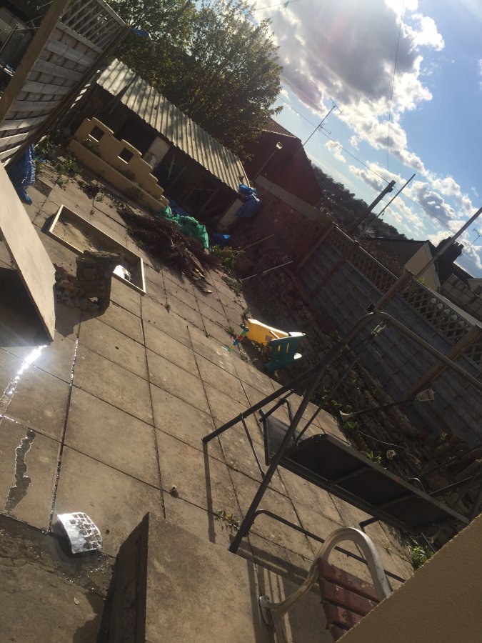

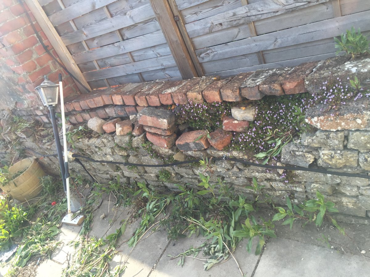

How high and for what purpose is that other brick wall in pic 3? A pic from further back might be useful. or wider angle.
It looks like the wall's been raised at some point, by a bodger just stacking a few loose bricks on and spreading some mortar around.
Dig out the loose soil, etc. Fill in with bricks/stone and mortar. Then render.

I'm afraid the only pic I have of it a bit further back is this one where you can just about make out the wall on the right hand side
So someone has built another wall on top of that stone wall? Without taking off the capping stones?
Sorry I see what your asking now, that bit at the bottom is next doors garage, whether it's built right next to it or on top of it I have no idea as it would of been done way before my time here
EDIT: it would seem after a second look that your right, it appears the garage was just built on top of the walls that were there
It's not surprising your neighbour doesn't want you to touch the wall!

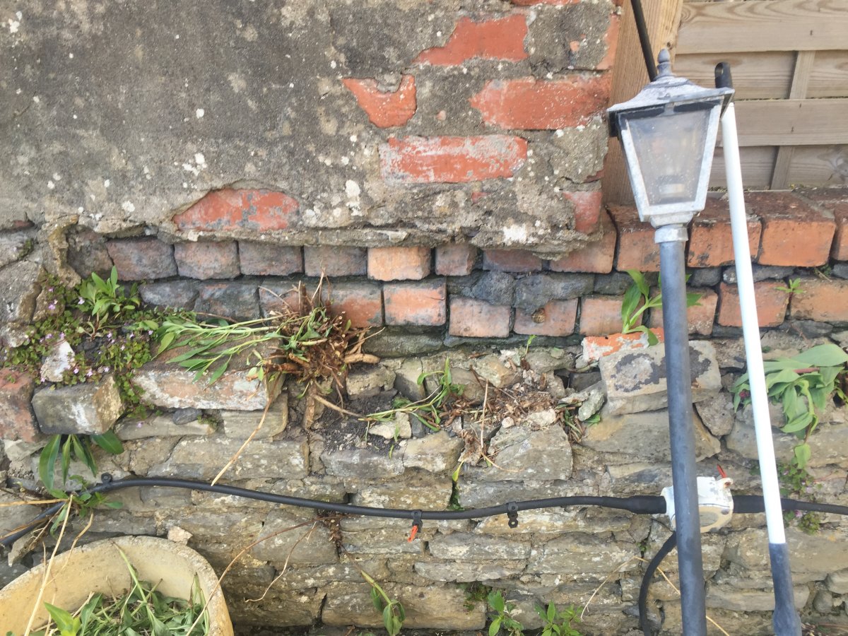

It's a right bodge up. That bit of the wall is the foundation for that corner of the garage. And it looks like it's starting to collapse! Pic 3.
Either put up a safety barrier round it and keep away, or bring your neighbour round and insist it needs attention!
Or build a new retaining wall to support that original wall.
Or.................;);). using a long long crow bar, or similar, (and loads of PPE) slowly remove a stone per day without your neighbour knowing, until that garage wall falls down, then it'll have to be redone properly. Be prepared to run a mile! Or better still, be out, when it falls down.
What kind of roof is on the garage? If it's a concrete roof, it could slide into your garden and probably do anyone in the way very serious injury! Not to mention the collapse of the masonry!
I'd suggest some more pics of that garage wall and roof and some advice on what to do next.

Either just let it all collapse as Himaginn said or alternatively
1. Clean the wall right out. Make sure you remove all soil/plants etc - plants ruin walls as they grow!
2. If the wall is very dry, splash a load of water on it.
3. Use bricks and mortar to fill in the more level gaps.
4. Use a concrete mix to fill in the smaller 'holes'
Once done, it won't look very neat as you'll have bricks and stones of different colour and sizes all over it. I'd render it and top it off with some sort of copping.
Don't fill it with expanding foam, it's not the right way of doing it and it won't help the structural integrity of the wall.
