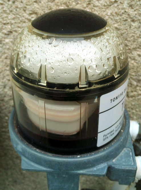

lot of condensation in top of Tigerloop device - is it normal?
17 Oct 2005
146
Ireland
I photographed our Tigerloop the other day - seems a lot of water/condensation in the top of our Tigerloop, does this look normal? - I've never had a Tigerloop before so i didnt know if its normal? is that what is supposed to happen? or could there be some water getting into tank or oil?
- I thought the Tigerloop was there just to separate the air from the oil or does it seperate the water/condensation too from the oil?
Looks like you may be pulling a bit of water through get some water detecting paste on the end of
a stick or brush shaft and dip your tank if it's about 2-3inches deep then it needs getting rid of
if it carries on you'll need a new oil pump.Bob
