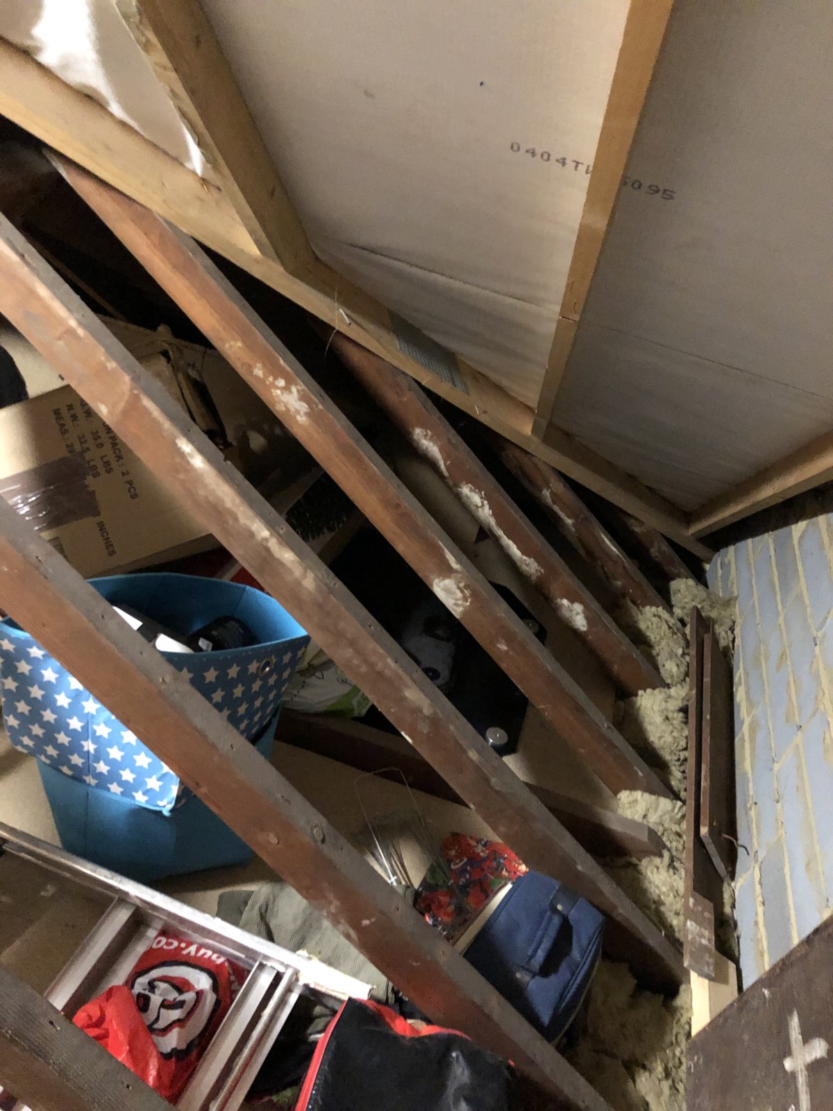

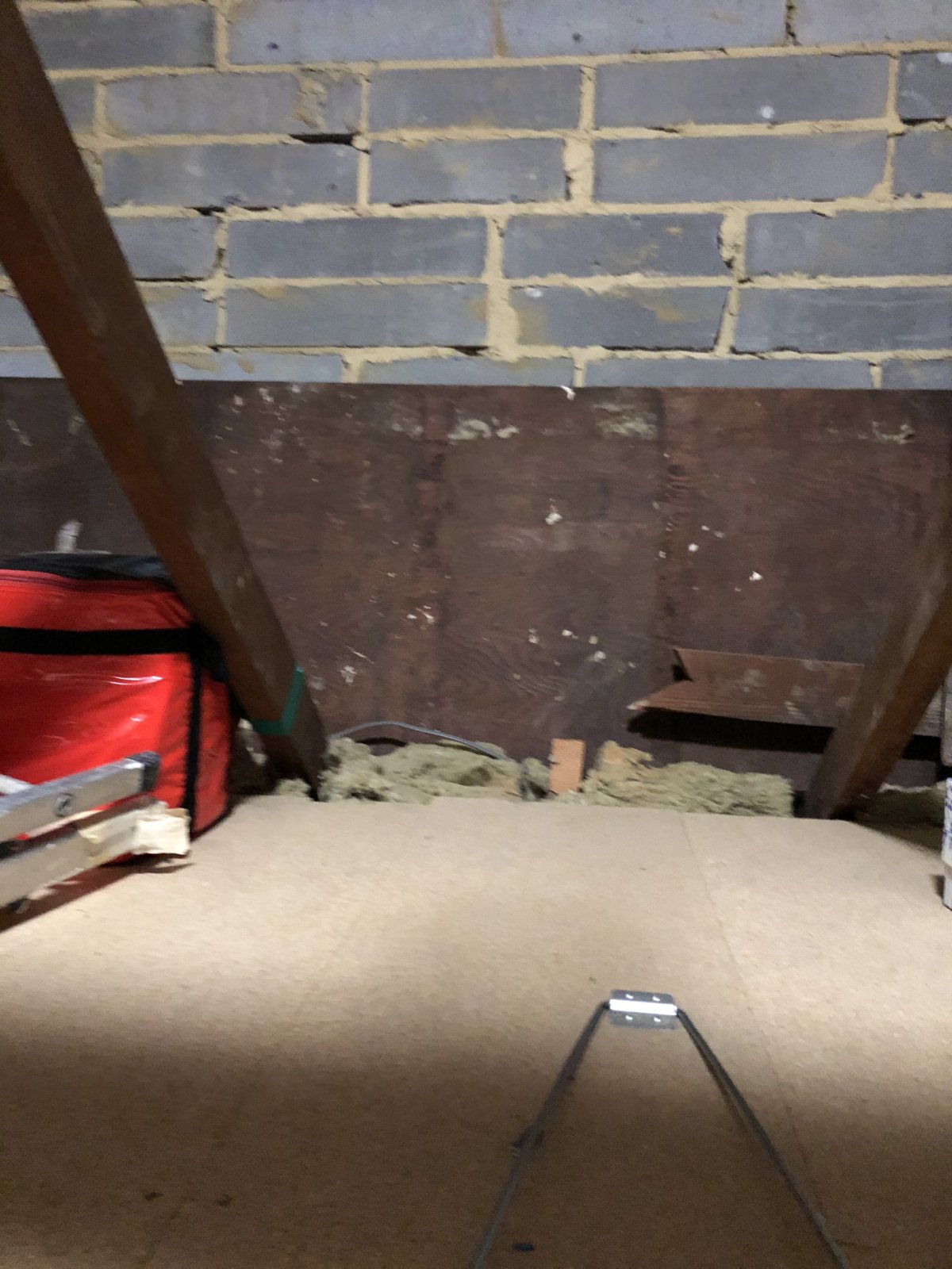

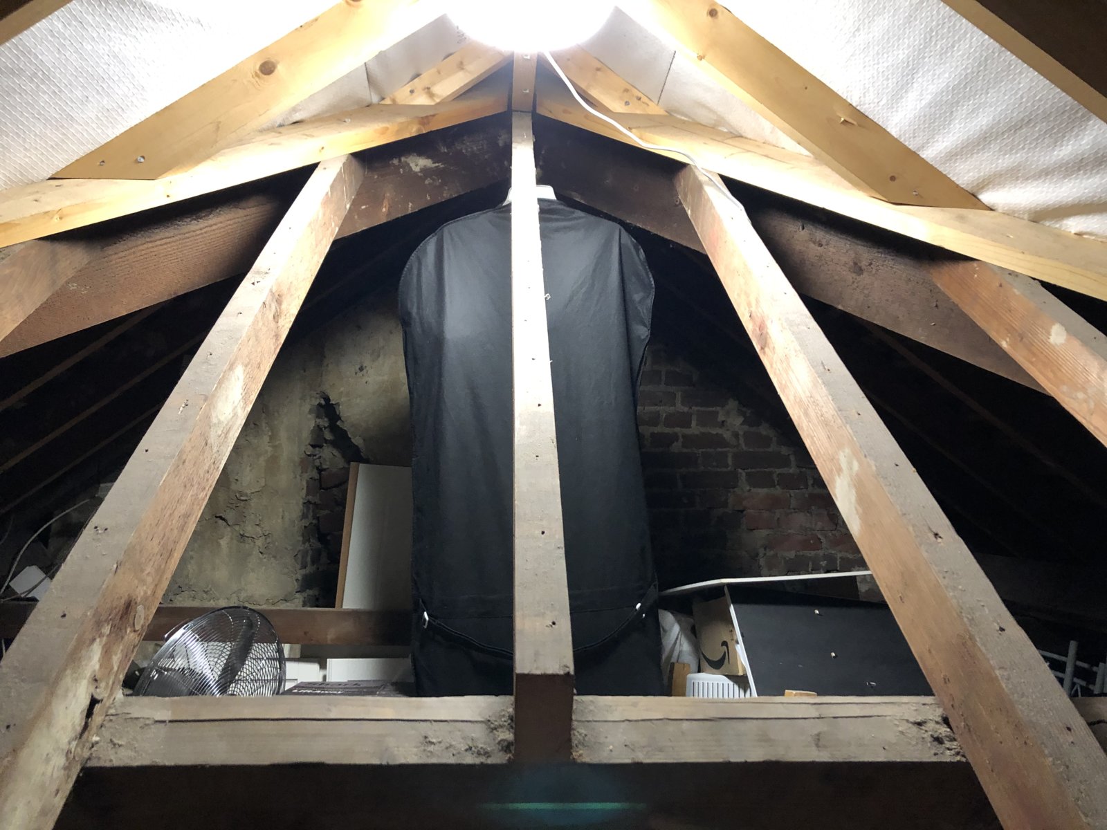

If you can provide a photo(s) of the roof timbers it might be clearer what was done.(obviously)
Have tried to upload photos / video. Not sure if this will work A’s still getting used to forum use.

Think I’ve managed it. It’s lovely to find a helpful forum.
In the last photo I’ve noticed it looks like someone previously has simply just cut a plank of wood out... to be able to get the ladder to fit.

They have just built the new roof off the existing hipped roof construction which is supporting the new roof. You will need building regulations approval
for a loft conversion and the structural alterations to the roof timbers ,
a structural engineer's input will be necessary anyway and they will design the new roof structure.

You definitely need a structural engineer, I can't make out your roof construction type from the photos, but changing a roofs construction type is not trivial, roofs support a lot of weight.
You will need to start again with a full size ridge beam.
The roof will need to be removed at least back to the end of the existing ridge .The new roof could be supported by a ridge beam but see what a structural engineer recommends. Before that , are you sure there is enough headroom for a loft conversion :?:
