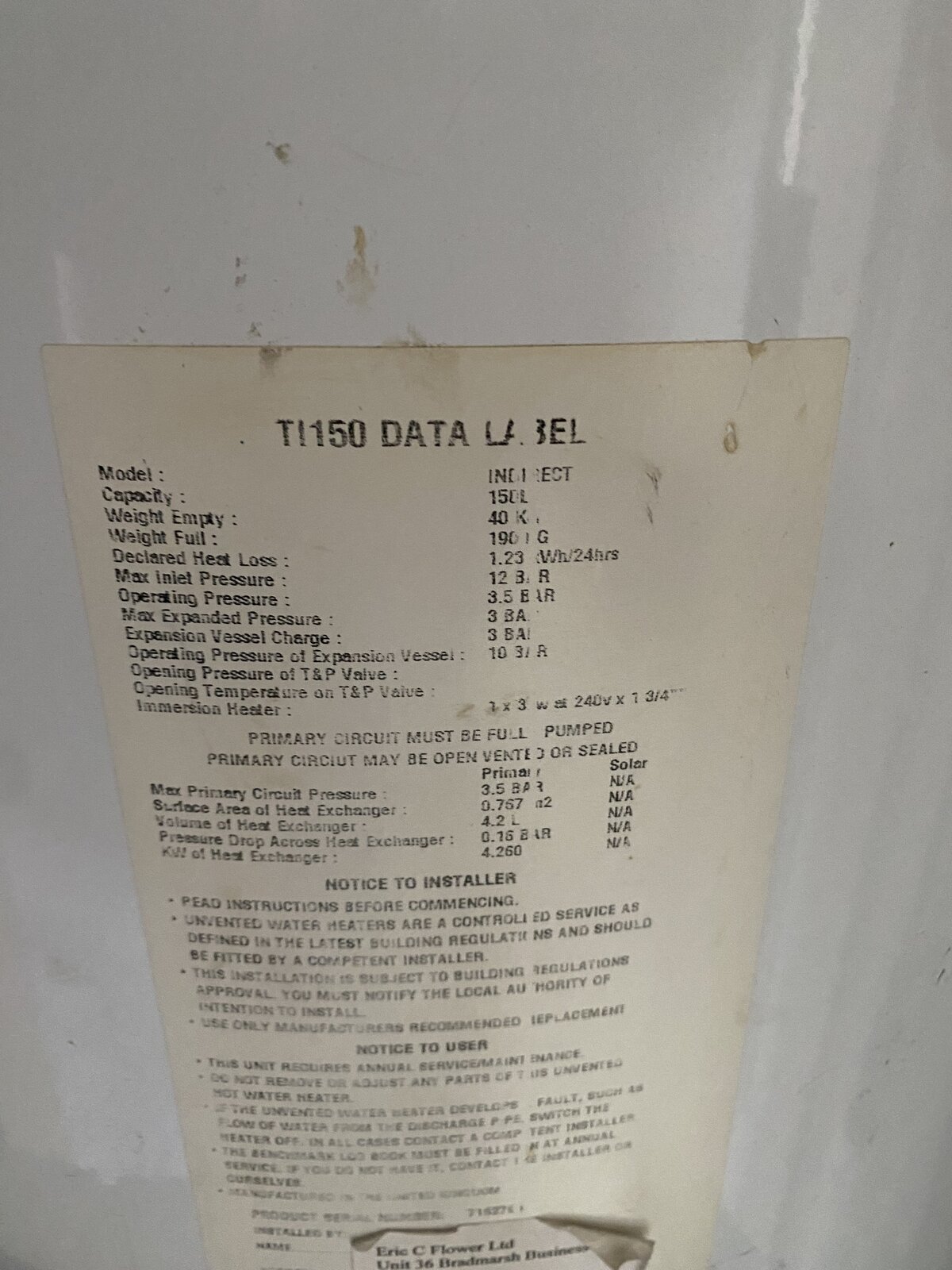

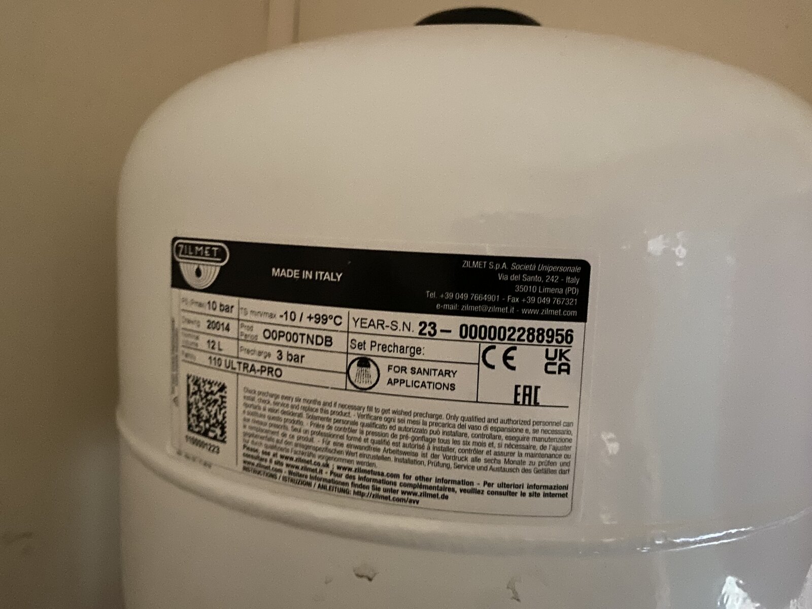

It’s a Range Tribune HE cylinder, I’ve attached the specs if that’s what you mean by volumes? Sorry, I’m a bit green on this! Not looking to attempt a diy job, just £500 in with a plumber and still have issues so want to understand for when I get the next one in.

I probably should have said capacity, you have a 150L cylinder and a 12L EV which should be fine, if the whole cylinder is heated to 65C then there will be slightly less than 3L (2.75L) of expanded water in the EV at a pressure of 4.2bar which should again be fine, assuming the EV was properly precharged to 3.0bar., the noise you are getting fot this ~ 10sec is probably this 2.75L of water coming from the EV through the tap in falling from 4.2bar to 3.0bar. Seems strange to have changed the PRV, combination valve and the EV so you don't really know whats going on. You wouldn't be breaking any rules IMO if you have a tyre pressure gauge and just take the pressure at the schrader valve on the EV air end with no HW draw off and with that same tap opened, it might show up something.

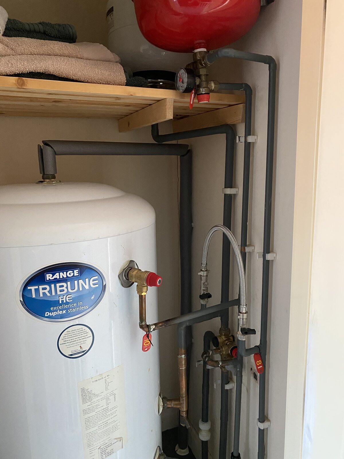

Not sure if hot water pipe is connected to EV, attached a pic for reference.
So in conclusion the pressure likely needs adjusting on the EV? I’m guessing this isn’t dangerous at the moment until I can get someone in?

As suggested it's usually the mismatch in pressures between the mains and the output pressure from the EV at that initial release of water from the EV when the cylinder is full and is fully heated, it stops once that pressure balances. Would it be fair to say you get a little rush in pressure too then it settles down?
Mention the symptoms to the engineer you call in so he is aware of what the problem is. Ask him if he has seen it before and has corrected it. That'll show he has the experience to sort it out. Too many times I've heard of people coming across this issue and it takes multiple 'pros' to visit till they finally get someone who has the experience to sort it out for them. Another thing I notice is some 'Pro's don't fit gauges to the control group when fitting, makes life so much easier when setting up, though that one would be easy to temp fit one due to where the loop is fitted.
