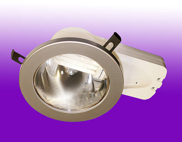

Hi, could someone help me out here.
I am currently renovating the house entrance portch and am replacing the ceiling. Because it is quite a low ceiling I want to put two downlighters in the ceiling and want to use the low energy variety. However, in looking for a suitable fitting I have become a bit confused. There appears to be GU10 CFL fittings and SGU10 fittings which appear to be very similar.
Could someone tell me what the difference is between them, which I should be going for and any pros/cons for each.
Many thanks
Russell
As you want a low energy solution, something like this:
http://www.tlc-direct.co.uk/Products/GLAT113E.html
would be a better choice for a hallway. Its 13 watts, and will reach full brightness within 30 seconds. A GU10 lamp takes about 90-120 seconds.
It has a 13cm cutout, twice as big as a standard downlight, but consider the extra light this will put out.
It says it comes with a lamp, though I dont know what shade of white it will be. You want warm white (2700-3500k) to mimic halogen. Various shades are available up to daylight (about 6400k)
