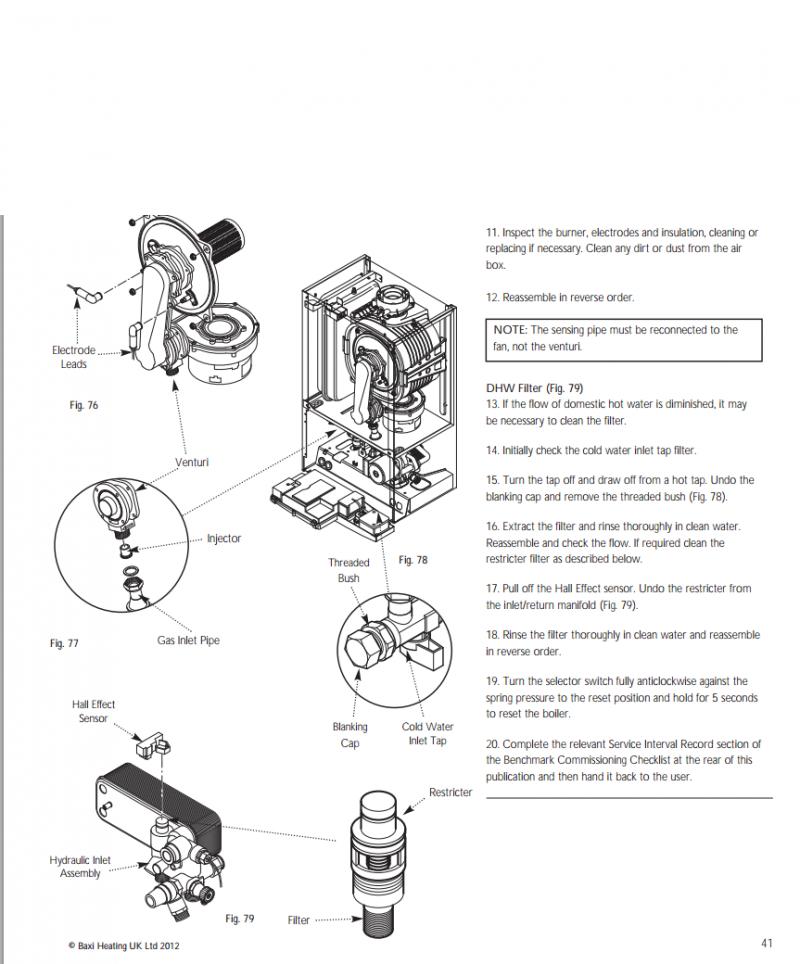

The noise comes from the inlet pipe , just after the switch to isolate the mains water.
Depending on the exact model there is a filter and flow regulator on the water inlet.
I suspect that the flow regulator has failed or become blocked.
Regardless of the exact cause that part will need to be carefully dismantled and examined.
It is unlikely to be the plate HE as your water is fairly soft and any scaling of the plate will have been a slow process over many weeks.
Its a tricky job and not something all engineers are very conversant with but is something a DIYer could attempt in theory although I would not advise it unless they worked in avionics or something related.
Tony
DHW Filter (Fig. 79)
13. If the flow of domestic hot water is diminished, it may
be necessary to clean the filter
found the above is worth asking a boiler engineer to check it for me because the one I called out was not sure what the problem was he said it could one of 2 parts and would he need to change both to find out the cause he wanted £320
It will either be the restrictor or the filter blocked.
Those kind of prices are stupid and probably covering his lack of experience of these problems. I expect it just needs cleaning at no parts cost.
Should be about £84.
