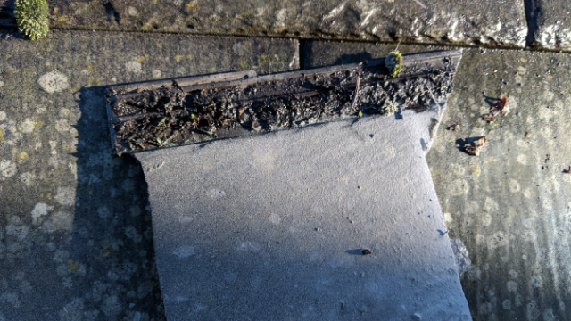

Has anyone had problems with Cambrian (or similar) reconstituted slate tiles leaking at low pitch (15 degrees). Tiles are installed with correct overlap.
If so, what did you do?

Yes I have had same problem - 17.5 pitch and areas where water seeps through tile.
I had Redland rep come out to inspect - he confirmed tiles correctly laid with overlap etc
Problem is tree and other debris getting into the interlocking channels and sticking and causing
rain to overflow the channels. Tiles are not really suitable if there are trees around.
Solution was to have areas of the roof pressure cleaned which is tricky as jet has to get
to channels underneath tiles - probably easier to use compressed air. However
still have some drips onto permeable underlay as debris builds up every year.

Cambrian are Redland, Melbourne are Marley, I have seen issues where the underlaying channels are damaged which you cant see without removal.. not easy!
Keeping debris clear off the roof is good practice anyway. jet washing under channels not for me! you already have an ingress issue without blasting it in.
Where is the leaking showing inside? ... Top Middle Or Bottom

Redland rep has been out a few times and said tiles laid correctly. He removed some tiles to check. Some of the side locks were silted up and I have trees around the house. No idea how they can sell a product if that is the cause of the leaks after only a couple of years.

cambchan.png cambtop.png 20 years under trees at 15 degree pitch

Not sure I can add much more. Tiles have been laid in accordance with specs. Sidelocks get blocked with tree debris and then leak only when it rains (so not condensation). Leaks all over the place but not all the time. Doesn't seem to be linked to temperature or wind direction either. The best you will get from Redland is the offer of free tiles.

The Cambrians here were installed in 2001 and started to give problems of water dripping
onto the permeable membrane about 2012.
The rep came from Redland and said the tiles were properly fixed but the problem
is tree debris that gets in between the tiles and stops the little gutters working
causing underside drips. The house is in a highly wooded area with lots of
pine trees which produce sticky residue.
The roofer we used cleaned the worst areas with jet spray and this appears to
keep the drips down although the membrane in certain areas can get wet.
