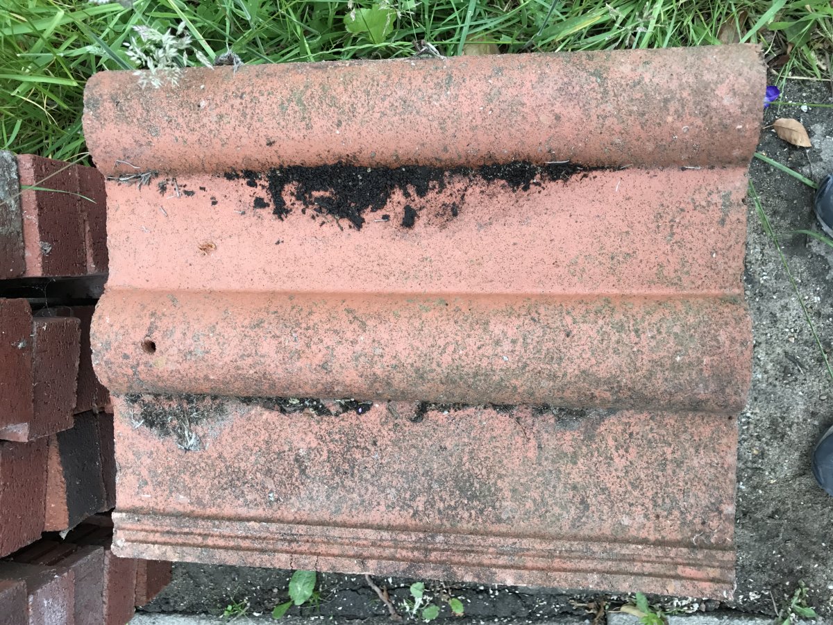

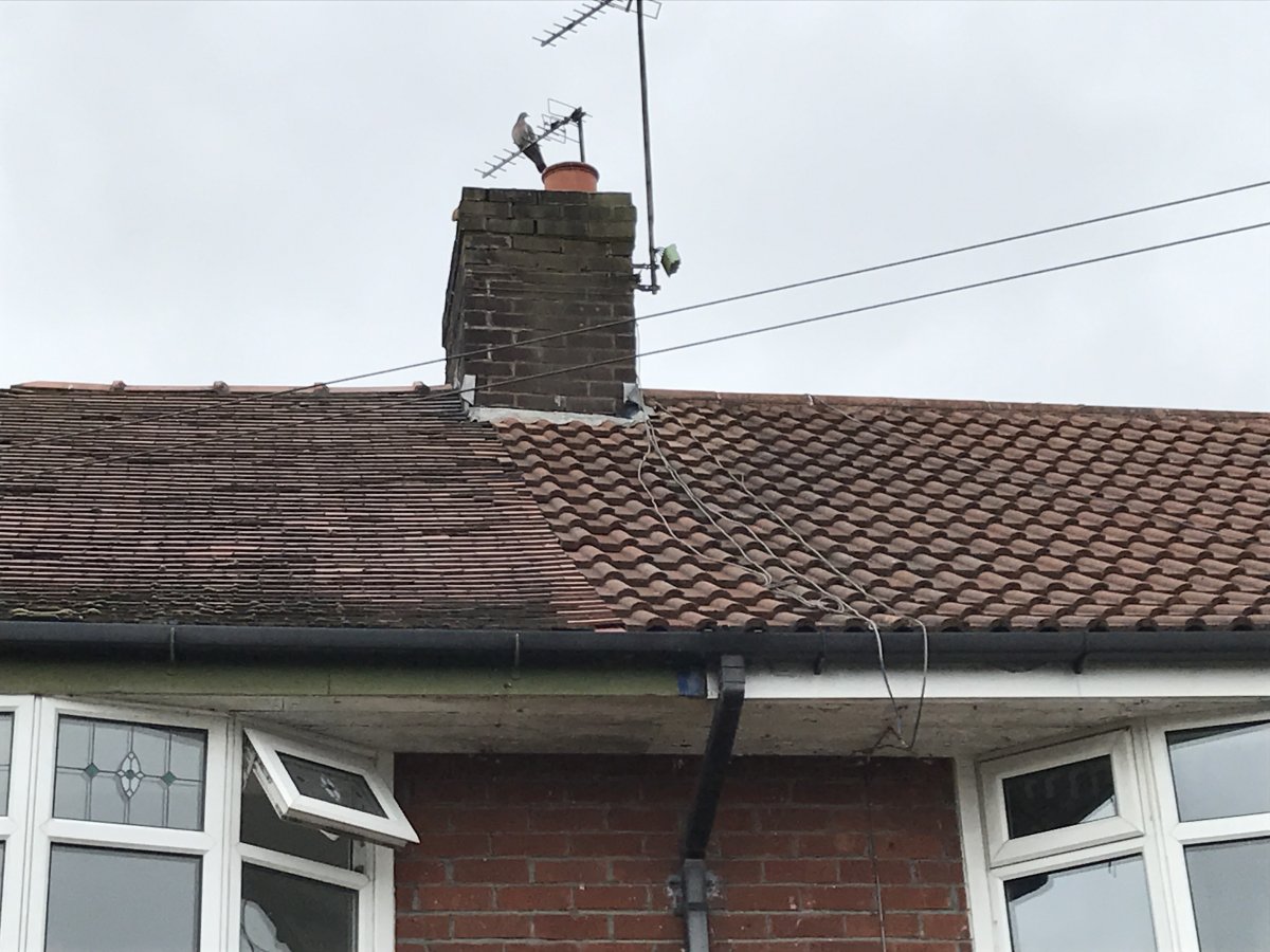

The neighbour has Marley double roman tiles which I would want to match, ours are poor condition Rosemary's at the minute.
I heard on another thread that Marleys spec of 22.5degrees relates to the rafter angle, but also heard it relates to the angle of the finished tile, which is correct?
Does anyone know which one of Marleys double romans this is:

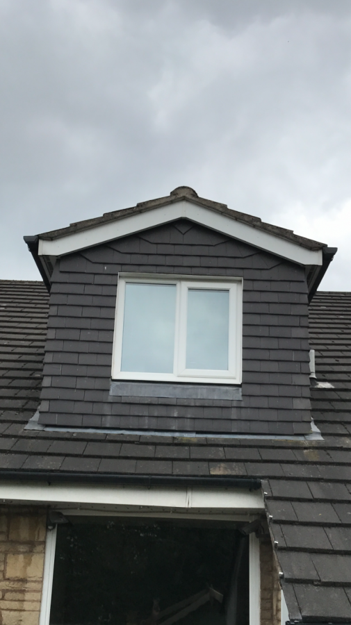

I built the dormer below with a differing pitch to the main roof. I thought a shallower pitch would suit the dormer better than that of the (steep) main roof.
Very nice :). Do you remember how wide you built that?
It's a little under 2200mm wide from cheek to cheek. You have to allow for about 50mm of celotex insulation across the face of the internal studs so plan this when setting out the window opening.
