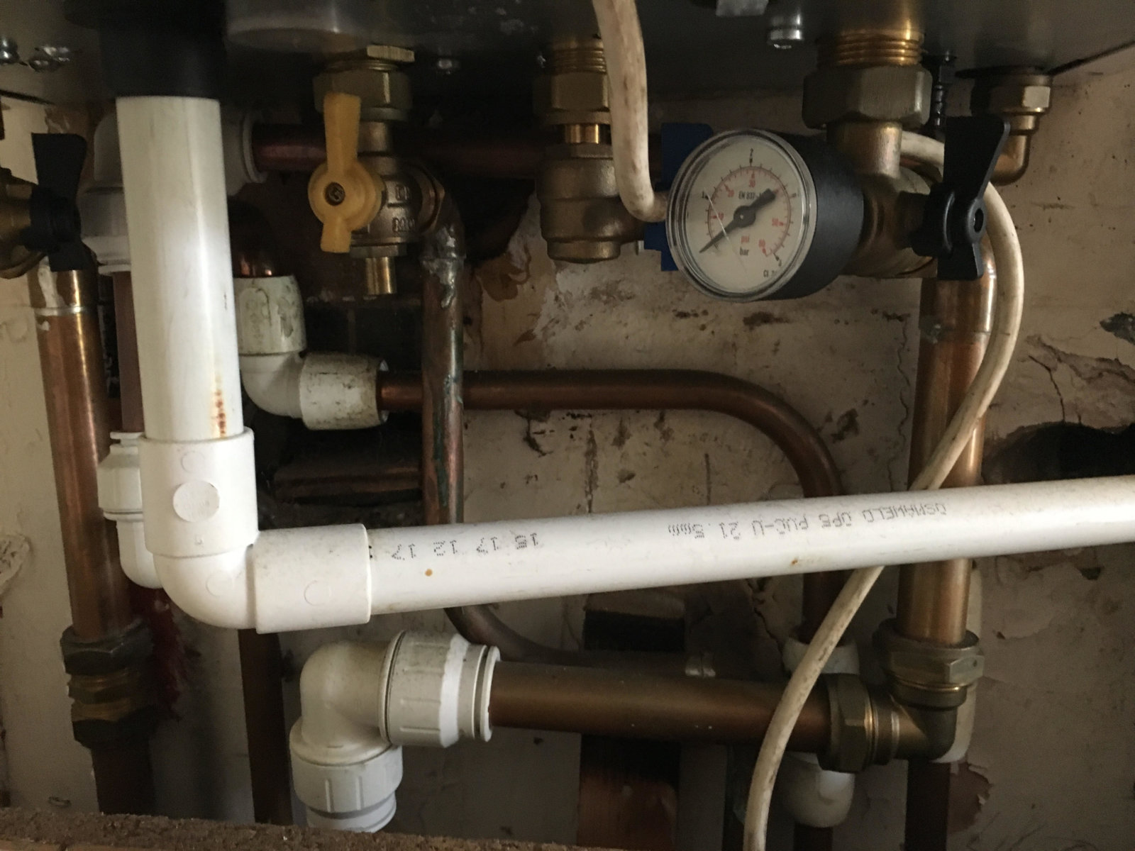

Which boiler is it..? Take a wide shot of it for me please
o_OIs it just me.....?o_O:whistle:
Edit: filling loops are over-rated!!
Silly question but does the boiler need to be on to adjust the pressure. The black one won't move even when unscrewed
What am i missing...?!
Ok, from your pictures it isnt clear where your filling loop is - if it were muggles would have said (y)
Ignore the black lever.
No - boiler doesnt need to be on for there for be a rise in pressure.
The filling loop will be attached to one of your central heating pipes (flow or return..) to the cold water inlet. You turn the water on at both ends and water will flow into your heating - and pressure will rise - you wabt it between 1 and 1.5 bar.
Its usually in an accessible place... but having had a scan of your pics it isnt in an overly obvious place.

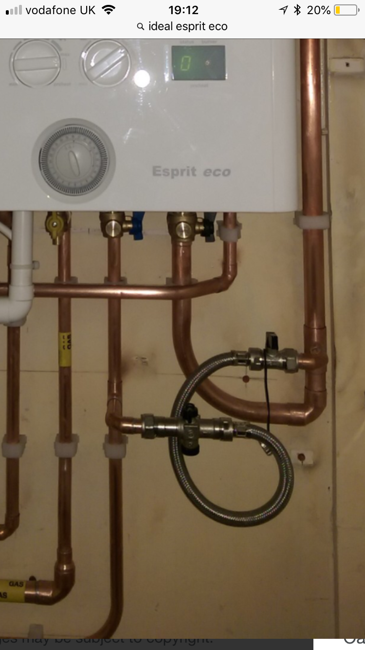

I’ve attached a pic as to how a good install would look - you see the flexible silver pipe...? That’s what you usually see. Follow the pipes down and have a looksee... (y)
Make sure the radiator trv and lockshield are closed... or youre gonna have gush.
