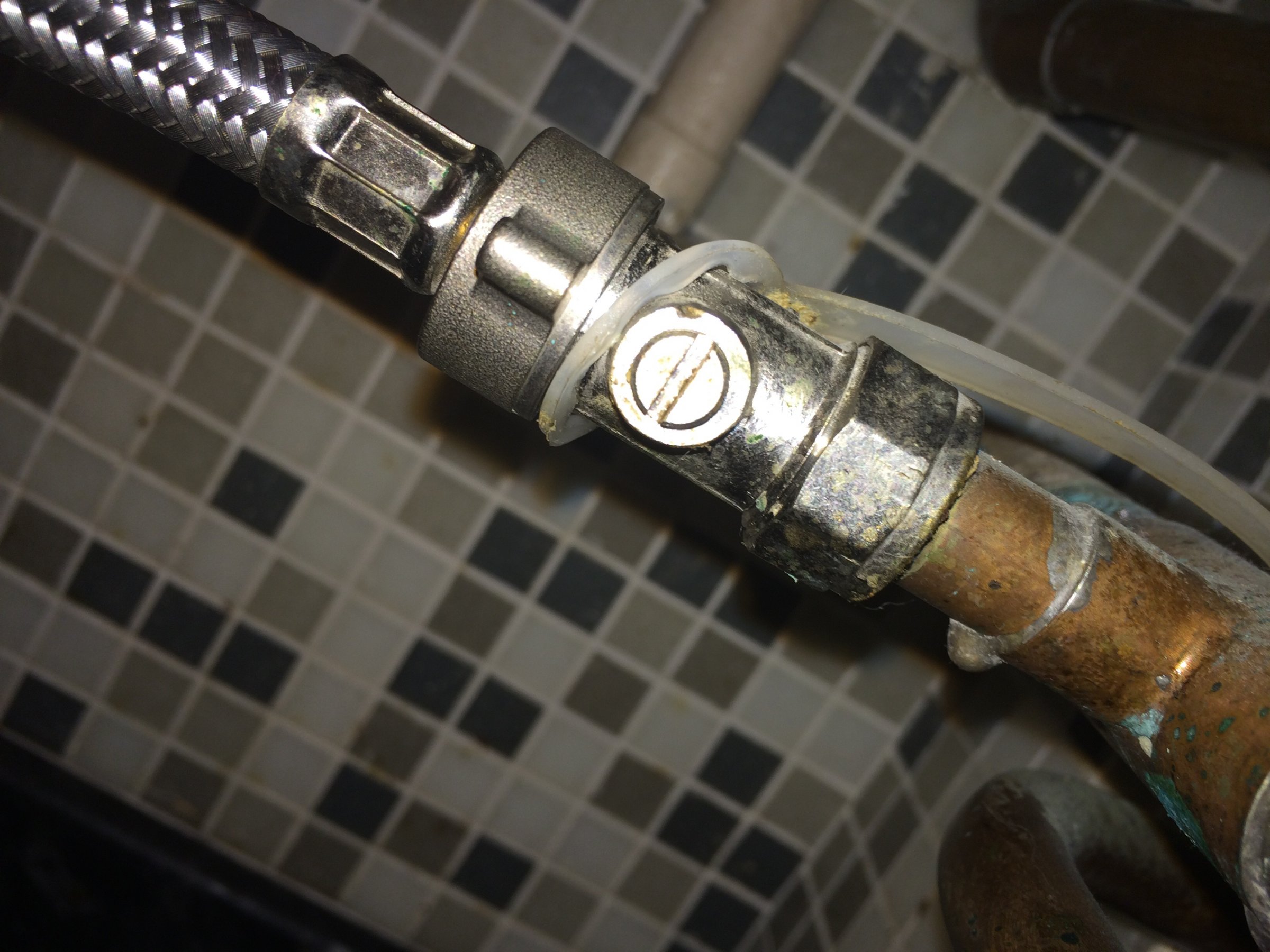

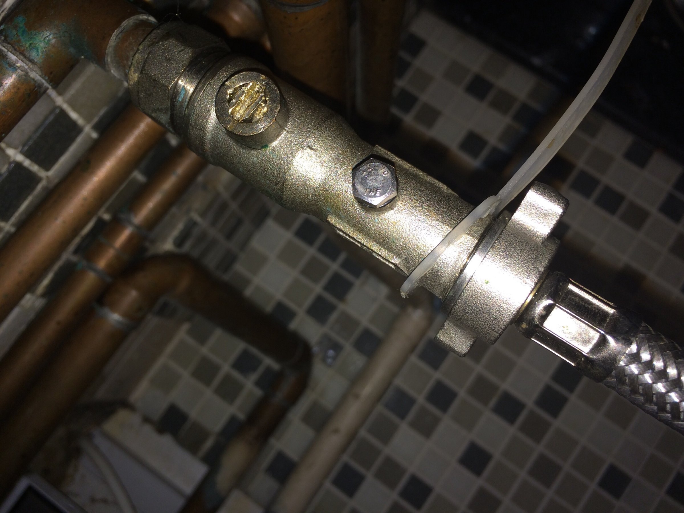

I have a boiler which the pressure has dropped to 4, it was 8 but I bled radiators and it dropped further.
I've googled and read about doing it via the loop - one end has a screw which when turned water comes out- it doesn't seem to be going through the other pipe - there isn't an islolation screen there is a little hole with a bit in it but it doesn't turn and
I thought so but the top pic one won't turn, I've tried wd40 on it as well. I think the screw is buggered
Best to replace it with a filling loop wth handle instead of screwdriver slots, have you tried a few different screwdrivers and not a butter knife?
A butter knife is the one thing I haven't tried, but yep different screw drivers. Thanks
