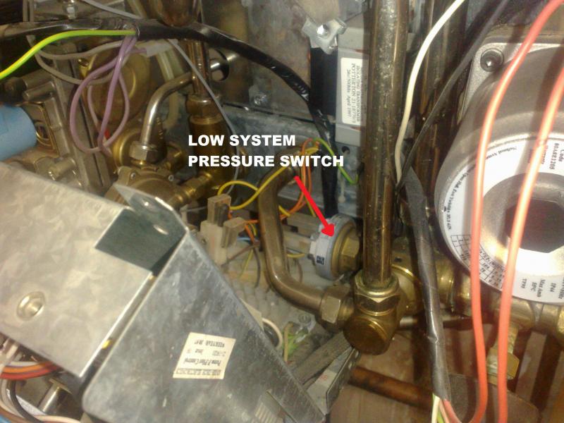

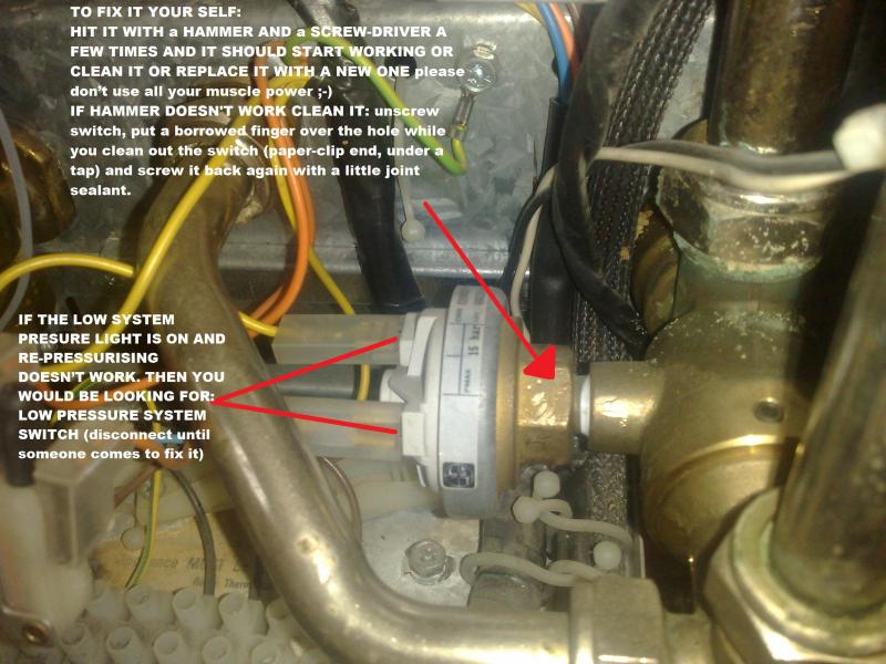

i had a problem like allot of other people and i couldn't find what to do and after i found out that i had to clean the system pressure switch i didn't find the switch so i am uploading some pictures to help people like me.
please see the pictures in my album for instructions, my album is at:
http://www.diynot.com/network/abdul111/albums/

Hi, I realise that this is an old thread but it has saved my life. I have a Potterton 80 still installed (really old house) and today the light was on and there was pressure.
I cleaned as instructed and the boiler kick started. I wanted to say thanks (assuming whoever posted this still reads) as the pictures and instructions literally saved us from the cold.

Do not hit it. Do not wash it out under a tap...you risk filling the switch with water on the contact side.
Clean the switch port gently with a 4mm screwdriver. Clean out the port in the diverter. Check the switch contacts are less than an ohm.
Went to same model on Monday. No CH, now sorted. Clearly not a boiler to tackle if fitted in a cabinet with poor clearances
The boiler now has the same problem and the same solution was applied. I don't think the author is an idiot since he was able to isolate the problem. However, of course hitting a part isn't the best of technical solutions.
