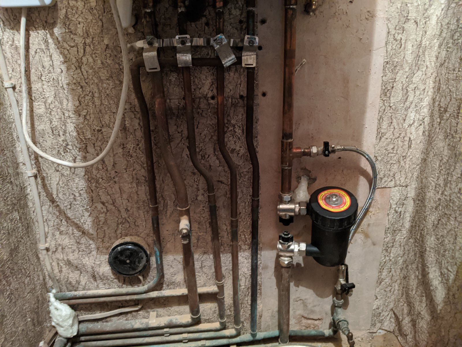

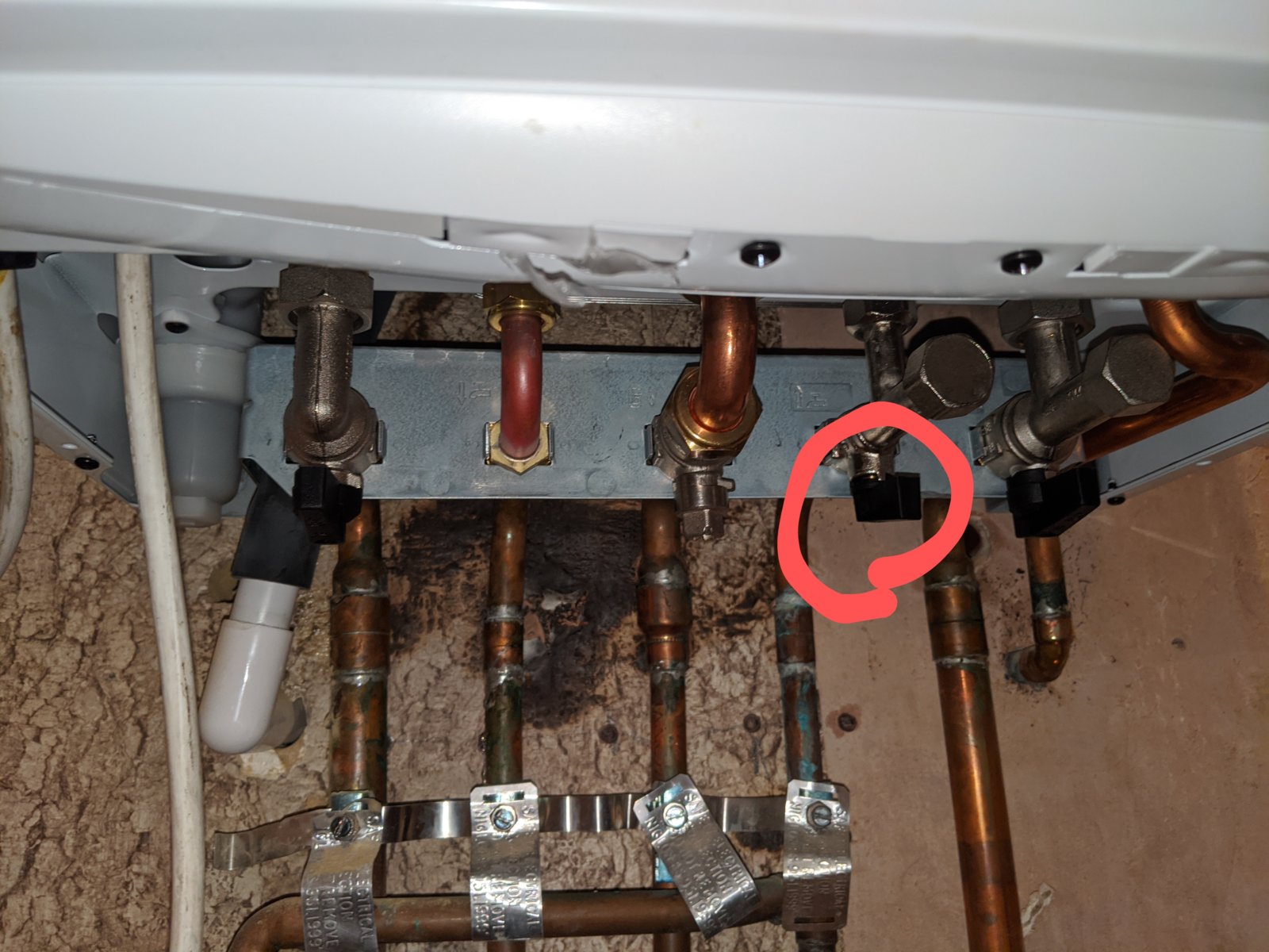

I have no idea what the engineer installed I have attached pics

Doesn’t appear that anything is wrong in those photos. Could do with knowing the model of glow worm, if you know it to compare.

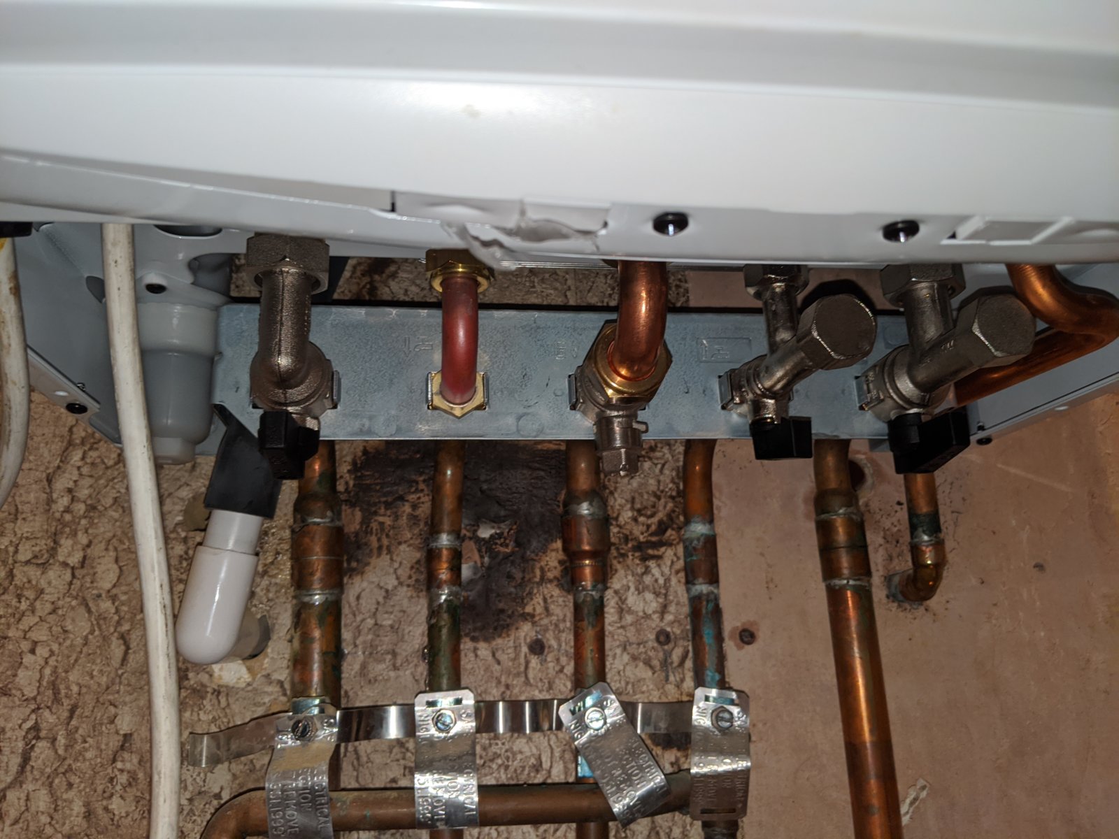

It’s not easy to see from the photo but it looks like the cold supply is not turned fully on , it’s the second valve from the right and the black knob should point towards you
Do you mean this valve
