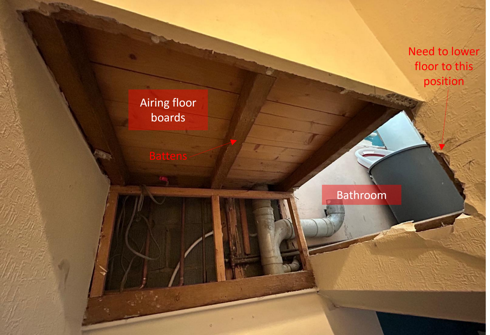

Hi,
We're converting our airing cupboard space into an enclosed shower. We currently have headroom inside it (floor board to ceiling) of 1900mm. We want to bring this up to 2000 or even 2100 if possible. We cannot move the ceiling upwards since joist in the loft run right above it. So we decided to lower the floor and sacrifice a bit of headroom. I have a few questions if the forum can be so kind to guide us :)
1. The lowered floor will break the 2m headroom rule for stairs below it. Maybe it will be 1.8m from pitch line (2m from the actual top of the tread). We think this would be still usable but would it get in the way or a house resale?
2. We are considering either (A) lowering the existing batten structure by 100-200mm, which we don't know if it will take the weight of a heavy person showering! ... or (B) removing it completely and using stick timber (220x45mm) as both the structure and the floor itself, using Sagulator online it seems it would take the weight and sag would be acceptable with nothing under it but it seems unusual! Any words of wisdom/warning for/against A or B?
I added a couple of pics to help visualise things. Any and all help appreciated -- thanks so much!

2m vertically from the edge of the tread is the regulation when installing a new staircase. I doubt a small deviation from this would be noticed.

Thanks very much! We did a simulation of the new level and felt it’s ok but good to know about the standard being from tread edge!
I hope you've actually tried attaching a bit of wood where the new ceiling will be and walking up and down naturally - not just carefully standing there. If you're under 6 foot tall then ask someone taller to try it.
I don't understand why you're bothering with seemingly designing it to sag?!
Do it properly, use floor joists and boards, using joist hangers and/or attaching securely to the surrounding structure. The existing frame wasn't designed for standing on. Flexing in a shower will mean a cracked tray and/or leaking edges.

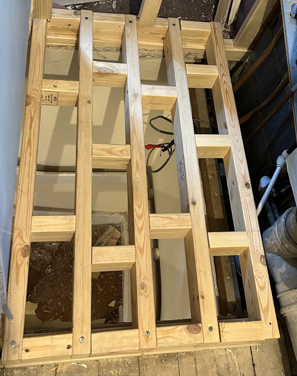

I did decide eventually to do a proper job with 2x4 (well 45x95 mm) C24 timber. I also raised it above the floor boards level with 2 pieces of CLS timber to give a little more headroom (nailed with 150mm nails). I’m 6ft and there’s enough clearance even going up/down energetically :D
The span is about 1000mm so I may have gone a little overboard with the number of pieces!! (see pic), but it feels quite sturdy though so I’m satisfied

Looks great, you need a shower tray to be super-rigid. Definitely good to over-do it, keep those edges and waste pipes sealed.
