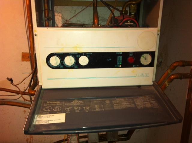

Hi,
I have a Luna 24fi boiler also known as a Baxi Luna 1.20
I've had a few different service people out to take a look at the boiler, but just like most other people who have problems with these boilers, the service people are only interested in pushing you towards getting a new system installed, they tell you you can't get parts but with a little research you can find almost all part, just not the mother board.
The problem:
A few weeks ago we noticed it was cold in the house and we had no hot water, so I went to have a look at the boiler and the top red neon light was illuminated. (manual says: blocked flue or fan fault)
Turning the boiler off for several minutes and turning it back normally make it work again.
However sometime 30 minutes or several hours later the red neon light will be back on again.
When the top red neon light gets triggered and is on, the fan get shut off, the flame gets shut off, but for some reason I can hear the water pump running and water circulating.
Also after restarting the boiler the flame/burner only appears to stay on for a few minutes max sometimes only 30 seconds, then the flame shuts off, but again I still hear the water pump running, then several minutes later the flame will reignite, this continues until at some point the red neon light appears.

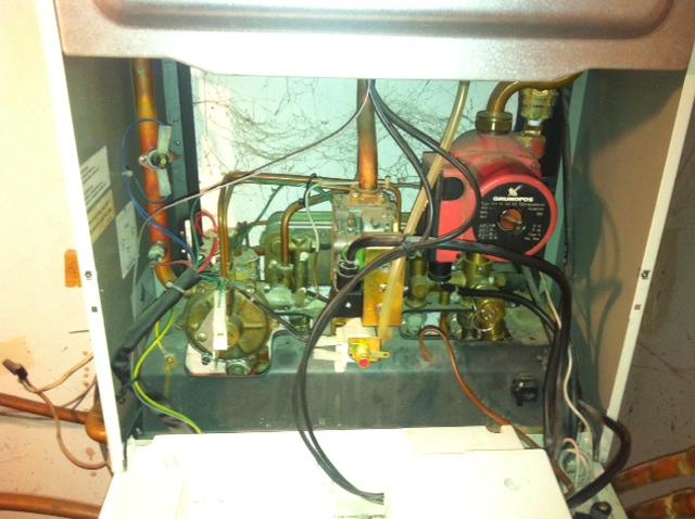

A friend with some experience with the same boiler recommended trying to replace the "Fan Pressure Switch". I changed it today but the problem still continues.
Can anyone offer any advise on pin pointing the problem?
Should the water pump continue to run when the burner goes off?
One last thing I wanted to mention, during the night and when the neon light is on, the noise inside the pipes isn't the same as in the past, it sounds like a tap is running and you can hear the water flowing and splashing. I know the water is flowing but I don't recall hearing it like that before.
Some other details, this boiler heats the hot water and also the baseboards around the house, if I set the boiler to only heat the water the burner generally stays on, but if I was to fill the bath the red neon light would come on before it was full.
Turning the water off at the tap stops the water pump from making the noise.
If the boiler is set to heat water and the baseboards and I then turn the thermostat up and then turn it right down to zero the water pump etc still keeps going without a burner running.
Craig

However I felt comfortable replacing the fan pressure switch and I'm also considering cleaning/replacing the Grundfos cartridge.
So you think the broken spire clips are causing the burner to shut down and because the thermostat is still telling to to heat up, that's why running water noise /pump running still occurs?

No, you always find broken spire clips on these models and need replacing since their failure can render the appliance unsafe but that's not the reason your boiler doesn't work.
Read the FAQs, I'm not going to tell you what the fault is (since it involves work in the combustion chamber) but it's a simple problem that doesn't normally require any additional parts. Any half decent boiler engineer can fix it.

So I've had the service person around this morning, after I told him about the water noise he said, the system and pipes defiantly have air inside and it needs bleeding.
But the way the systems are installed it's not possible to do this due to poor installation so I'm told.
The boiler does have the one value thing that you can open to add more pressure.
The service person tells me that the expansion tank that's at the back of the boiler needs to be replaced, but he recommends having an external expansion tank added and at the same time installing a few flushing valves.
Cost $500
Have to run out, just wanted to let you know what they said, I haven't made any commitment as of yet either.
Sounds like Canada has just as many useless gas engineers as the UK.
This boiler is very simple and straighforward to work on. One of the easiest in fact.
Did he check the vessel properly? See the FAQs section on re-charging the vessel. If it really has failed and additional vessel can be plumbed in. A typical 8 or 12 litre vessel here in the UK would be around £30 including fittings and a few hours labour tops. Probably need a new auto air vent at a fiver too. So 500 dollars is a rip-off.
Sometimes if there are no bleed points on the high points of pipework it can be difficult to remove the air but it generally clears eventually. Either way it's simple stuff for any pro to sort out.
