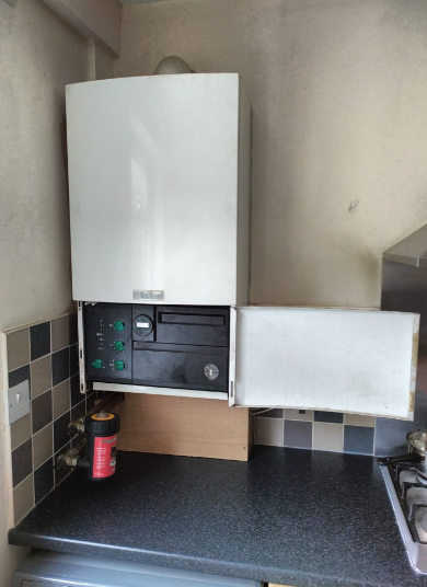

Introducing Bella the Boiler...
She is an aging Vailant Turbomax VUW 282 E
Been with her for the last 25 years (bless her). Occasional let down here and there, occasional leak but seems to be still chugging along.
Prop'ing her up with a British Gas insurance which costs £28 odd a month. They are telling me the gas value is now obsolete and other parts are going obsolete over time which means they can't fix her if a critical part goes obsolete.
When BG engineers do work they say that there is sludge water inside the boiler, but the overall water in the system seems cleaner and the magaclean is not picking up too much sludge (the magaclean is unfortunately on the flow rather then return).
Just wondering if there are some options to keep her going a bit longer without her 'conking out on a winters day and becoming unfixable?
Queries...
1 Is there a an inlet or outlet I could connect a hose to and flush the boiler only with mains pressure? Beneficial? Or would this have to be done professionally (not cheap and would they screw something up)?
2. Are there chemical desludging options for the boiler that would work and I assume require inhibitors after?
3. Is it game over for Bella, a new 30KW condensing boiler would be a better investment? Vaillant or Worcestershire Bosch seem to be the options and would either of them offer warranty and engineer support in a day or two of anything went wrong as some older vulnerable people in the house.

Ta for reply. When the British Gas engineers replace parts they see the water internally (recent divertor valve leak).
If you want to name-drop your supplier or somewhere I can get parts from - welcome too.
Sounds as though there isn't any service connections on the boiler a DIY'er can plug hose pipes onto to flush the boiler only? - I think mains pressure is 1 bar and it would take more than that to do a worthwhile boiler flush? Thus the only way for non-professionals is - chemicals cleaners, drain out then inhibitor put in - via the magaclean filter?
You say the system water is relatively clean so that's good. I would always expect to see some build up in a 25year old boilers internals but that isn't sludged up, the water inside the boiler will be exactly the same as the system water, as it is exactly the same thing, sounds like they may be setting you up for a new boiler punt at some point. Sludged up is something completely different and can put paid to a boiler in no time.
A good quality cleaner dosed into the system and left running around it for a few week will sort out a lot of that build up, then it's just a case of a gravity empty, fill, run, empty, fill, run and do that a few time to flush out the cleaner until it all runs clean. Then inhibit it well.
Powerflushing is really only a thing that allows professionals to clean out really sludged up system and rads in a couple of days, not needed for yours if everything is relatively clean and the rads don't have cold spots etc. Oh and other companies to scares people with and then charge them a fortune for something that wasn't really needed.

You currently have a 34Kw (for HW) @ 11.5L/Min @35deg rise, so a more modern 30Kw combi should have comparable HW output
Warranty: Am hoping that manufacturer warranty will mean someone would come around within a 1-2 days if it went down for any reason within the 1-5 years warranty period (WB or Valiant the same with sending engineers)?
Again, all really comes down to location and what the manufacturer has in available resource, warranty calls are usually within a day or 2.
Installation: There are like-for-like boiler bashers like BOXT that could be an option for install? - but if there's sludge in the old radiators, am worried about it making its way into the exchanges of a shiny new boiler - would I need to budget for a 12-radiator power flush or replacing rads? (OMG British Gas charge a fortune for power flushing a system).
You can use whoever you like but rarely will you get the same service from a volume installer as against a local independent. You would probably get better support from an experienced and recommended local independent
Budget: Money wise there is probs a calculation to do considering what can be saved in bills per month with a new 90% efficient condensing boiler? And also instead of spending £28pm on old boiler insurance, putting that on financing a new one (as long as the manufacturer warranty is nearly as good as British Gas Emergency boiler insurance)? Also the house EPC might look a bit better? - but not sure if that translate into anything £materially.
Swapping an old boiler for a new one doesn't really come down to money saving as far as boiler efficiency savings are concerned. It's all really about new boiler, new bits, new warranty, piece of mind etc. Yes of course it can lead to lower gas bills but balancing that against the outlay of the new boiler those costs would take a loooong time to recoup.
