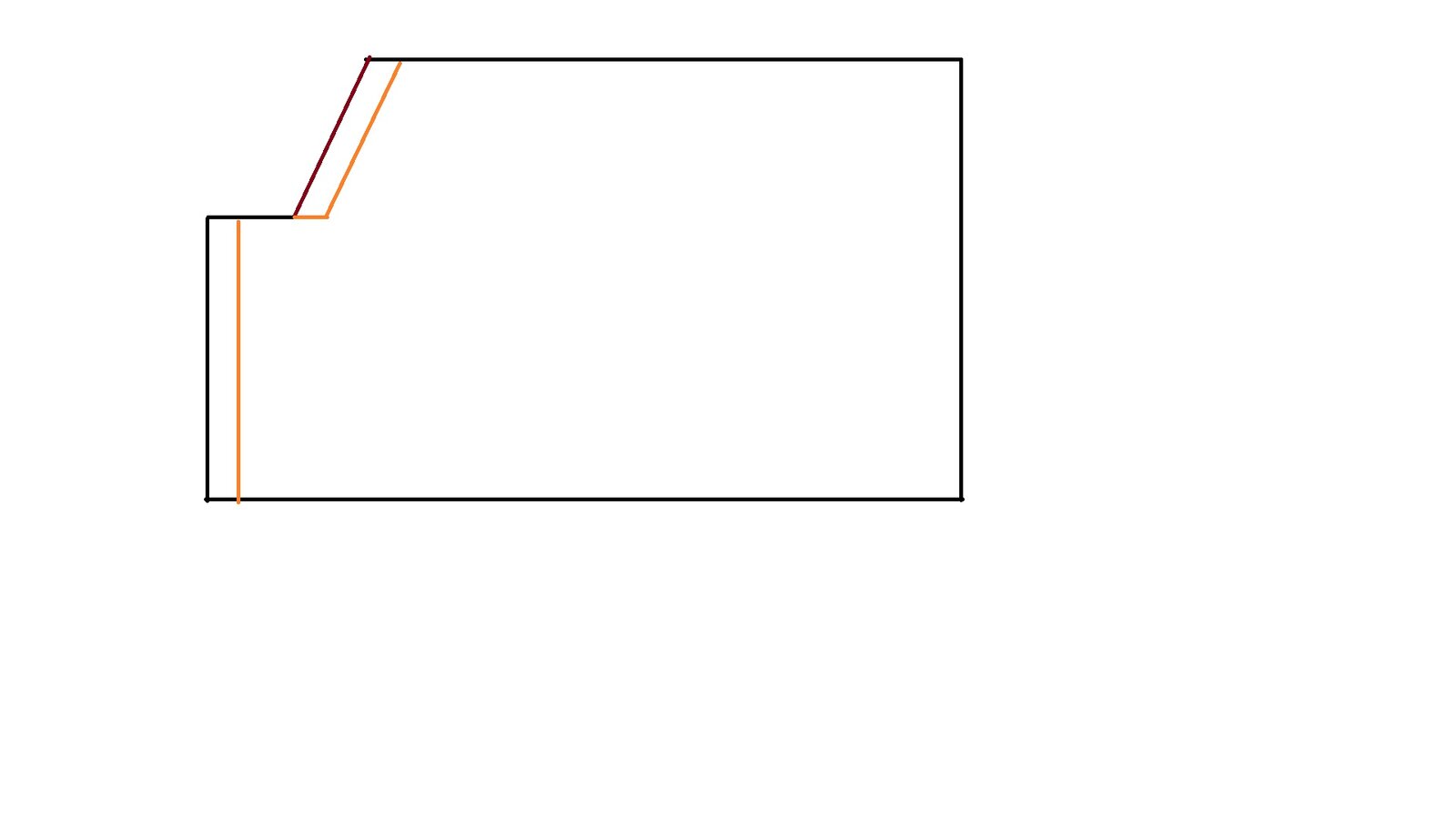

Whilst working a friend's today. I needed to shorten a 42mm Iroko worktop that I had previously left loose. I had to remove 18mm from the edge where it meets the old worktop. It was a pretty straight forward profile.
The red lines are the new cuts. I used my festool plunge saw to remove as much as possible and then decided, given that my Festool jigsaw was elsewhere, to use the customer's Mac Alister jigsaw. His (supplied and used blade) would not cut through the wood, so I put a Festool Carvex blade in to it. Even with a decent blade it struggled. I haven't used a cheap jigsaw for years, I had forgotten how awful they can be. I ended up using a chisel to clean the internals of the corner. I have never needed to do that with a decent jigsaw.
The whole experience was horrible. I am sure that I could feel the base flex as I used it. I normally only hold down jigsaw with one hand, on this occasion, I used two.

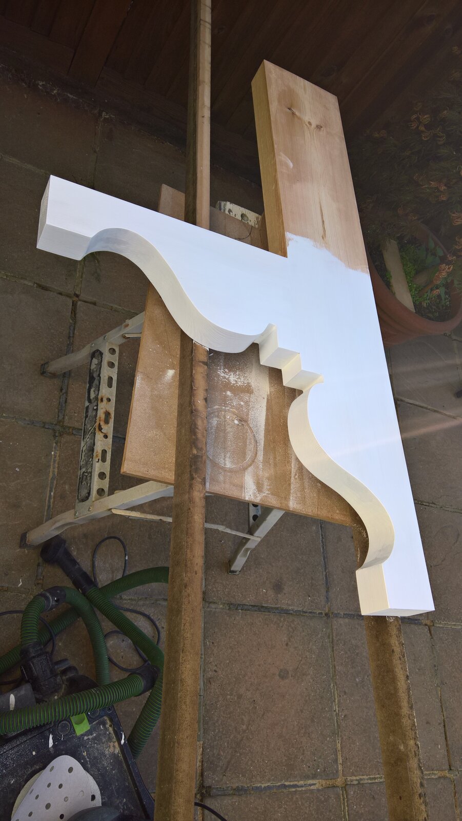

I had to remake a porch support for a friend. His house had a shared porch cover with the total of 3 supports (on at the party wall). He had a brick/uPVC enclosed porch fitted. The fitters removed the party wall support. His neighbour, understandably got annoyed and demanded that (her half of it be reinstated. With hindsight, the timber that I was working with was probably closer to 60mm and not 85mm- it was about two thirds of the original. This was back in 2016, so my memory is a little patchy.
At the time, I didn't have access to a bandsaw, so I used my jigsaw and lots of sander paper. It took way longer than it should have but the "demanding" neighbour was happy.
The Carvex blades that I used are thicker than standard and I had to increase the width of the supporting shoes on the jigsaw with an Allen key. You can't do that with a cheap machine.
Admittedly, it was the wrong tool to use but it did the job and the cuts were pretty square.
