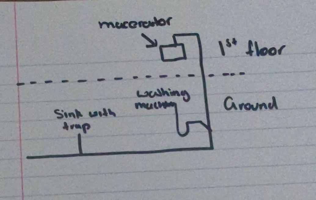

When the macerator flushes it causes the water in the traps for the sink and washing machine to spyhon out. I was think of installing something like a anti-syphon p trap for the washing machine and sink. The macerator which I have on the 1st floor.
I saw mentions of an AAV, but not sure if I could use this instead of the anti-spyhon p traps
The pipe running from the macerator down to ground floor is a 36mm. There is a sink that has a 36mm running to the inlet of the macerator. This doesn't go into a soil stack. Seems a 36mm pipe has been extended from ground to first floor where the macerator discharge is connected to

The macerator should never have been joined to the other grey water waste system like it has. High risk of pumped toilet waste backing up into the washing machine and sink. As it's a pumped system for toilet waste you really want it separated. Is it a basin (not sink), that's in the same location (bathroom?) as the macerator that's connected to it?
Not what you want to hear I'm sure, but it really should be set out on it's own run to the soil stack and then onwards to the combined drain/sewer.
Sink and washing machine waste run is 40mm? Not 36mm (32mm)?
As above, Macerator must have a dedicated outlet run, complying with Manufacturers instructions, directly to a soil pipe or drain.
It cannot have any other appliances connected to the pumped run, you are very lucky not to have received a fountain of minced waste from the sink or washing machine drain!

Yes, there is a basin connected to the macerator inlet. The sink in the image for ground floor is actually a basin.
