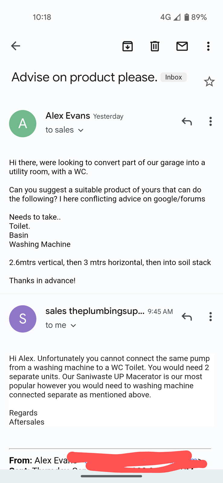

Weve moved into a new house last week and on the list of things to do are turn half the garage into a utility area and also, a WC
AS you can imagine we needed washing machine set up fairly soon. So ive done that, i took the water in from the sink in the bathroom (straight upstairs) to feed washing machine and the waste is in 40mm pipe, going through the dining room, to outside, then under the patio doors over to the drain. Happy days, we can wash clothes.
This was just to get it all working, at least temporary. As we do plan on 2 things in the fairly near future. 1) a conservatory, out from that dining room i mentioned earlyer. But 2) a downstairs toilet, next to the utility area.
The soil pipe is too far to travel in "normal" pipe with a downwards. So a macerator is the obvious choice. Up, into the bathroom, chase around and behind the bath pannel, into the soil stack there.
Question: can i have the washing machine waste get pumped too? And so.. the 40mm pipe from earlyer that i fitted can be took out and the conservatory get fitted. Happily.
So, can a macerator take 3 inlets?
Washing machine
Toilet
Basin sink.
Thanks guys
