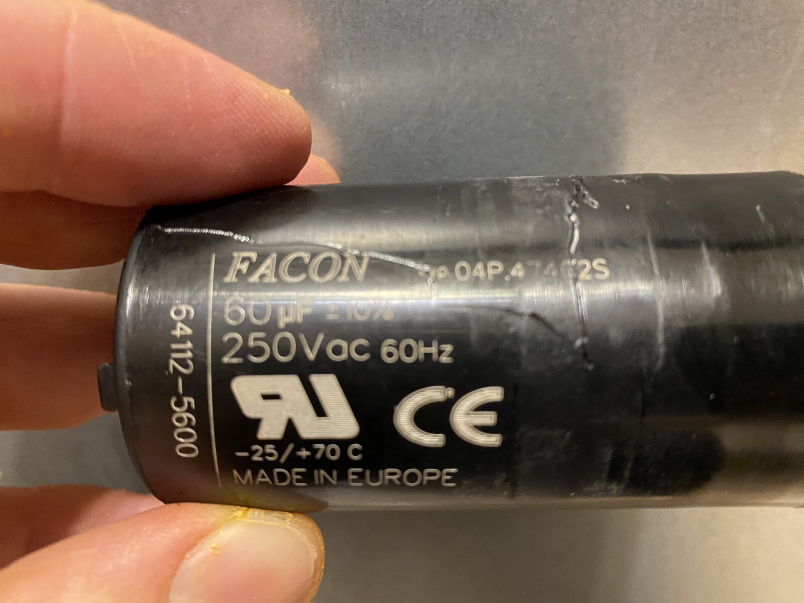

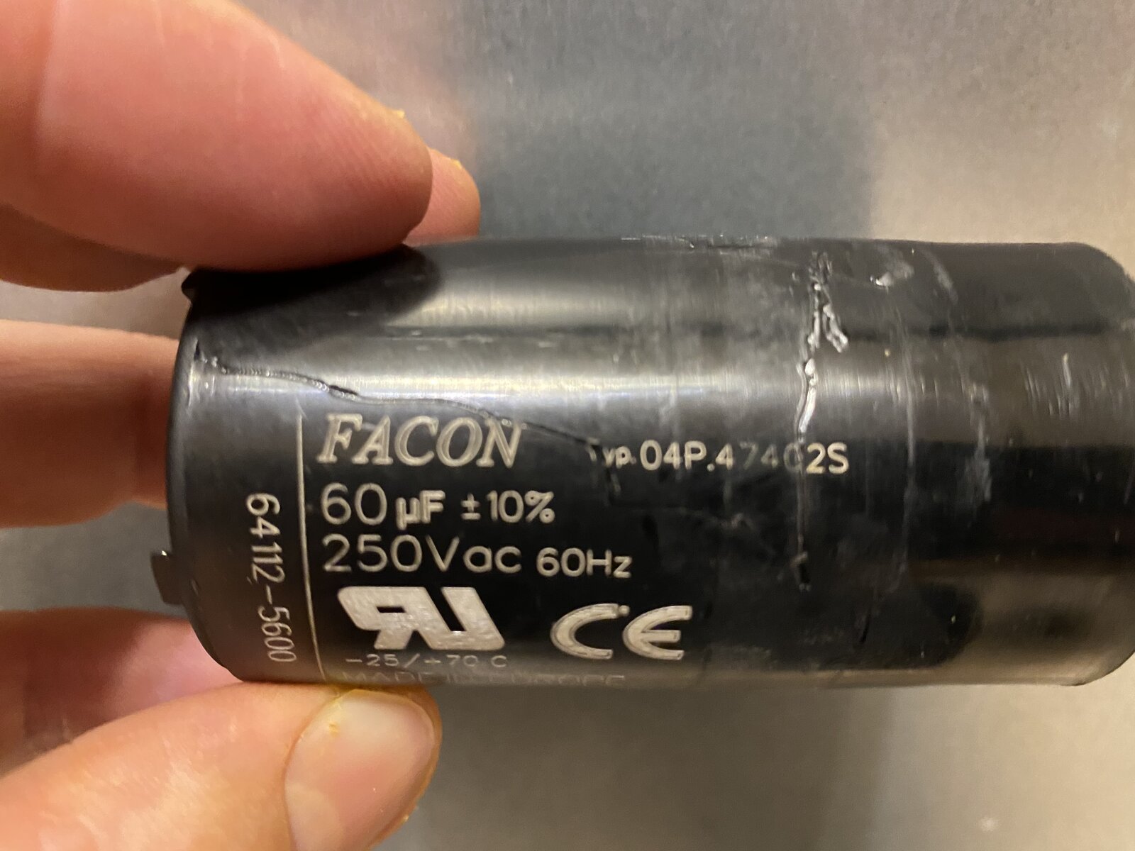

My OH has managed to knacker her Magimix 5200XL whilst kneading some dough. It got ridiculously hot and started smoking!
Now the blades are spinning very slowly and cutting through a thick carrot stops it spinning completely. And after only maybe 30 seconds of spinning, it's cutting out presumably through overheating.
Before I let her loose with the credit card, are there any obvious things I can check/replace that won't be a real false economy? From google the best I can come up with is the capacitor! Can I test whether it's working properly before buying a replacement? I've removed it and attached pictures if that's any help?
Thanks very much
I'm no expert but would try changing the capacitor, they are cheaper than a new mixer and exact replacements can be sourced through ebay etc.
Look at a few youtube videos to understand the way they work, how to safely discharge them given the very high voltages they store.
I got another 5 years out of a Karcher pressure washer by changing the capacitor for £14.
Blup
Spooky that the European made component fails just after Brexit! Hope my Seat Ateca keeps going :rolleyes:
New capacitor delivered and fitted and working as good as new. Best part of £300 saved (y)
