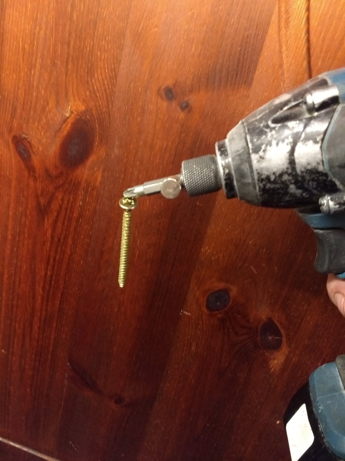

I'm putting together some ikea furniture - lots of them!
I need magnet screw bits.
What should I buy?
None of the bits I have are magnetic.
I can't find any that are magnetic (maybe I haven't searched enough)
Is it that the screw bit holder is magnetic and not the bit itself?
As for screw bits... Should I buy rolson 1000 screw bits for £1.99 (OK... It's not 1000, but a large number anyway)
Or should I buy 10 dewalt bits for £10?
Just making those numbers up. It's something like that anyway.
Thanks.
Yes, it is the holder that is the magnet.
Or you can get holders which actually hold the bit (bigger of course).
don't they all hold bits though? what does the bulging sleeve give you that something like this doesnt give:
That one in the picture is just a magnet.
The bulging ones physically hold the bits and you slide the bulging bit down to release the bit - like hoses fit to outside taps.
  • Thanks
Reactions: OM2
I just find it as easy to buy cheap neodymium magnets and stick them to the side of your bit holder or bit. Does the same thing.

only ever use a pz bit on a pz screw and a ph on a ph screw
basically the correct bit will hold the screw at least horizontally and even hang vertically if a perfect fit
